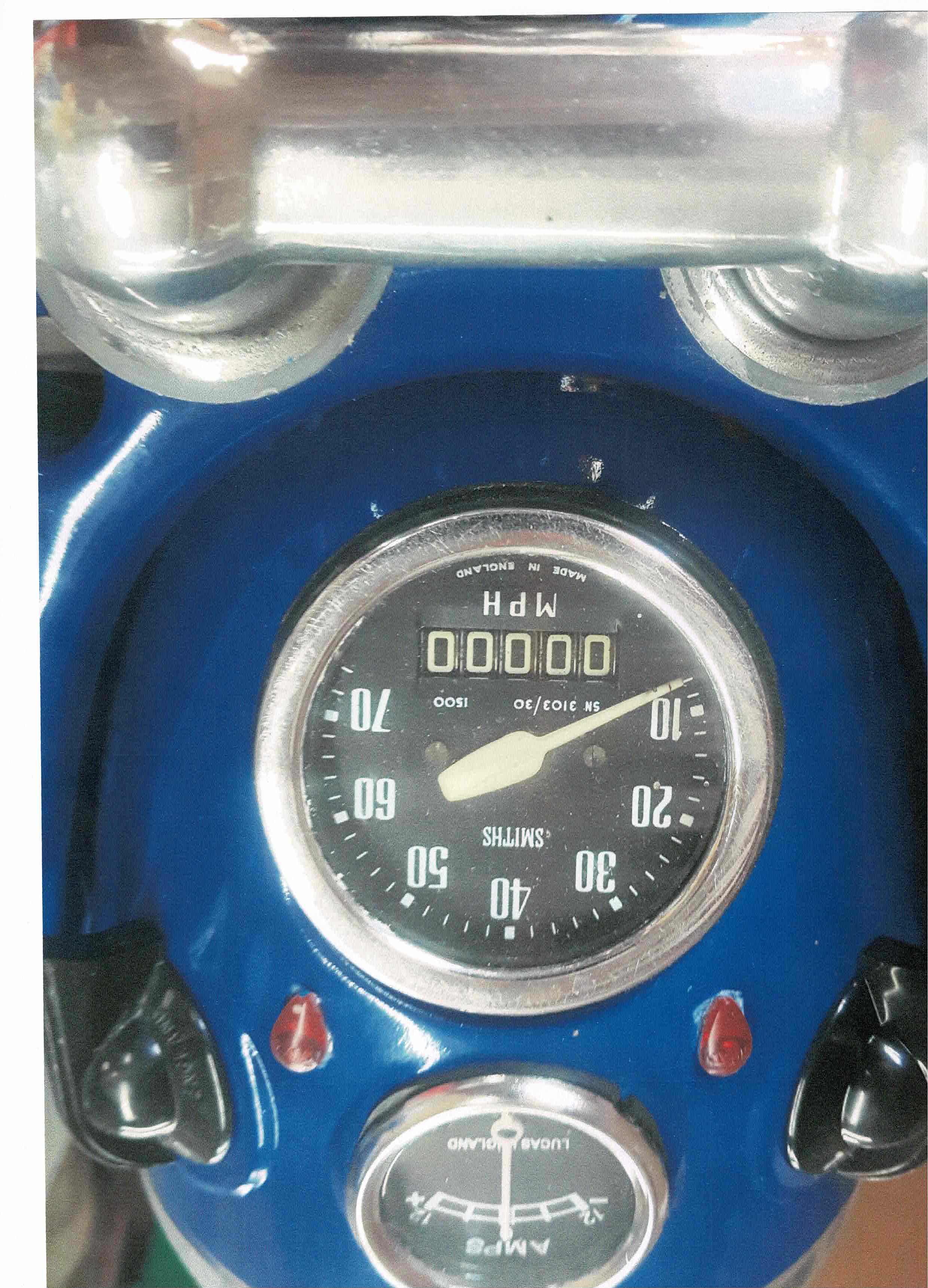

As you can see from John Dunns marvellous photo, these 'pips' were used on 1959 Jubilees, with the smaller headlight. They were discontinued in 1960 with the advent of the larger headlight and wiring changes, where the speedo bulb (that was used to illuminate them) was moved from coming on with the ignition switch - to coming on with the tail light (ie - when the lights were on).
However, AMC did make a larger headlamp with the pips. I wonder if that was used on Matchless/AJS models at the time?

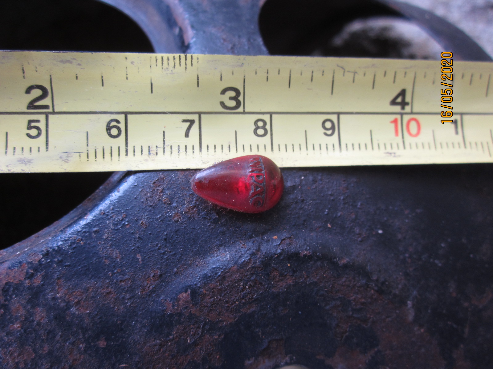

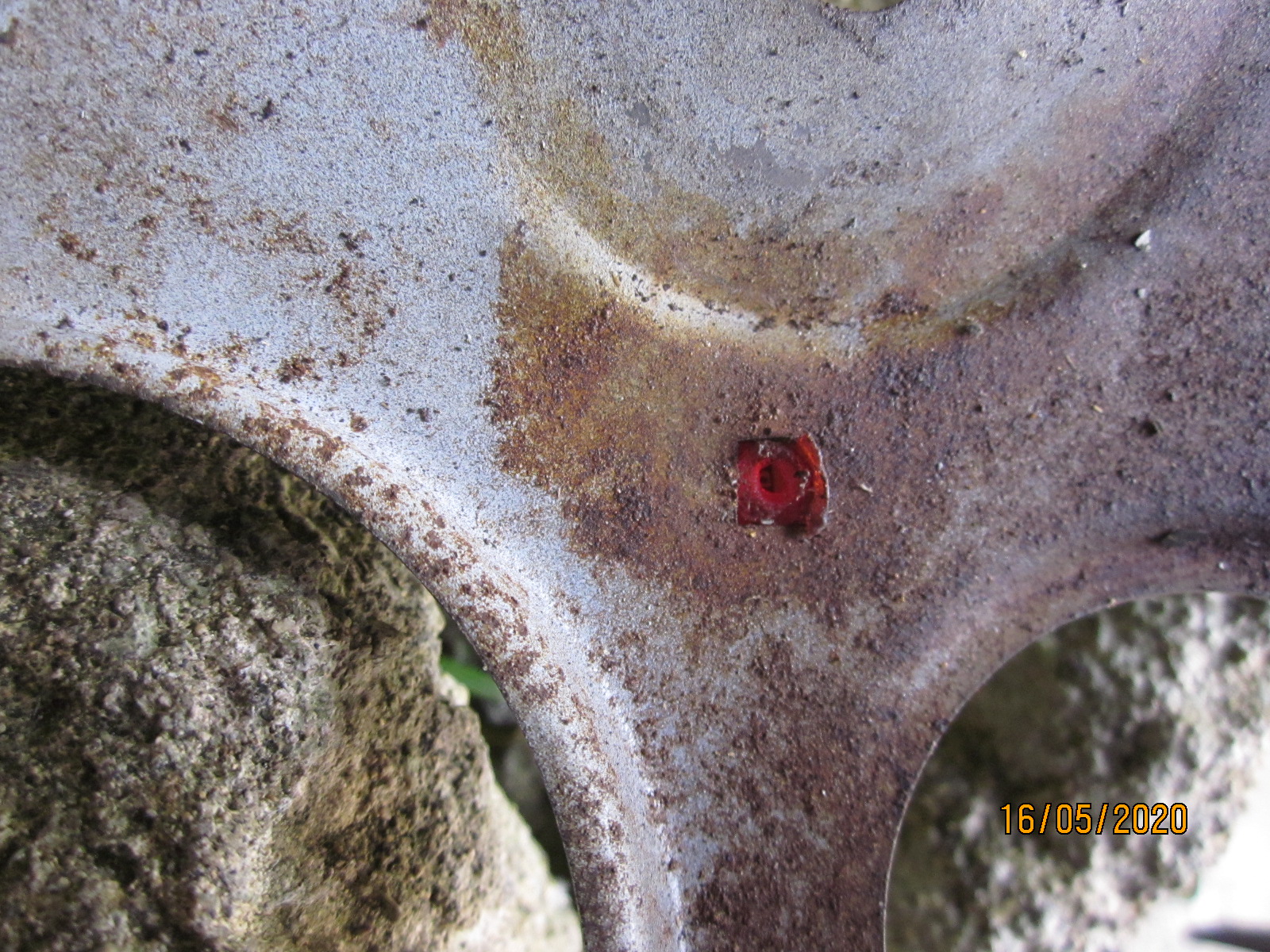

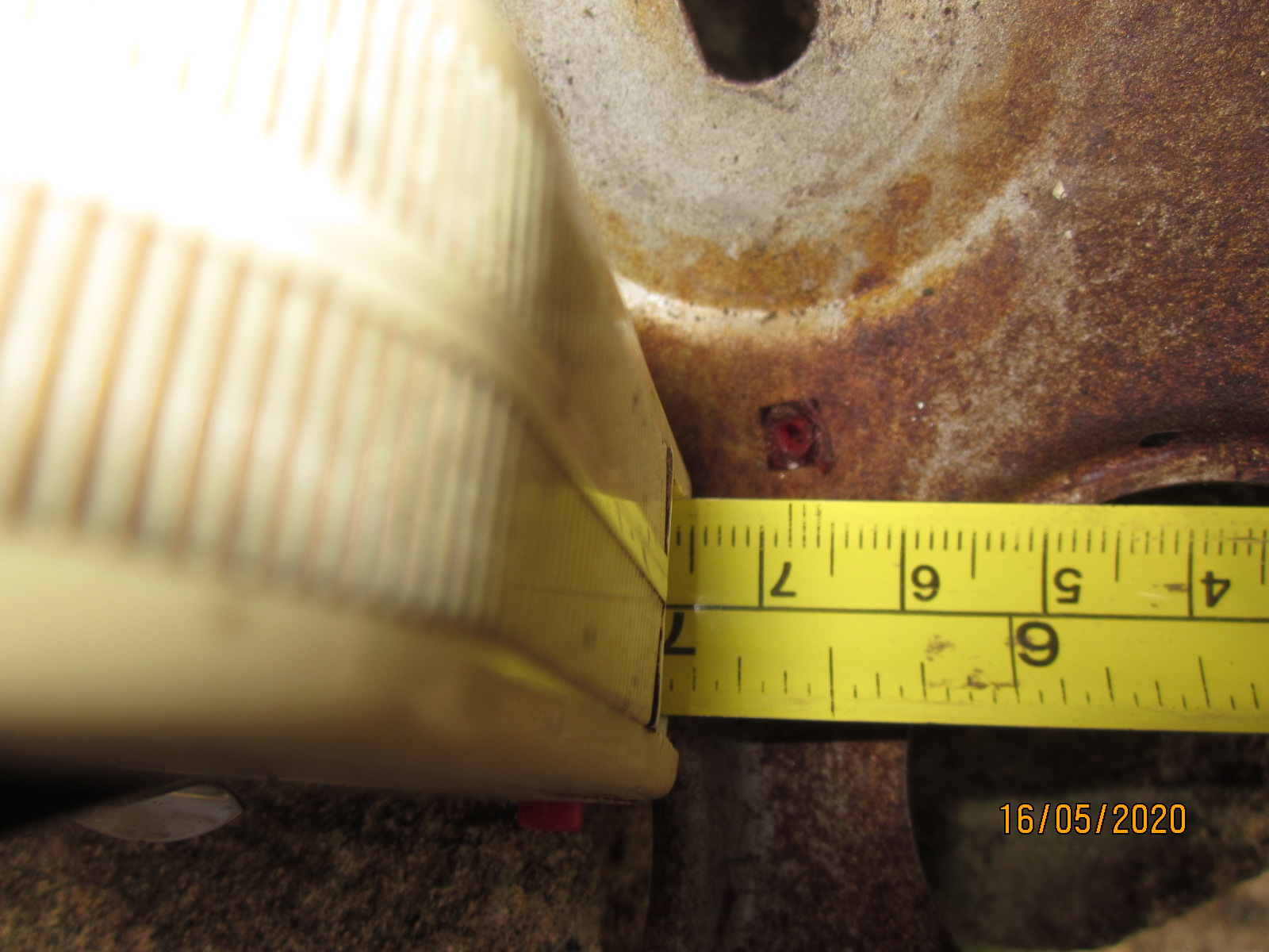

Having said all the above - here are a few photos from a rusty (larger) shell I have.
I show the top & the bottom (in situ). The bottom part in the photo is broken, in the sense that to site it (at the factory) the tail was pushed through a square locating hole (about 3/16") and then 'riveted' in place by melting the plastic (?with a soldering iron?). On my photo, that melted plastic has long since broken off.
The photo does not show it too clearly - but the raised 'Wipac' logo resembles the above.
