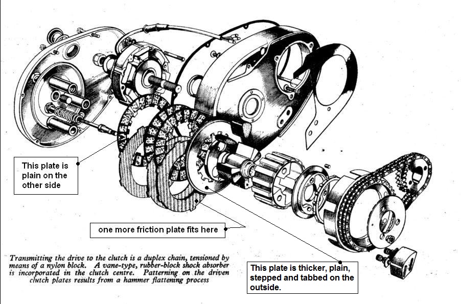

Sadly, none of the books or manuals show a picture of the clutch that is correct, however the Parts List is correct. The only picture shown - even in later manuals - is of the 1959 clutch that had a shouldered clutch centre.
For all clutches (1960-on) without the shouldered centre, there are 8 plates in the clutch basket.

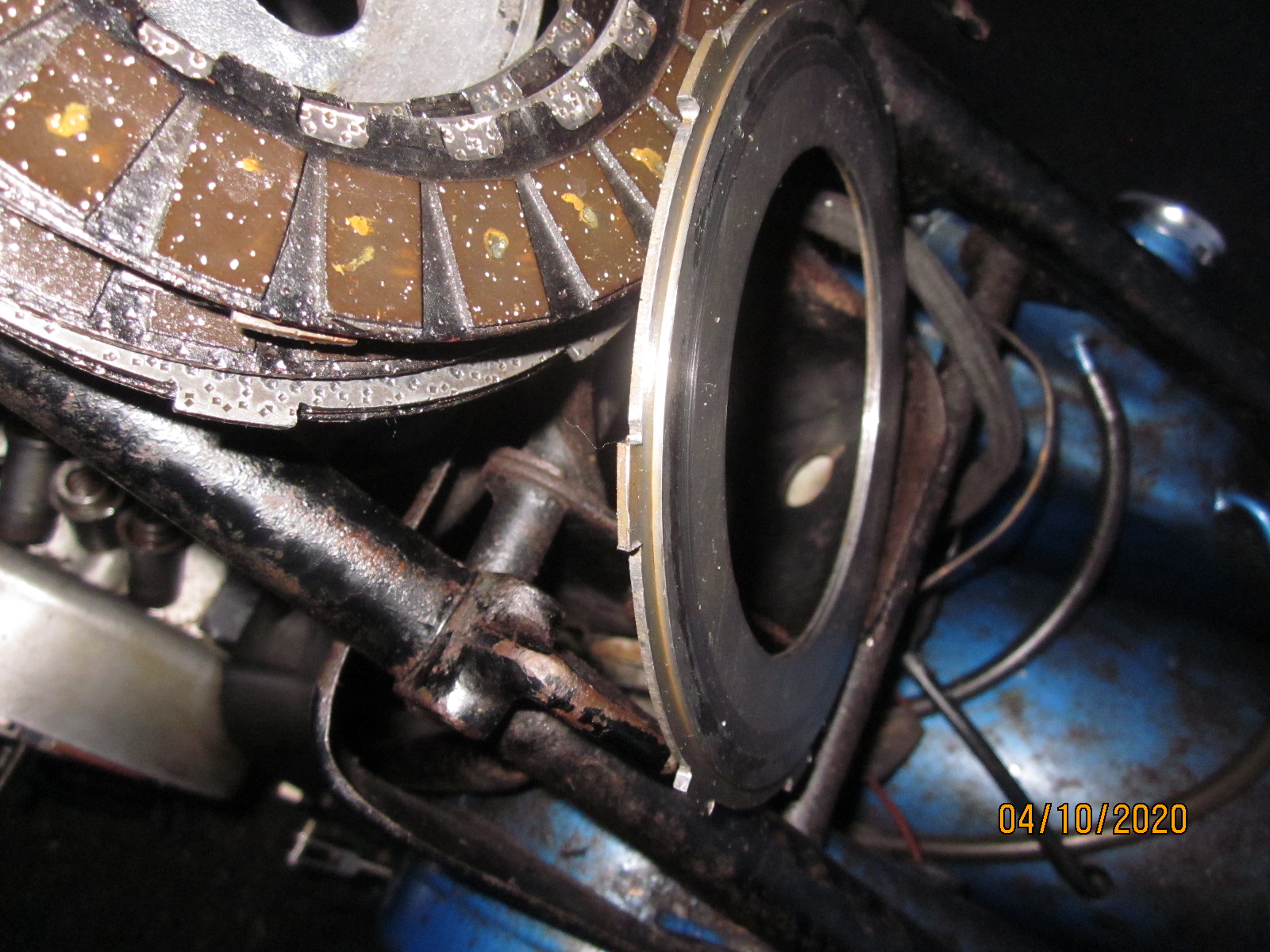

The first one in is plain, thicker & shouldered (to allow for the curvature at the bottom of the basket). This one tends to take the brunt of any wear, and usually the tabs are damaged/non-existent. It needs to be in good condition, sadly new ones are hard to come by.
The next six plates are fiction/plain alternating, endind on a plain plate. (These 'plain' plates are dimpled).
The last plate in has friction "postage stamps" on one side only, fitted plain side outwards.
Eight in total.
**There is an additional friction plate on the other side of the sprocket, for those that have adventurous enough to dismantle the clutch completly.
***Attached is a sideways on picture of the stepped plate
****Attached also is my best picture of the clutch, lifted from an article in 'Motor Cylcling' many years ago - but still shows an incorrect number of plates, and shows the (incorrect) first plate from the 1959 clutch.
