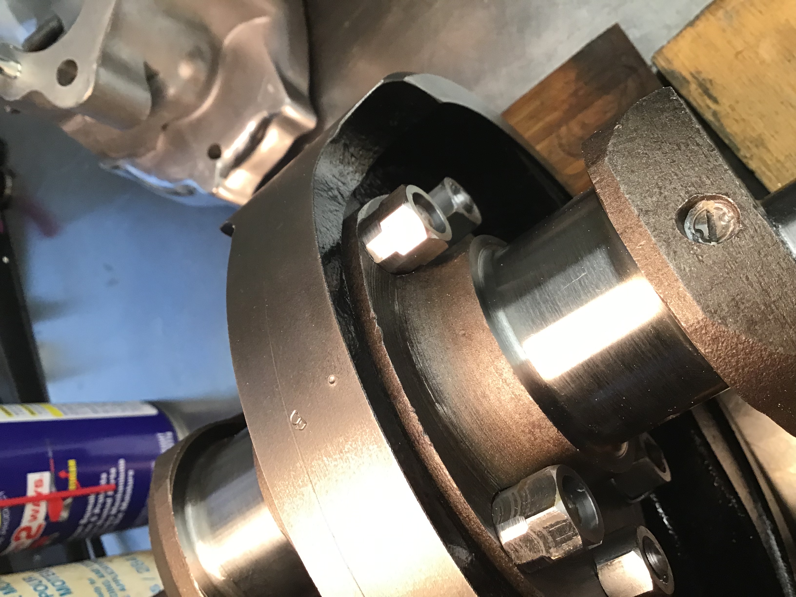

Hi,
I know to centre punch the small nuts but at the moment I am baffled as to how to handle the 2 large nuts at the top, the reason being is that they have an unthreaded bit that I wont be able to centre punch, so would some kind person please educate me how to proceed.
Many thanks jim

Thank you Anna,
I am grateful for your advice, but my problem is the 2 large nuts that are not threaded entirely through and the bolt only comes to the end of threaded bit , creating like a well, I cannot see how I centre punch (belt & braces) perhaps like Roy Bacon says for pessimists, and not do it ?
Cheers jim

Bacon also says that pessimists can also use Loctite and centre pop to make sure.                        This being my problem ! its an easy job to centre punch the small nuts but the larger ones on top have like a well where the nut is not threaded and the bolt only comes up to the threaded bit, I cant see how I can centre punch it, that's the bit I need help on. Maybe I should not be a pessimist as Bacon says and not bother to do anything but torque to required sum ?

Hi Robert - If this is the condition you describe - the top two studs don’t extend to the outer face of the nuts and by “ center punching“ you mean deforming stud/nut interface to keep nuts from backing off   ( this was called “staking “ when I was schooled- not trying to be pedantic here - just making certain we are talking about the same thing) you have two options . Stake the interface between the base of the nut and the crank flange on the outside ( not recommended) or grind a punch to reach down the inside of the nut to get to the thread interface. By all means use threadlocker also if you are concerned.
 David - I believe the tabs are only used at the bottom studs for two reasons- these nuts are more difficult to torque properly because the crank web interferes with the torque wrench and also the tabs span the ends of the dowel pins to keep them from coming adrift.
 Indeed two of the bolts are close tolerance to aid in locating in addition to the dowel pin.
