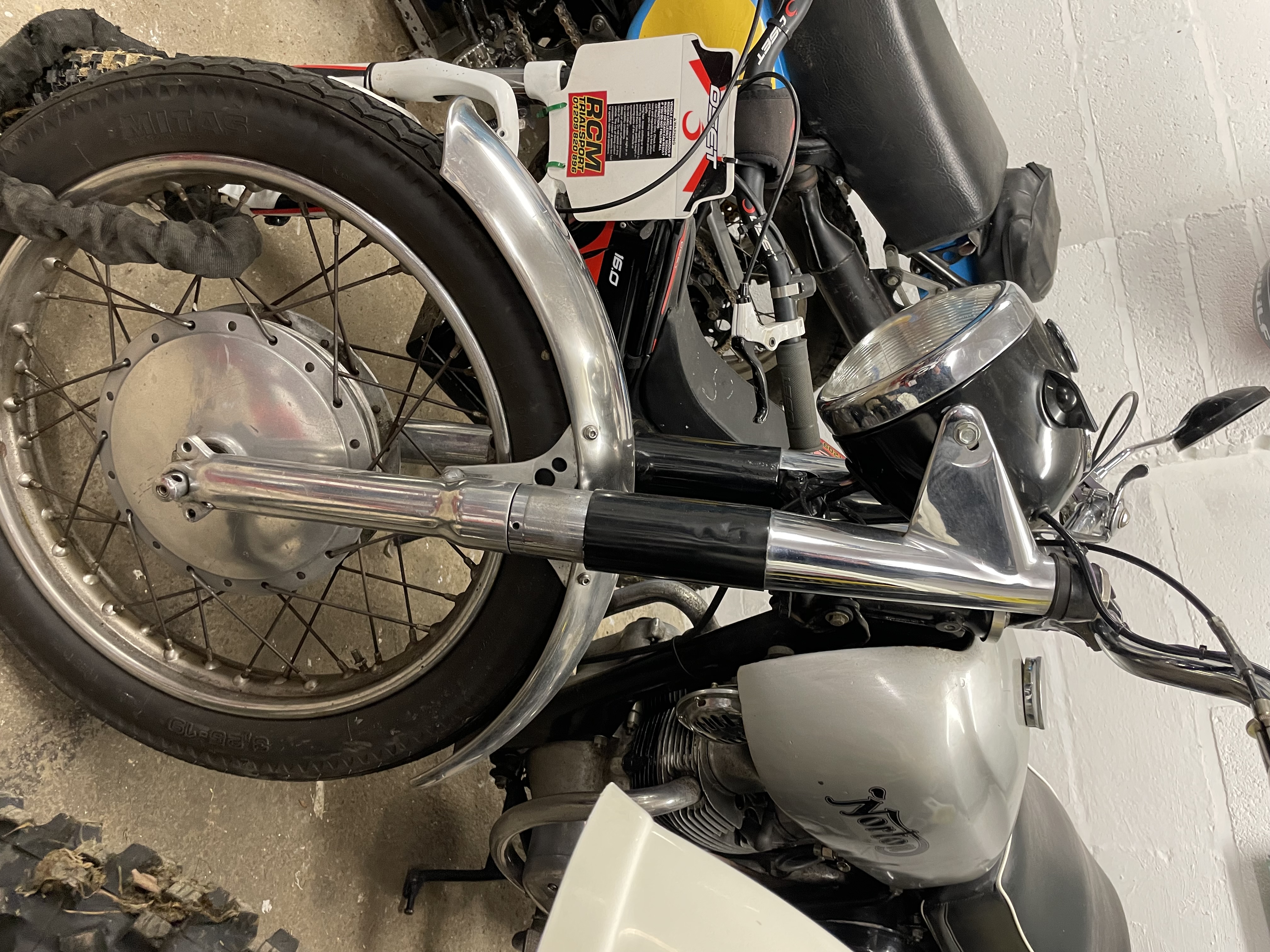

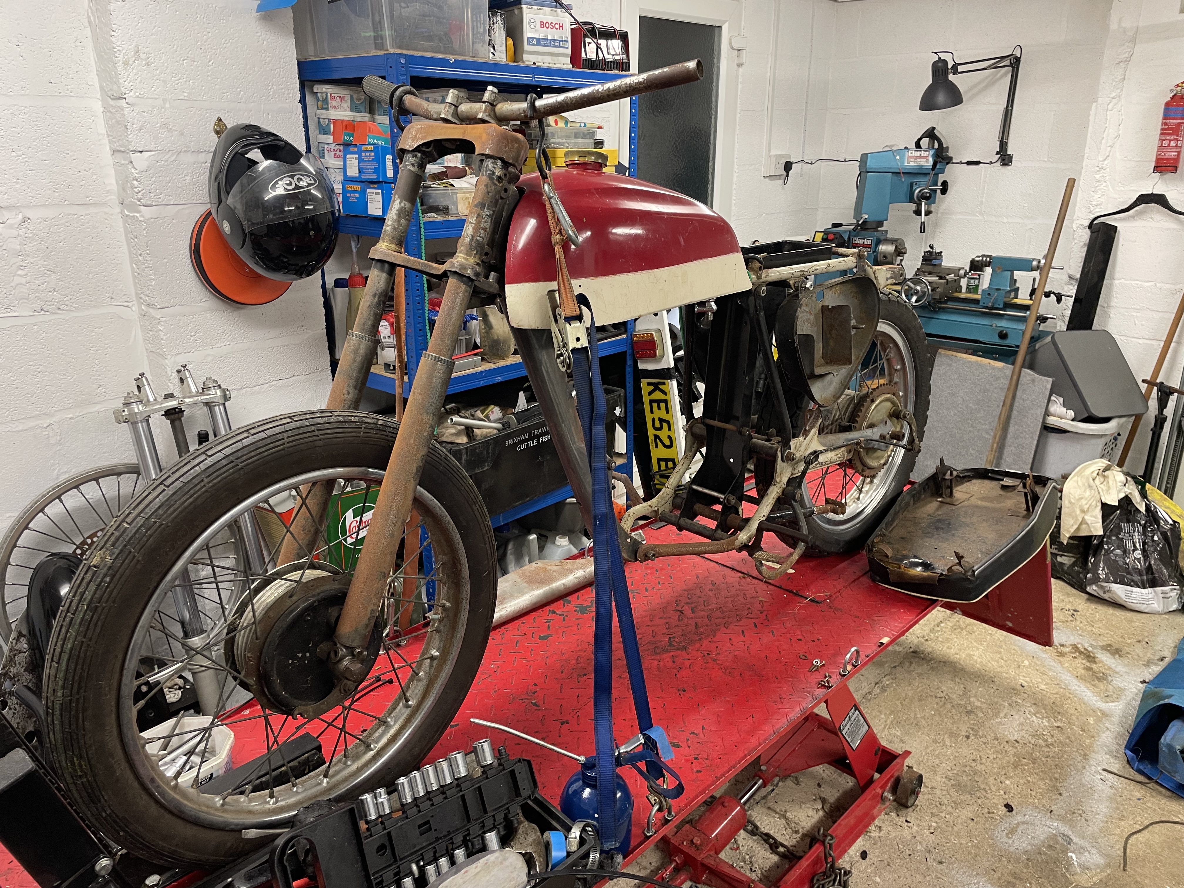

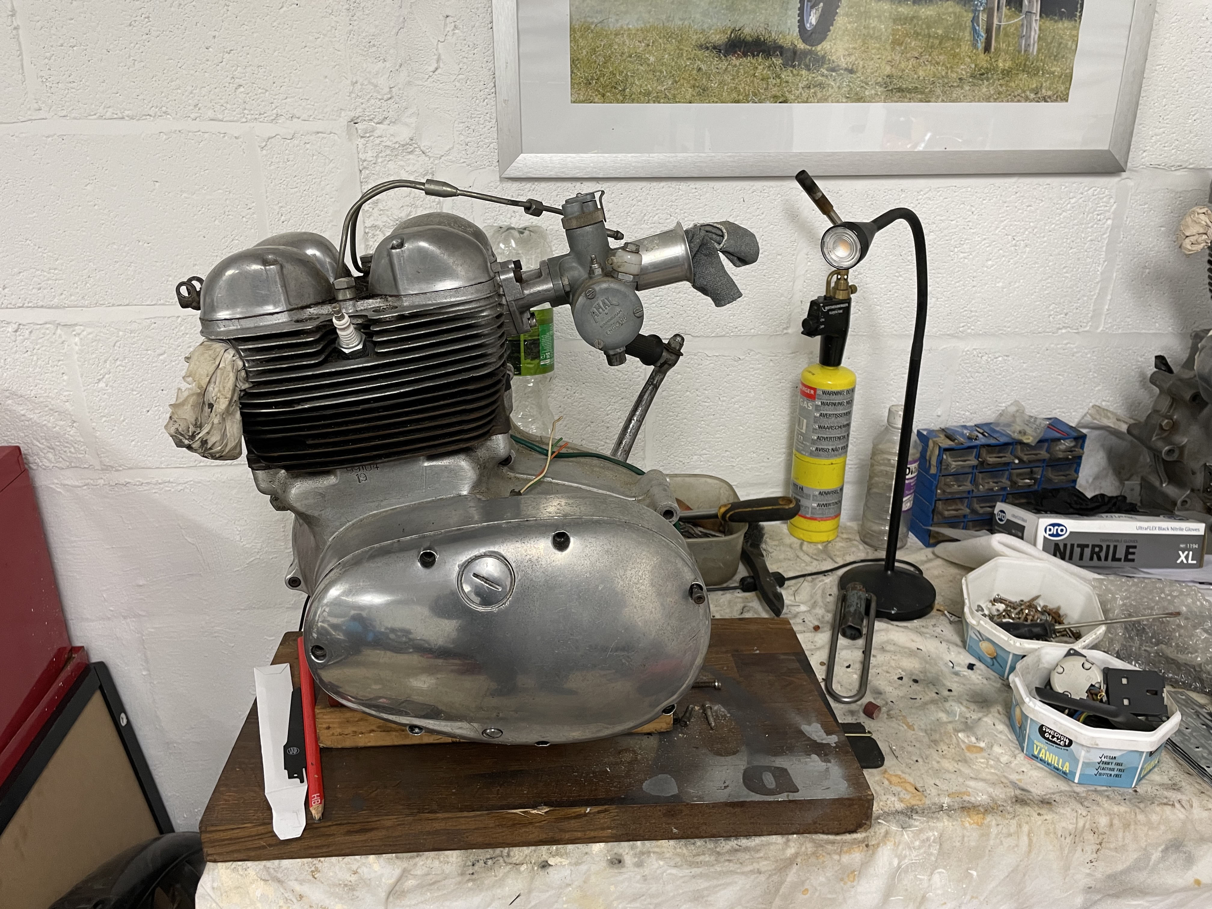

Just as a post to encourage others to do something with their lightweight projects over the winter here are a few shots of my Navigator project, its temporarily assembled from parts from various places … so the numbers don’t match, and the observant of you will see that its a deluxe frame, but I’m not a fan of the enclosures and as I have an oil tank and battery box its going to be dressed as a standard. But I do intend to retain the under seat tool box which I liked back in the day, and leaves the battery box for …. well … the battery! You’ll probably notice that the forks currently fitted are jubilee which will be refurbed and put back where they belong - on my Jubilee! and the road holder front end on the jubilee will be fitted to the Navigator. Colour … not sure but I think Polychromatic Blue (well Pacific Blue if I’m honest!) and Silver Fox is my current non standard thought. I think the tank is NOS which was a bit of a find, the seat is cut down featherbed I think and will need a bit of work to make it fit well. First job is to see if the FB marketplace engine runs as well as the seller said! I’ve pinned the layshaft bush and replaced the gearbox bearings, if its not in good shape then it will be stripped and rebuilt but I’m always optimistic!

Ranulph, I dont know if you read the history but they nearly did make a 125, or at least thats what Bert Hopwood wanted to do, a 125, 250 twin and 400 four ……. If only! The Navi came in blue with a black frame, I’m going for a blue frame and silver tank as a homage to my first Norton that looked much better than it went!

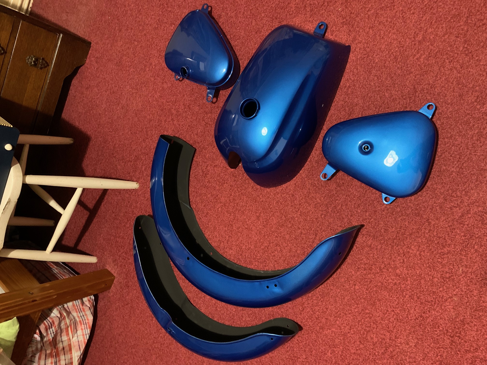

Having survived a manically busy Advent and Christmas when the bikes sat dormant in the garage I am trying to get down to starting my long overdue Navigator rebuild now that the tanks and mudgaurds have arrived back from the spray shop. I am really pleased with the finish which is as close as we could get to Polychromatic blue. You probably know these details but just in case you need the reference I used Lotus Pacific Blue Metallic. I am told the ICI paint code p4217750, the Lotus paint code is A68 and part number A089B6196V. The picture attached doesn't really do it justice - it really is a gorgeous colour and incredibly close to the original! I can recommend AutoRefurb in Crewkerne who did a cracking job at a very reasonable price.

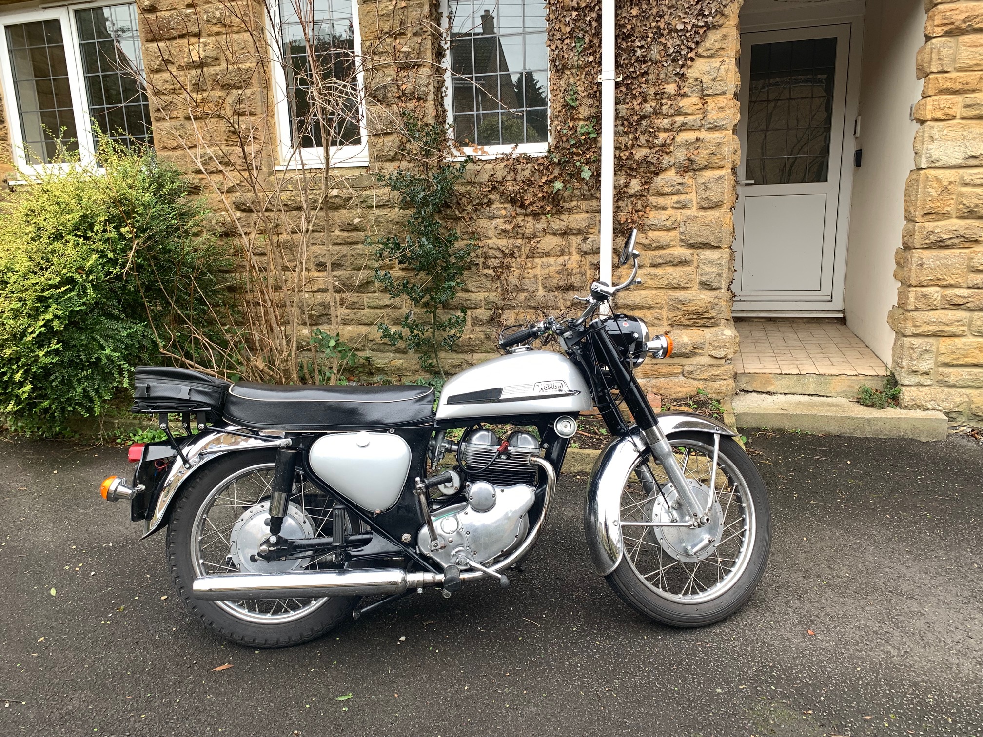

If I do I just know I will end up lifting the barrels to check and replace the cam followers and guides to hopefully mute the Lightweight rattles now new ones are available.........and of course then check the bores and rings........and whilst the heads are off I might as well replace the valve guides and perhaps the valves to cure the slight tendency to smoke.......and then replace the brake shoes to sharpen up the brakes.......and replace the centre stand spring......and...... You recognise the symptoms? I've included a couple of pictures of the Electra after yesterdays run. It really has exceeded my expectations - another step up from my beloved Navigator!
