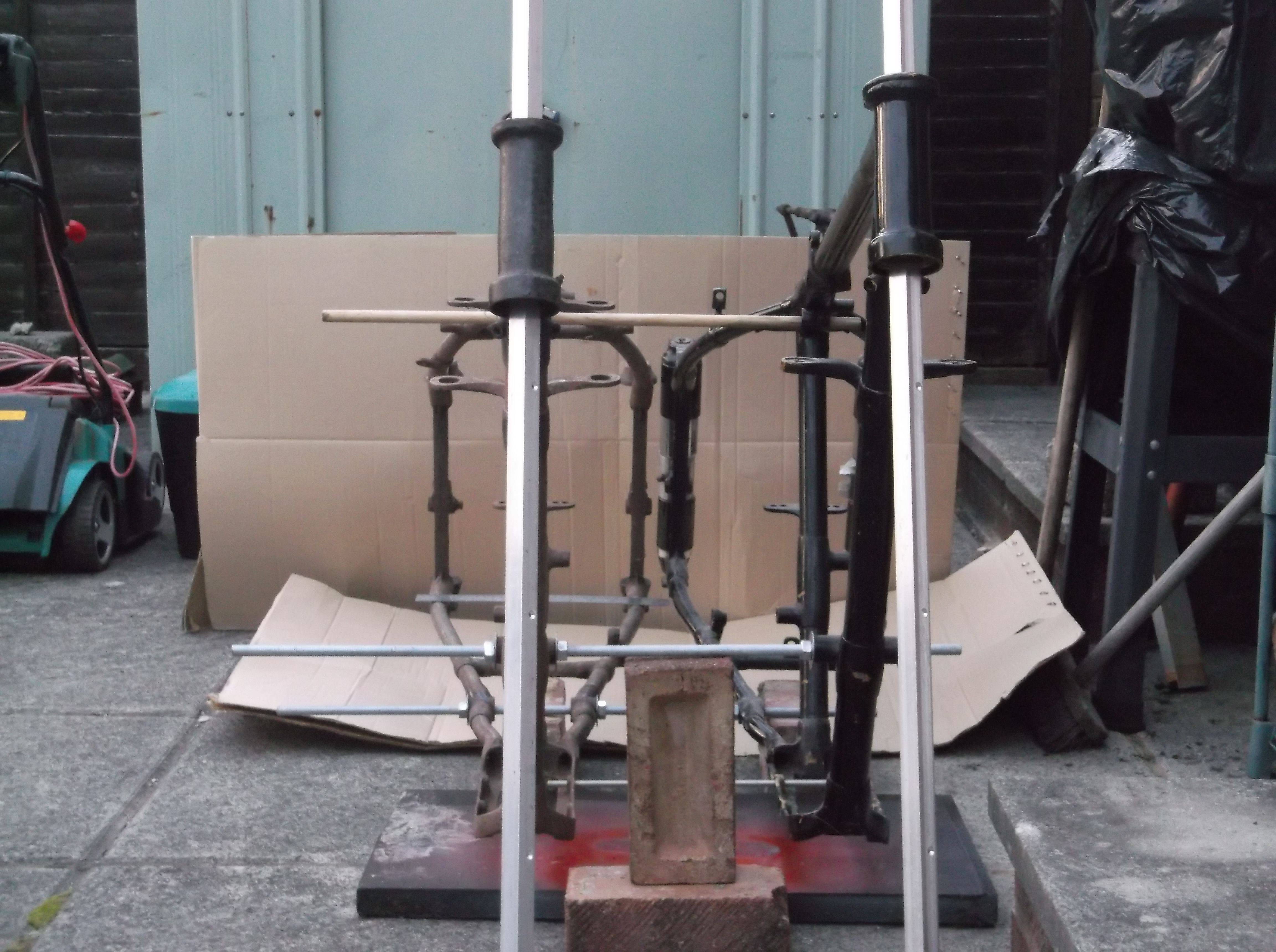

Hi Ian, et al,
   I managed to find these photos after trawling though several SD cards which I took some time ago. This was when I had an opportunity to take my 1939 ES2 frame (the rusty one) over to a friend's place to compare it with his painted 1939 Model 30 Inter frame which has the suspension fitted. These 2 frames are about 600 numbers apart, so probably made within a couple of months of each other. We used lengths of studding to align the cradles, gearbox and front engine lug to try and get a datum, but when the bikes are complete it will be the headstock which will be the same height and the cradle will drop lower on the Inter, the other main point being the rear wheel spindle. The camera angle is a bit deceptive, so you might have to look with that in mind when comparing them.
