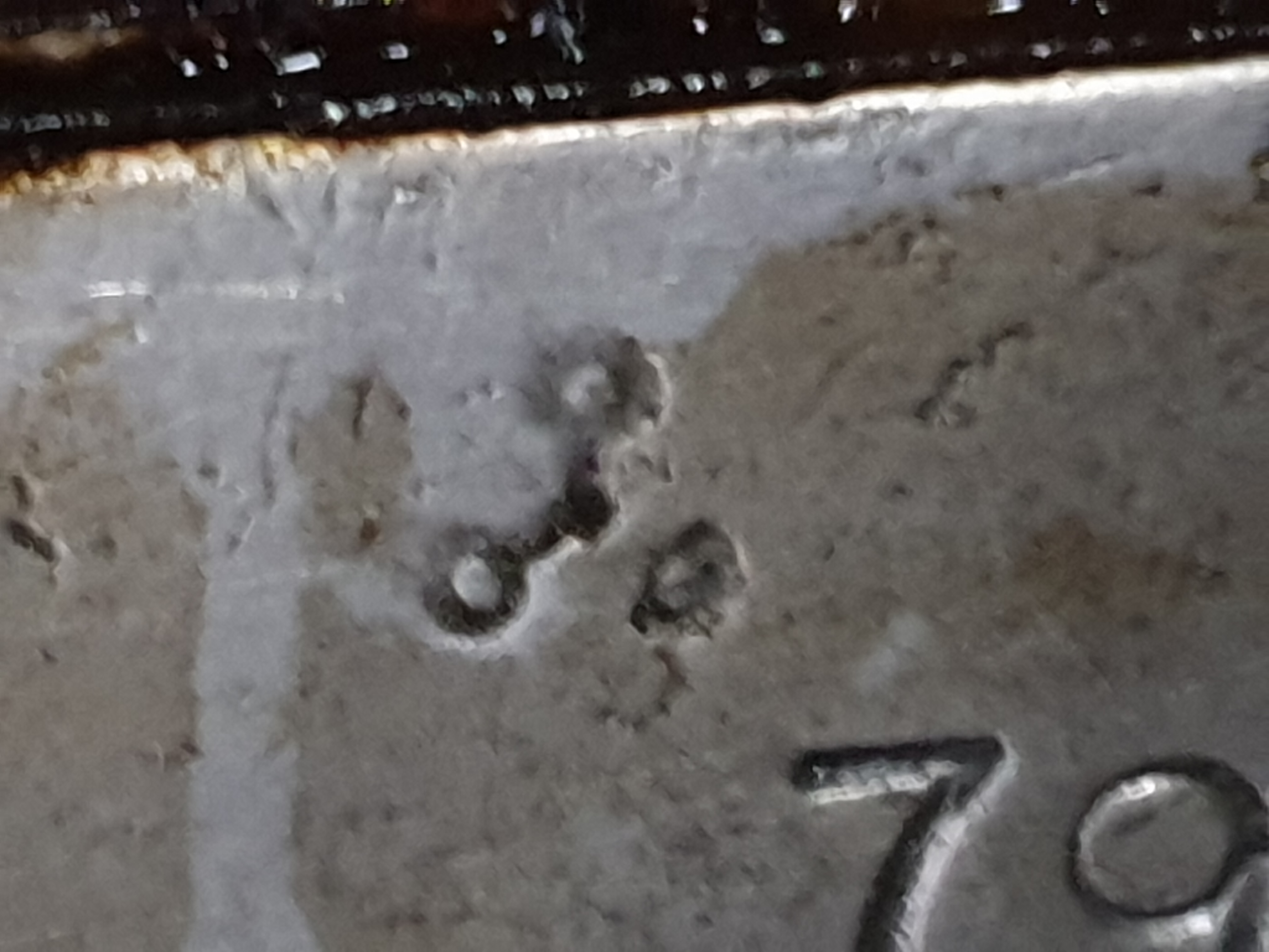

hi
my 1935 Inter, along with several others seen recently (all 30's by possible coincidence), has a stamping above the engine number. It is a three-legged figure with a small circle at the outer end of each arm....or leg?. Anyone any ideas what this means. Some people think that it means that the engine has been back to the factory for special work, some say it has something to do with Harold Daniells.....which is a possibility as my bike was allegedly in his ownership at one time.

I have a 1932 inter with the same stamping and was told that this meant that it has been worked on by the racing department or some thing like that.

Andrew's comment sounds plausible but I wonder if it is simpler. The factory allegedly ran all the Inter engines in on the bench. Surely they would have hard stamped each one afterwards to make sure they did not mix them up? Could that be it? Is there anyone out there with an Inter that does NOT have the stamp?

   I have been asked this question a couple of times over the years and have never found a definitive answer. In my opinion, there are not enough of these marked engines to be a factory marking, and my best guess is that this is a mark used by an individual tuner with Steve Lancefield being the most likely. This would be the connection with Harold Daniell as he was his brother-in-law.
Well my 1936 350 Inter has the marking on the crankcase and all the owners before me lived up in Scotland in the Inverness area and there is no history of racing or tuning that I know of. It was last on the road in 1960 in Scotland before I bought it in 1986. It is in full touring trim.

Just to the left of the rear upper crank case bolt, it has '79 x 100'
I believe it was a rule for racing to have the cylinder dimensions stamped on the crank case.  Was this stamping done on all ohc Nortons?

All pre-war Nortons were stamped with the bore x stroke...maybe as a guide in the factory. Even sporting beasts such as 16Hs and Big 4s feature the marking...82 x 120 in the case of the latter. :-)
