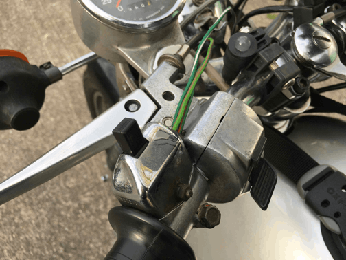

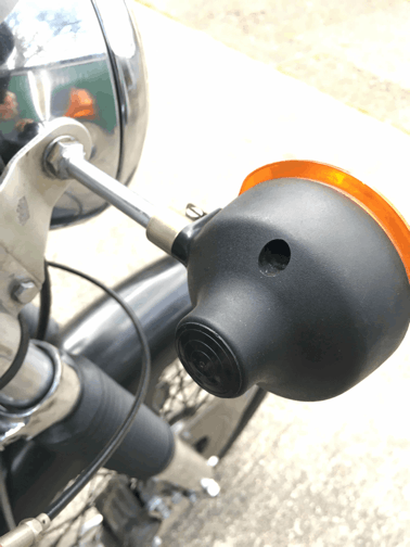

I'm directly interested in this point, since my Fastback is fitted with MZ indicators, in which the front lenses are equipped with ears to make operation clear (also MZ switchgear … ), but I retained the tell-tale in the headlamp.
MZ indicator
MZ switch
