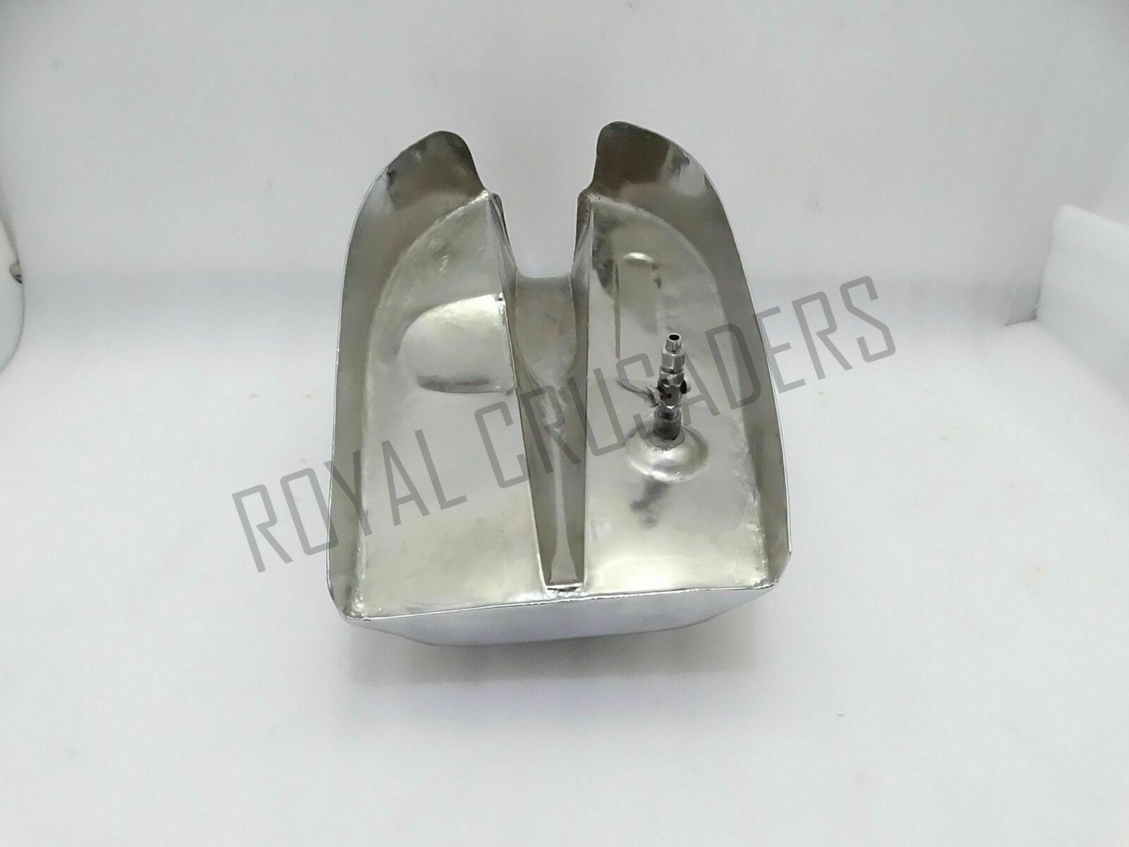

HELP WANTED BY NEW INTER OWNER WITH PETROL TANK BEYOND REDEMPTION
Q.1 Was the 1952-53 Dominator 88 frame the same as the '53 '54 Inter frame?
Q2. Will the fuel tanks interchange?
Q3. Has anyone purchased a petrol tank from vintageconnexions in India? I have added pictures         top and bottom of the same tank.
I look forward to any help members may be able to give. Info is a bit scarce here in Australia!
The Featherbed Inter tanks were different then the featherbed twins to the best of my knowledge . Larger capacity I believe. It is my understanding that Inter tanks are very scarce so if you have an original you may want to think twice about abandoning it.
.......are different to clear heads.  They may use same top pressing but not certain.
Domi and Inter frames definitely different in several ways.
