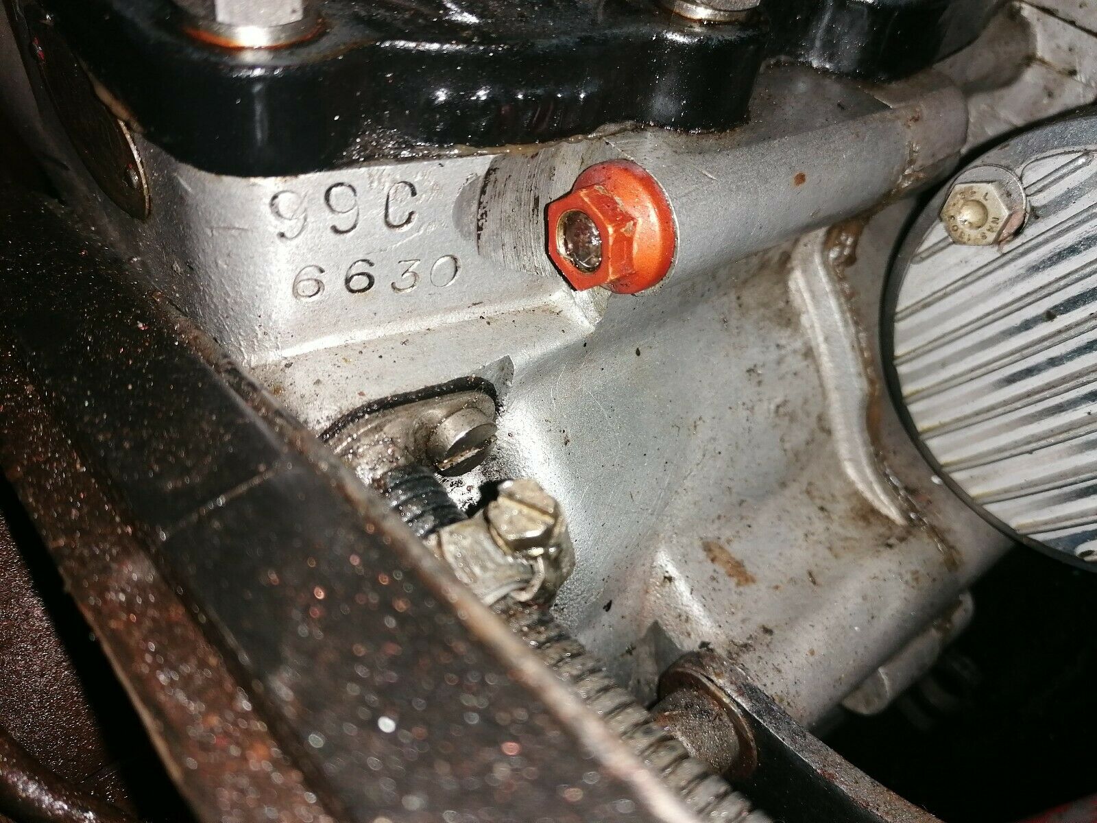

On the back left side of your engine should be some stamped numbers and letters. See attachment for example.
If you have 99C then your engine was originally built with an alternator and distributor igniition. If it just has 99 then it would have sported magneto ignition.
