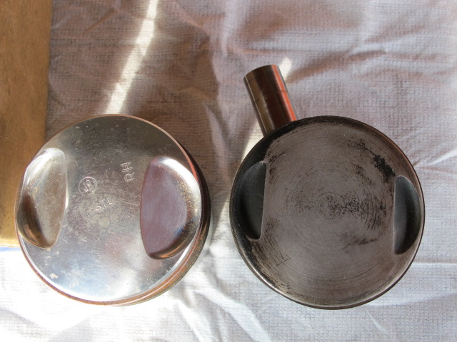

Many thanks to you both for your time and efforts but I am suprised at Anna's assertion that they are 7:4 to 1 ratio. They are slightly domed with much larger valve pockets when compared to a flat top 13325 pictured alongside. Looking inside a piston the only markings are on the gudgeon pin bosses with the AE logo and 413 at one end with 163 and 62 at the other. It is always possible the pistons are not in their original box etc but the " Vacrom " coating which is still visible on the top ring and the circlip packet gives some validity. i reckon they are a bit higher than 7:4 to 1 so it is over to you guys to shoot me down in flames.

Certainly not 7.4:1 (usual…
Certainly not 7.4:1 (usual caveats - depends on the cylinder head of course). Looks more like 8.5:1 or thereabouts. With petrol being what it is these days, I'm not keen on running much above 7.5:1 though I appreciate that low compression pistons for Norton twins aresomewhat scarce.
Attached photo shows my co…
Attached photo shows my collection of spare 99 pistons. Ranging from standard bore up through +20, +40 to +60 thou.
The three on the left are all Heplex 13408...the +60 is an AE 16606 item. I think that all of them have the 413 and 613 numbers inside.
All the crown heights are the same give or take a thou. I would say that all of these are around 9 to 1 compression...possibly a little more. The final compression ratio depends on the head. The pre-SS/22707 heads usually being lower compression whilst using the same pistons.
As these pistons look very similar to those from Phil Chester, I would find it difficult to accept them as 7.4:1 CR. Unless they were flat topped. Which they are not.
