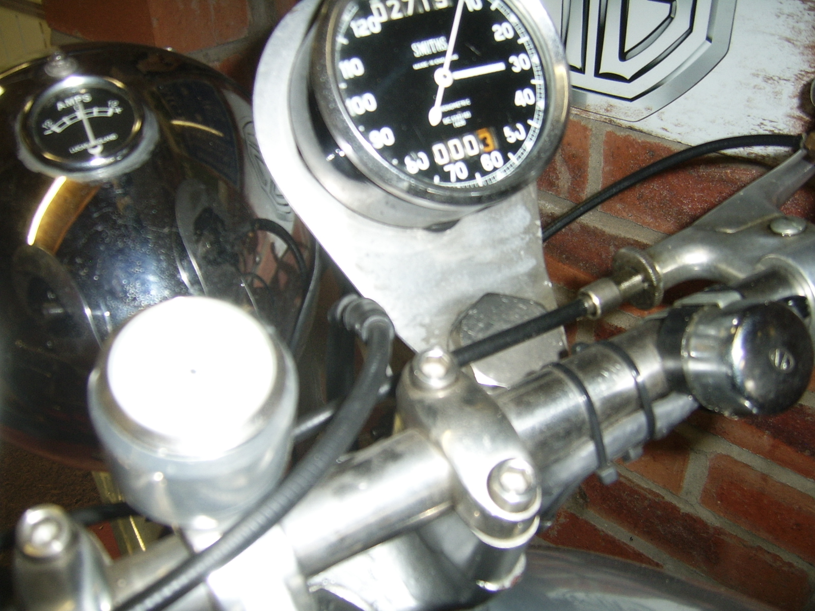

These risers are on my 650 ss bitsa and my poor man's Manx.
They are home made from solid stainless and rise the Norton Stainless flat bars from RGM. The rise is 1 1/2 inches, improves riding position (IMHO) but an improvement on cable routing.
No new threads are required, just longer screws (Allen's) I bought from Middleton's, stainless of course.
If you are making risers such as these, remember to keep the tollerences tight. I have found no difference with regard to handling @ 1 1/2 inches rise. Only reason for me not using risers is with regard to my original bikes but that is for the rider and you don't really notice them anyway.

I thought this thread was concerning risers?
Anyway, the two machines I changed the rise ("1 1/2 " up) retained the std cable length and that was the idea, as well as the rise in height. Bars remain the same - Straights in these cases.
Sorry I didn't make that point clear. At least you have the pictures.
