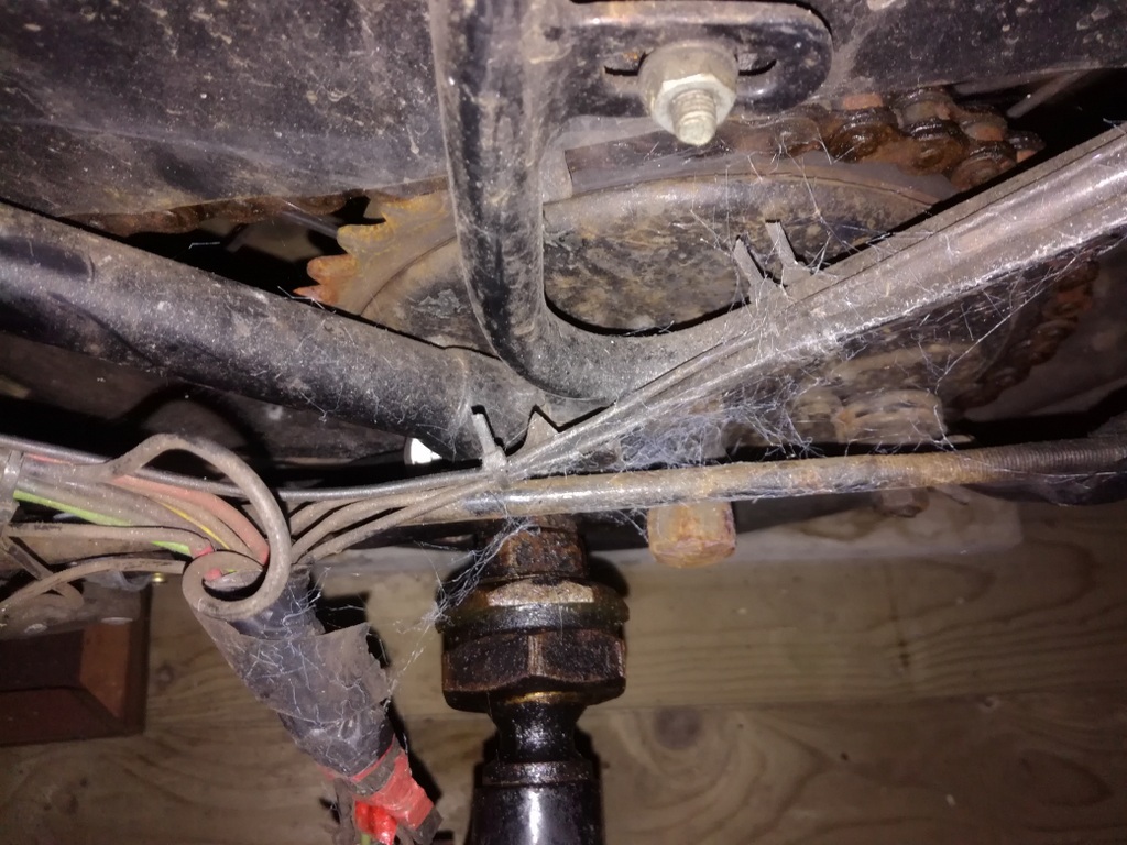

I have acquired another sidecar, but i am having difficulty finding the right fittings - particularly the one for the back hole at the rear wheel - as shown on second pic from another bike.   Appreciate any suggestions/help to get the job done. Finding parts and / or setting up the sidecar.

   I think you will be best to put a wanted advert in the Roadholder or the Old Bike Mart etc. for the rear ball joint. Check your engine sprocket which should be 17 teeth for sidecar work. I have attached a scan from a period maintenace book with some general setting up info, but the acid test is the outfit should hold a straight line with-out having to use too much effort.
