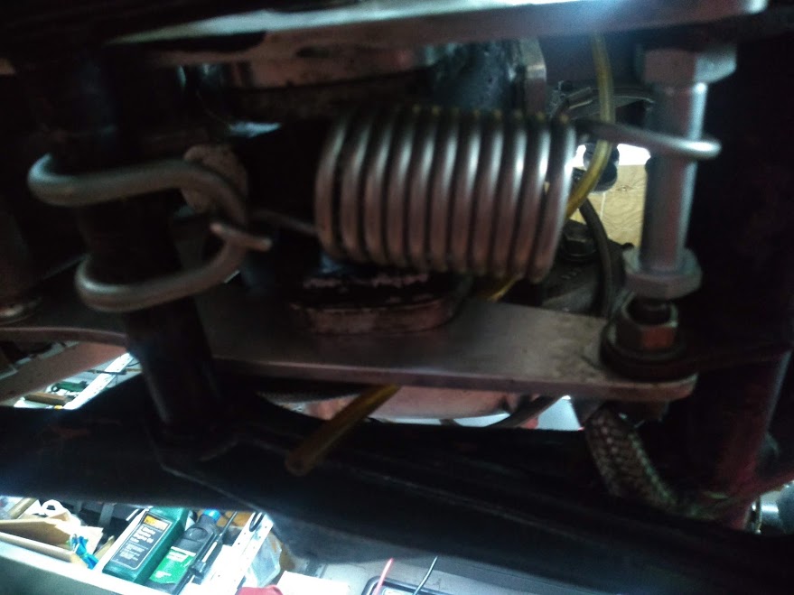

I have a wide line frame with a Gold Star engine and gearbox mounted in Coverta plates. Having only a side stand and getting on a bit starting the engine was getting hard so I have fitted a center stand. .After disassembly of the primary chain case I began to fit the center stand with the correct mounting bolts. My problem then became obvious the fitting of the return spring in the position shown on the manual [vertical] it was too long.I didn't have anywhere to fit it to the engine plate and to make matters worst the gearbox was in the way. So after a lot of pondering I got a spring for an earlier Commando [Short] and fitted this in the horizontal position onto an extended bolt on the rear of the gearbox plate to rear lug.[see attachment] The spring was still too long for this position so I began to shorted it a little at a time so the stand returned to the correct position. Having previously owning a genuine Gold Star I found it easy to put it on the center stand but with this Norton framed Gold Star it is very heavy to put on the stand. After looking at the mounting point on the BSA it is about 12" further back so it only lifted the rear wheel but on the Norton I am lifting the whole engine. Has anyone else experienced this?
