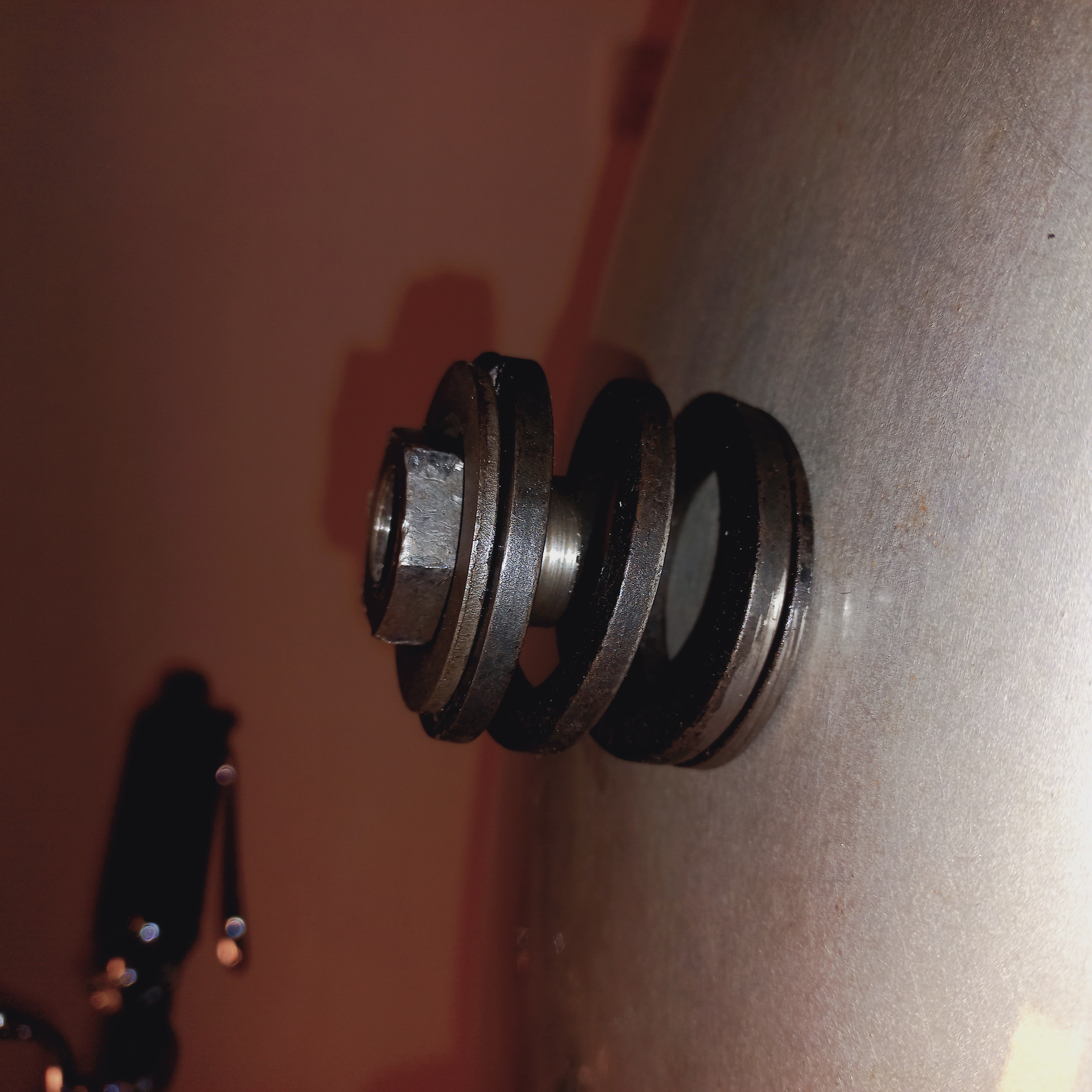

It seems as though the…
It seems as though the spring cannot compress any further (coil bound) if that is possible. If the spring is not an original, it would explain why it's such a heavy clutch to lift.

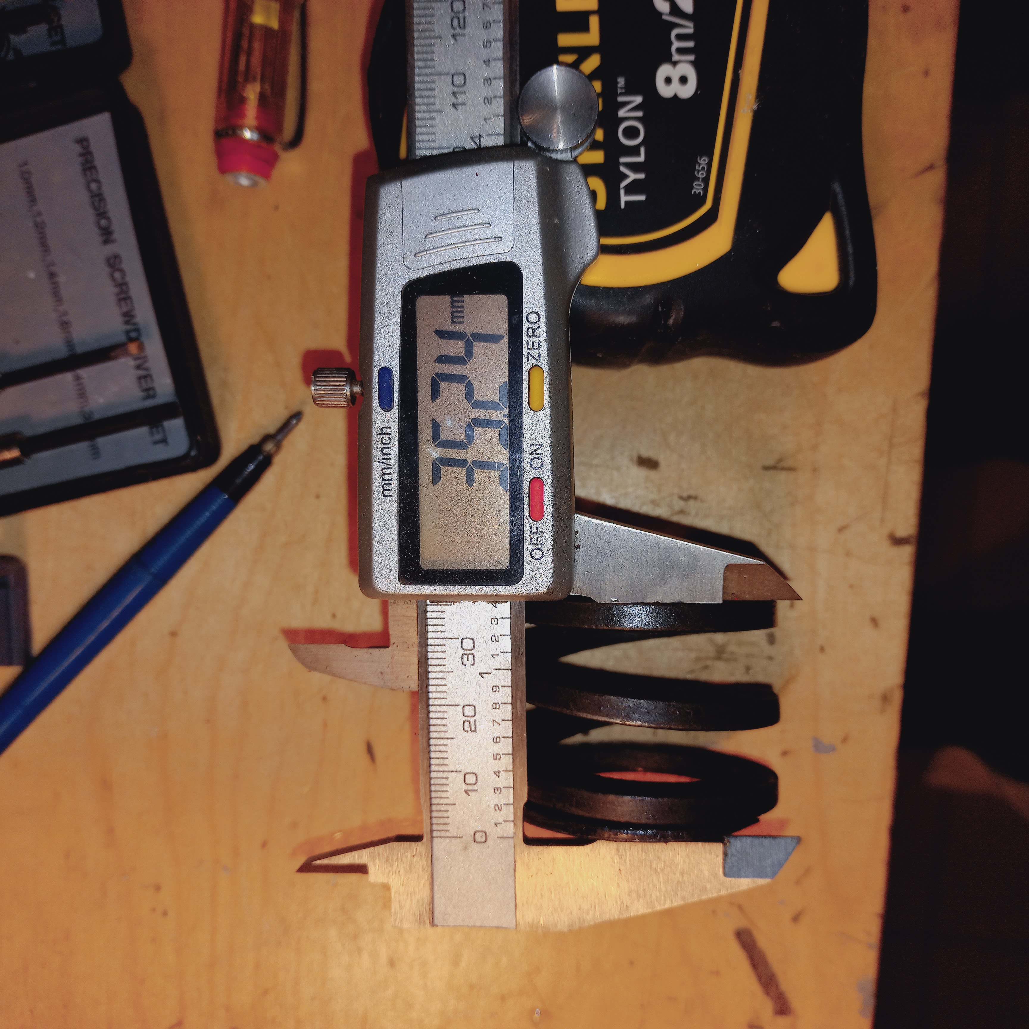

Is there a dimension available for the standard Norton clutch spring? Free length I mean.
A
The spring is the one in the…
The spring is the one in the attached photos. It free length is as shown, 35.24mm but I find it very heavy to depress. I wonder if it is an original?

On the earlier machines the…
On the earlier machines the central nut has a tendency to unwind until it meets the cover. If it did work once but now does not, might this be the problem? That happened to me on a borrowed 1929 Model 18 on Banbury Run some years ago - I just got back to the start before I couldn't disengage the clutch at all. I think my friend (who then owned it) added a locking device of some sort.
