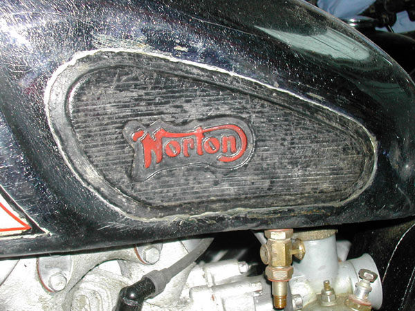

I attach a picture of a factory original item still in situ on my Model 7.

The knee grips are Model 7 items part number K12/282 (R/H) and K12/282 (L/H). Numbers taken from original ES2 spares book.They are about 6 1/2 inches long and glue on, there are no screws involved.
