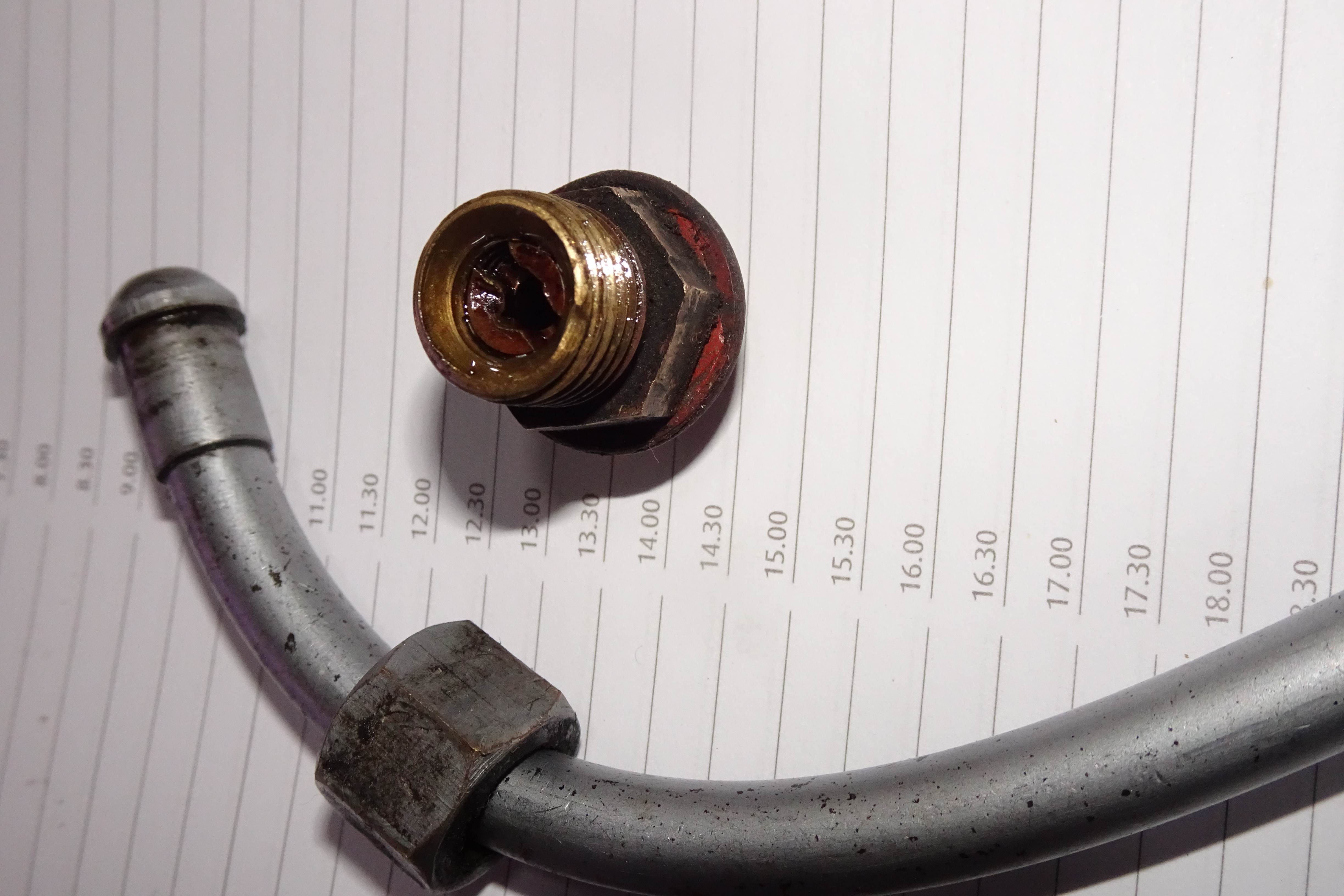

I have read somewhere that the breather pipe exiting the engine at about 2 o'clock looking at the drive side crankcase should have a ball valve in it. My rebuild does not have one, and when I kick the the engine over there is a loud gasping sound from it. When I block the outlet pipe there is no gasping sound.
I think this breather pipe will allow the engine to be open to atmosphere as there is no rotating disk or any mechanism on the crank end.
I suspect that if I ran the engine like this the entire oil tank would be on the garage floor very soon.
How does it all work?

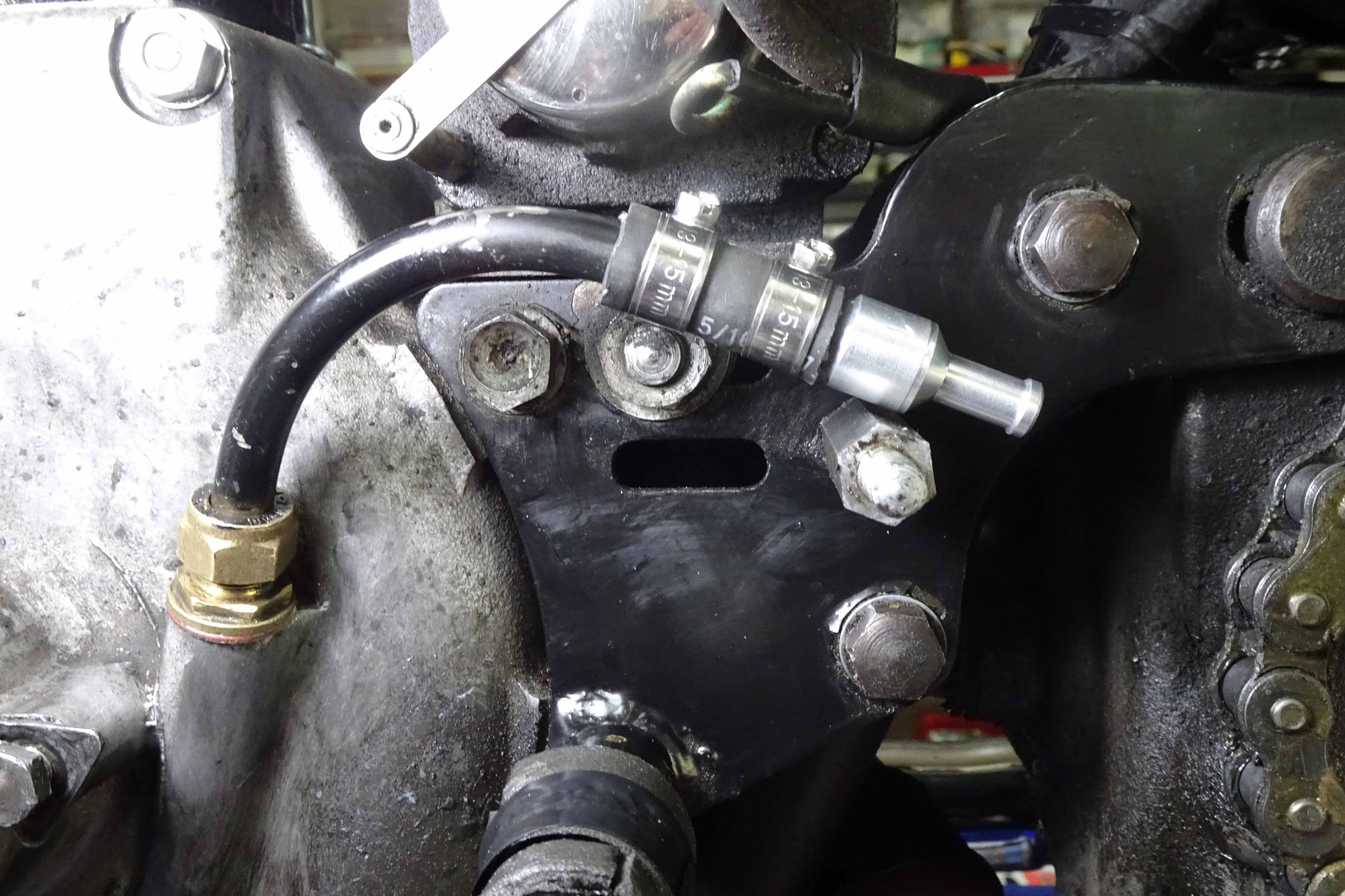

An alternative to the ball valve is a fuel system non-return valve fitted on the end of the breather pipe. With a larger cross section it should be less restrictive than the ball valve, presenting lower resistance to flow and so reducing crankcase pressure more effectively. The BSP union on the crankcase can be drilled out to match the pipe bore to further reduce resistance to flow.

The ball valve..
does not look like a separate component. It is built into the BSP union, so maybe you do have one fitted to your crankcase.

Reed valve
Richard
On my M 50 I fitted a reed valve from a Yamaha or Beta,(not sure which) all leaks cured ! crankcases now have negative pressure, and the only minor point after 4k miles is, the cy head bolts rusting, as the engine is so oil tight.

I removed my breather I…
I removed my breather I fitted a "duck bill" from Hitchcocks, which is just a flatted off lenth of rubber that breaths out but not in. It cost next to nothing, is incospicuous,and works. Iv looked on their Web site but can't find it now.
I can't figure out how to post a link, but do a Google search on duck bill nrv and you will get the idea..
E Bay Royal Enfield duckbill…
E Bay Royal Enfield duckbill breather pipe and clip 140167.
I point it at the rear chain, although there is very little oil comes out of it.
