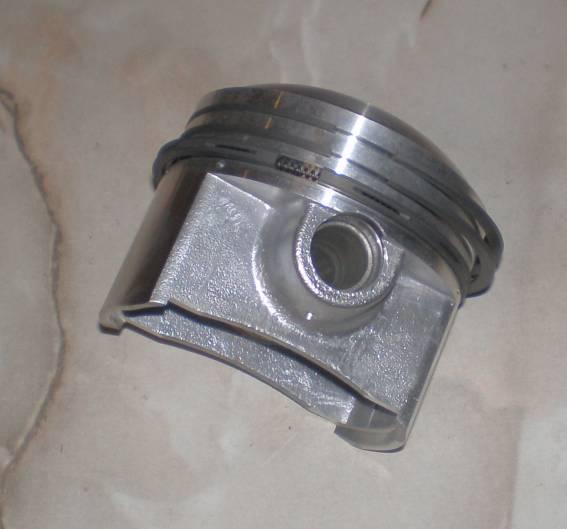

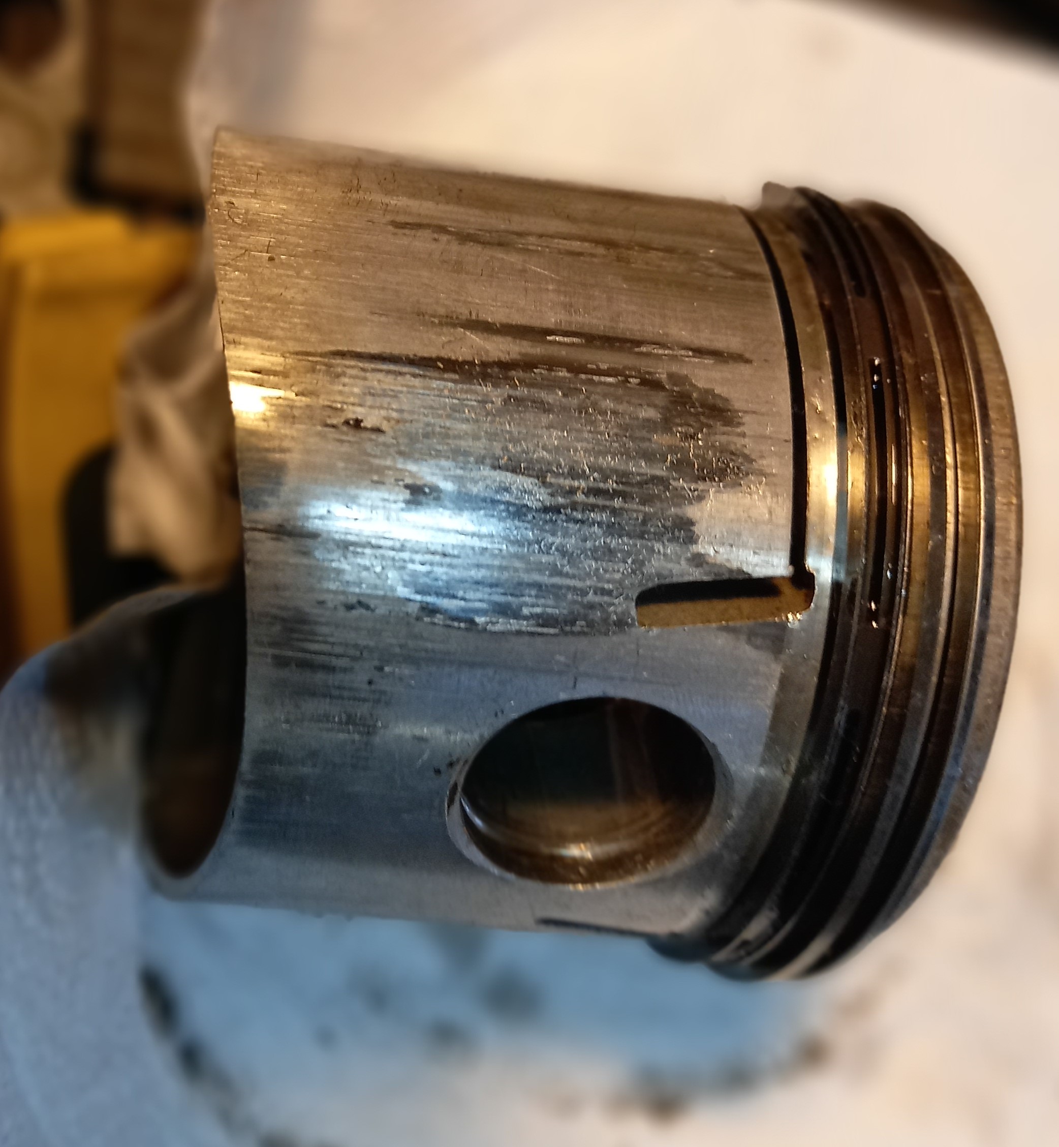

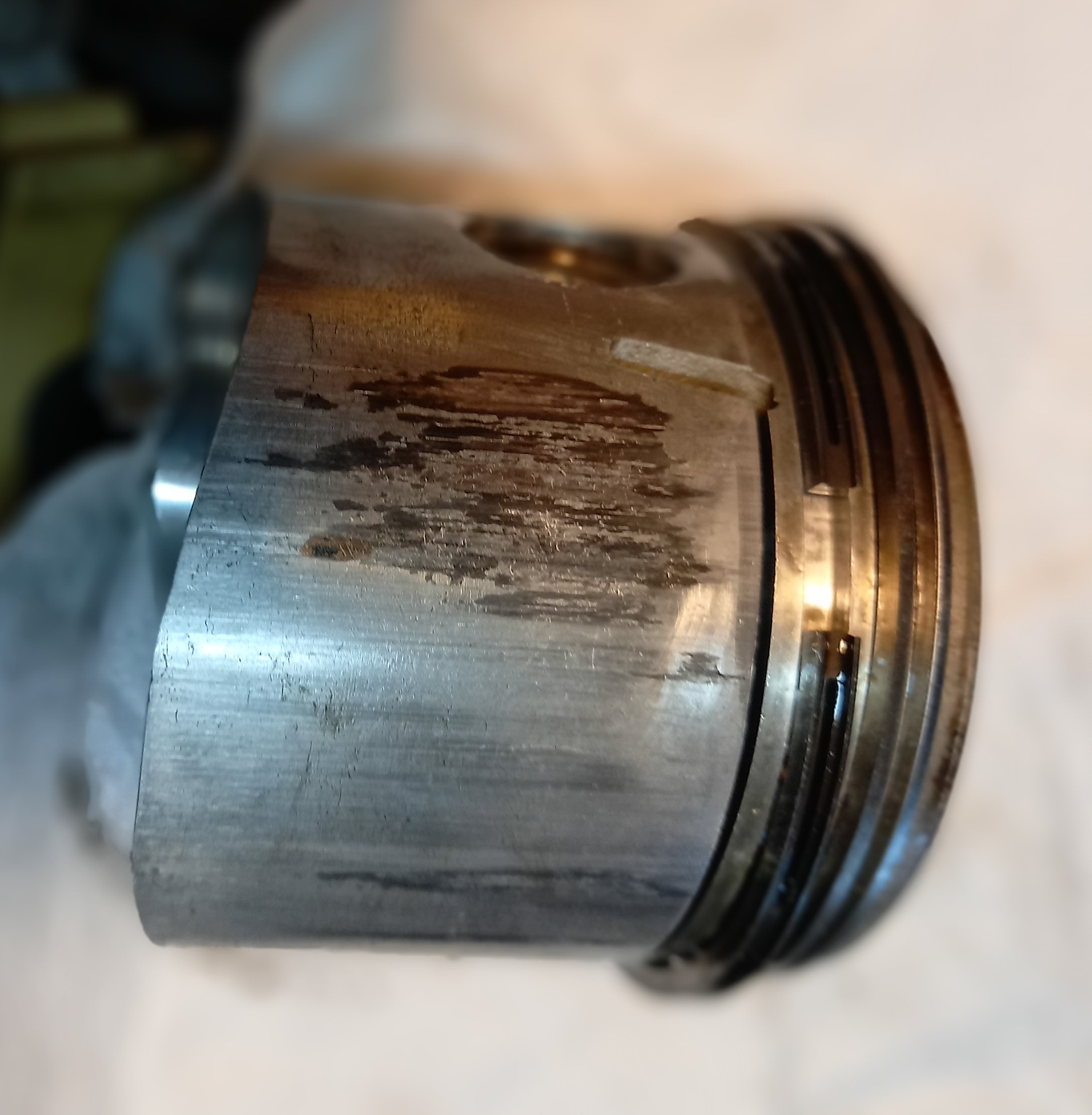

Stripped it yesterday, the piston has seize marks at 45 d off front to back, see photo. No real seize marks on the piston thrust face (rear) or front. No damage to the rings or top of piston, but the exhaust valve is white in the center, black on the edges. Inlet valve is black. Plug doesn't show signs of overheating. Oil is circulating ok, tank was about 60 C after about 20km. Cylinder head temperature deep inside the fins about 5 minutes after switching off was about 140C.  Barrel shows some marking but hopefully not serious.
Knowledgeable people I have spoken to here have not seen such score marks. I'm taking it to specialist engineering shop tomorrow.
Has anyone had or seen such seize marks previously, or have any idea what the problem is?
Looks like a 4 corner seizure  caused by overheating and expansion.  I would clean up the bore and use a very fine file round the corners . Definately  richen the  mixture  by raising the needle 1 to  2 notches , May be worth trying a 3 slide. Also check your fuel flow is not restricted. What number needle jet?.
Hi Richard,
   Your piston skirt looks like it is circular when it should be cam turned so that the sides have much more clearance than the front and rear faces. 5 thou is O.K. for the thrust faces but this should only be about 1.5 inches across and then increase gradually to around 10 thou on each side. This allows the piston to expand with-out seizing. The exhaust valve looks like it is getting too hot, which could be a weak mixture or retarded ignition or both. If you have two petrol taps, turn them both on when starting to make sure there are no air locks in the pipes and once running turn off the reserve side.
I agree with Robert.
I would clean the score marks off with a file and richen the mixture up.
Maybe even give the barrels a light hone.
Phil Irving made a point of always holding the piston in your hand not in a vice when filing out score marks.
If it goes back together and dosent rattle too much you haven't lost anything.

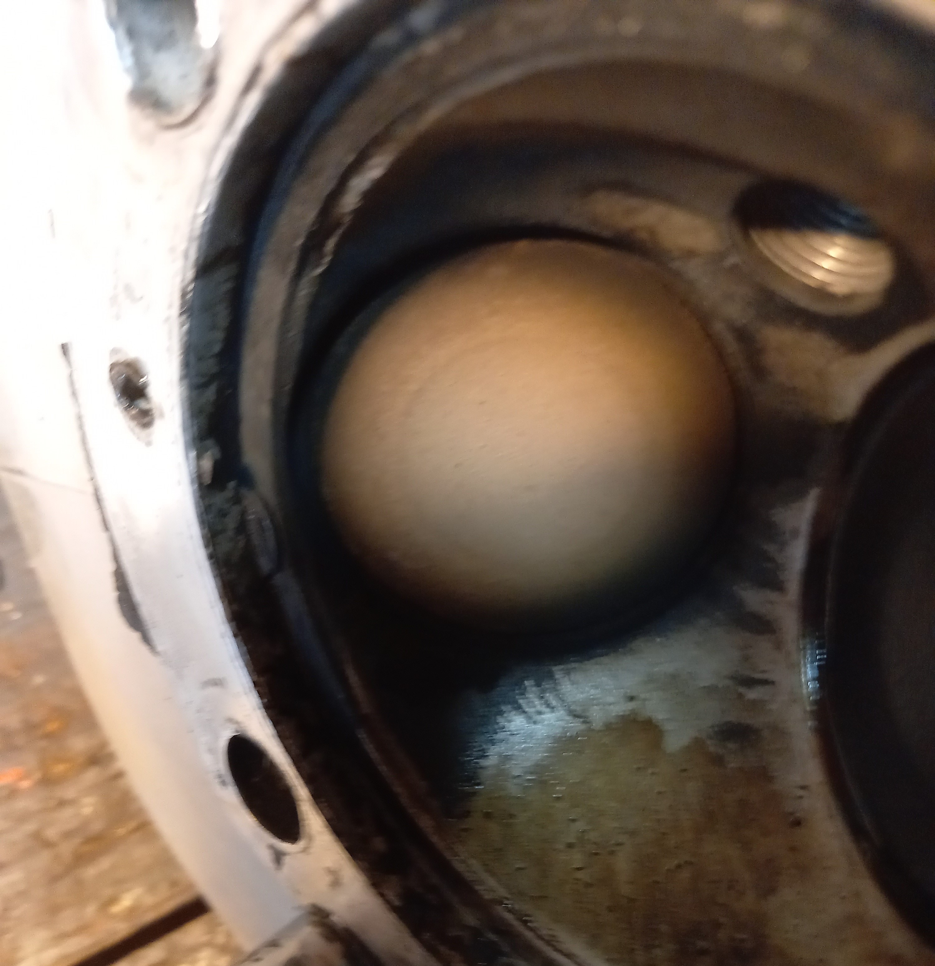

Interestingly, I took out the exhaust valve and found that although the face was white (showing overheating), the back side and sealing face are black and thick with carbon. Too much oil in there somewhere?
To check that the oil is going where it should, I intend to spin the crankshaft - driving via the large sprocket nut and an electric drill. Sounds crude I know, but I should be able to see if oil is coming out of the rear barrel feed hole, and up past the big end. It's worth a try anyhow. Does anyone know of a way to measure the oil pressure on this engine?
Its likely that as the oil is not getting  into the chamber  but is accumulating on the back of the valve  ,its probably leaking down the ex valve/guide or guide bore . Sometimes you can see a pattern on the back of the valve head or ex port . This does not always  show up  as  much smoke in the exhaust as a poor piston  ring or inlet valve oil  leak which gets burnt in the combustion process.

On another subject, remember those abrasion marks on the piston at 45 deg to the front rear plane. I have now seen that they line up almost exactly with the 4 holding down studs. Curious.
Could it be that over tightening the head nuts could have deformed the barrel/cylinder? Surely not.
Photo attached again
The piston was measured with a micrometer, it was 79.6 - 79.62 mm front to back;   79.44 - 79.45 side to side;   79.6 at 45 deg.
The barrel is 79.69 f-b;   79.71 s-s;    79.68 @ 45 deg
So clearances are front - back 3.2 thou;    side - side 11 thou (5.5 each side of the piston);    45 deg 3.2 thou (1.6 each side of the piston)
It looks like the clearance at 45 deg is much too little - this agrees with the seize marks. Maybe the side to side relief doesn't go around the piston sides enough.
Any comments please?
