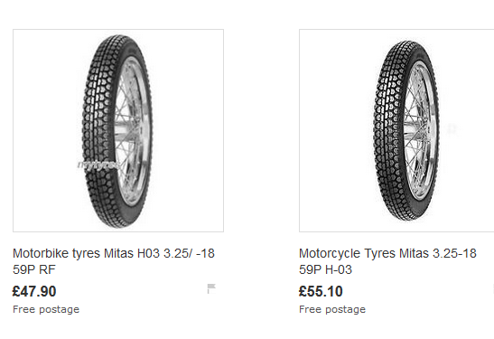

Back to tyres for a moment - I find (as Peter says) that you cannot stray far from the truth with the back tyre. Also, a good old-fashioned square profile is recommended.
As Peter says - stray off the guidelines with a modern round proflie tyre and you are inviting trouble. There is very little room 'twixt tyre sidewall & mudguard alongside the chain run.
Mitas tyres are OK in my book - they do an excellent tyre - I have one fitted at present.
Its 3.25 x 18 on the rear. - See photo
