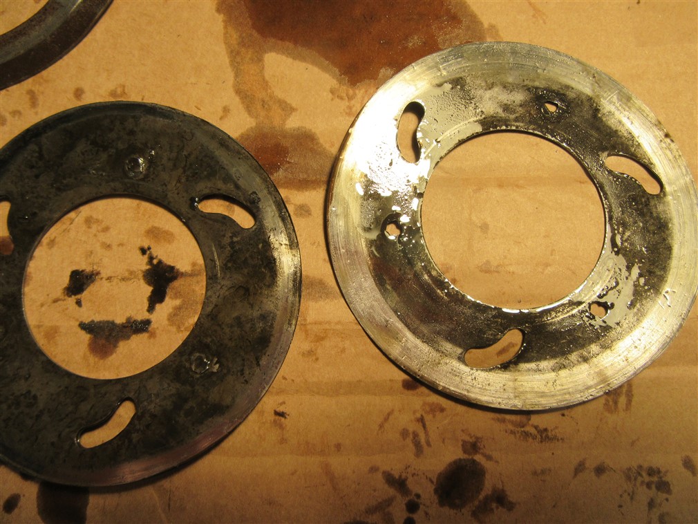

What have I found? There are 3 wave washers, 2 of which are riveted together with the third floating free (but with holes suggesting it was once attached). There is a slightly wavy washer located in the outrigger which I take to be part 24745 wave spring friction plate. I can see that potentially having a floating plate may prevent the pawls from moving correctly.

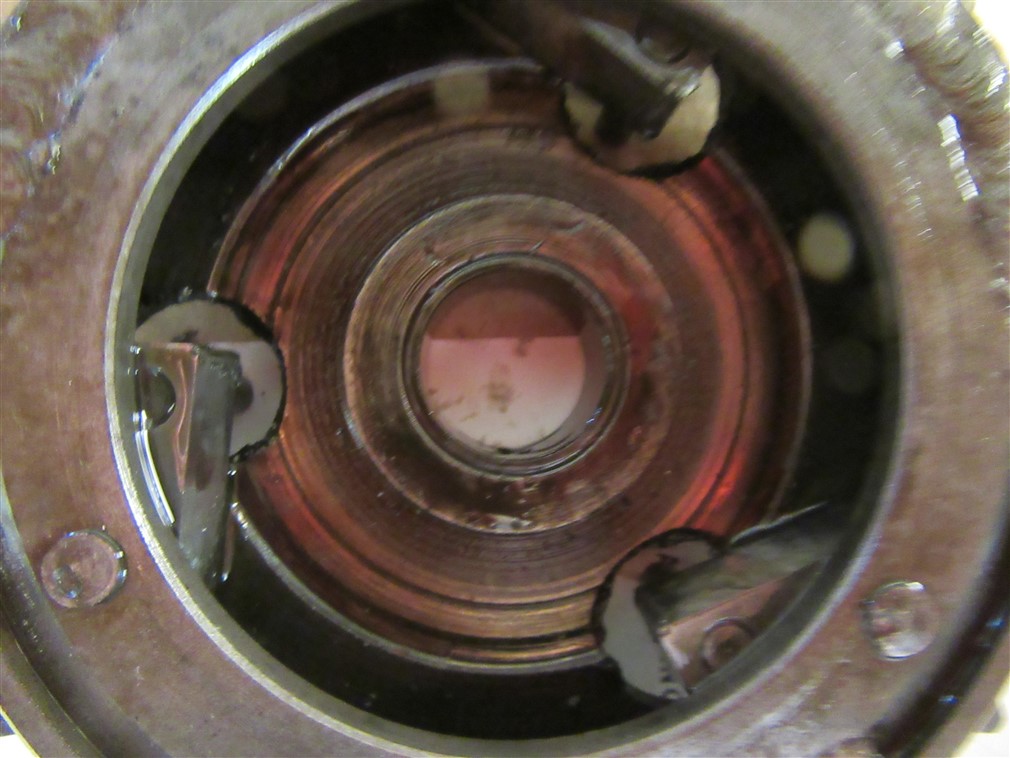

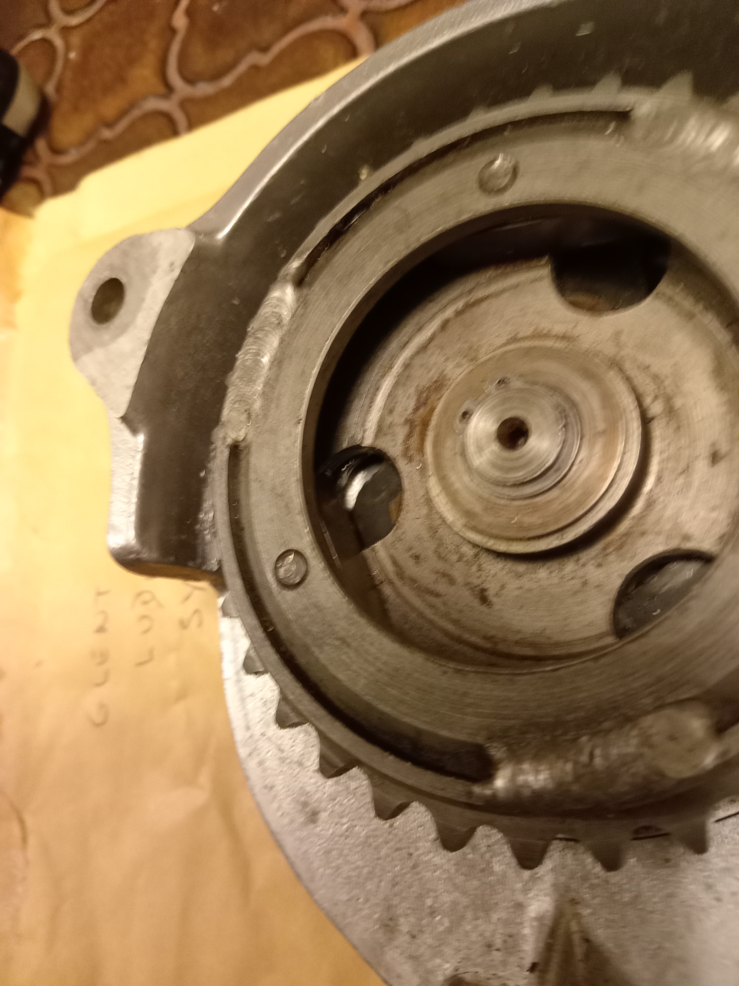

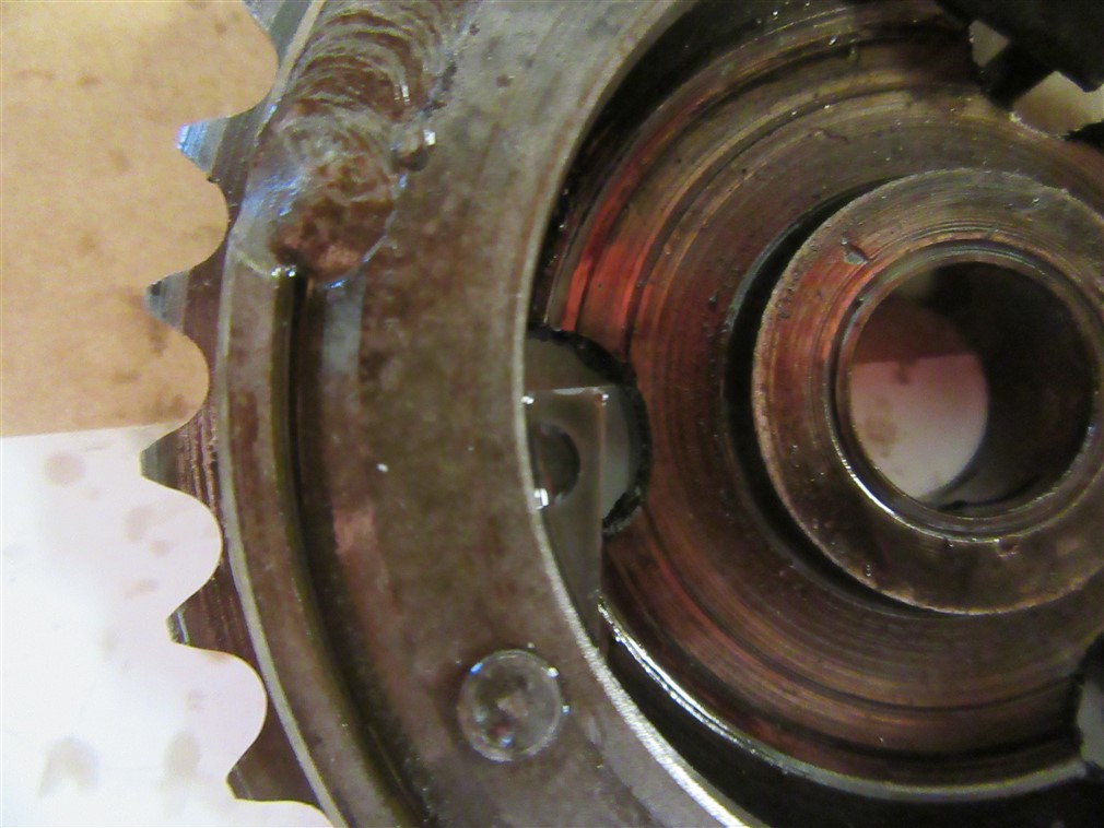

The pawls show slight signs of wear but look serviceable to me. The pins are not bent and the pawls move freely. The ratchet teeth look OK to me and are fairly sharp edged.
One more query - I can't see the purpose of the thin steel plate covering the end of the ratchet assembly (part 24740?). I propose to omit this and tap a 1/4" Cycle thread in the end of the shaft to facilitate fitting a timing disc. I will use loctite and nyloc nuts on the fixing screws as I can see that if they come adrift it would cause mayhem....

Adding further to this issue, I have a spare one of these, and the three plates were originally spot welded together. I don't see that pop riveting is a good idea as the whole assembly spins!! and throws the pawls onto the crank and engage and turn it, then of course once the engine/crank is spinning the pawls disengage.This function happening due to the three L shaped slots.

I think the pawls are in good enough condition - the pins are firmly attached and unworn, and the pawls rotate freely in the housing. The leading edges are very slightly burred but I don't think enough to stop them working. The ratchet on the crankshaft shows no signs of wear..

1. The fixed steel washer is quite distorted. I think it needs to be flat to work effectively. NOC spares list this.
2. The fact I have 3 wave washers. I can see that the unattached one could float and defeat the operation of the pawl pins. I assume the NOC spares washer is a single one?

Wave washer
Wave washer as fitted to all Electra is three lamination thick. Spot welded together. This is the only wave washer you can purchase from NOC.

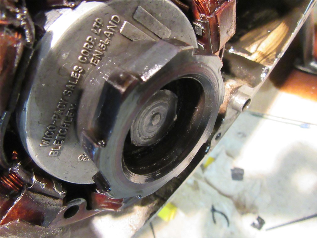

The reason for the above details is to ensure no part of the rotating bolt head ever touches the stationary outrigger shaft. Your bolt head looks a bit rubbed to me.

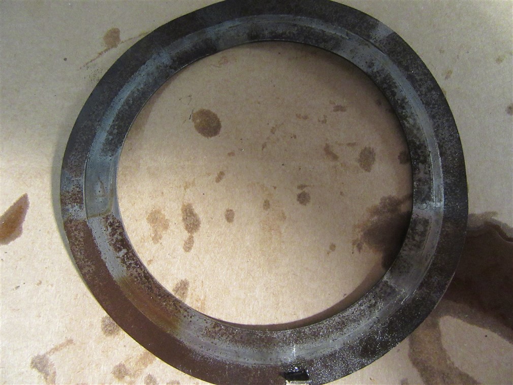

The inboard end of the outrigger shaft has an external circlip. Behind the circlip is a hardened thrust washer. About 1 ins diameter and 2mm thick. If PO has omitted the thrust washer, or replaced it with a random common washer, you could be in trouble. The thrust washer thickness controls the 'squash' of the wave washer, and the penetration of the pawl pins through the cam slots in the wave washer. Hardened because it interfaces circlip and sprag carrier assembly at up to 1000rpm.
Photo attached may help. These pitfalls could catch the unwary buyer of a bitsa bike.
AHA
AHA, having just sorted my 'squirrel' store I am also better informed. This hardened thrust washer is 1.8 mm thick, ID 12.1 OD 25.5 ( in old money about 1") and of course it controls the 'squash' of the waves. Hmm interesting.
By the way my Pawls on the bike were very worn but suitable welding and grinding got them back into working order. The pin is 4 mm and I used a drill shank-very hard.

.. My thrust washer is 1.5mm thick and seems to show machining marks on one side. Not sure why. I think I'll try it and if no good will get one made (beyond my capabilities). I can't work out what 24760 and 24794 are from the very poor diagram I have. Are they the nut and washer that hold the ratchet onto the crankshaft?

...assuming that 24794 is the large bolt that holds the ratchet to the crankshaft end, there are indeed witness marks that it has been contacting the outrigger shaft as you suggest Peter. It was also barely more than finger tight! The tab washer is very thin although I haven't measured it and am unclear about how I could get at it to fold over the bolt head - if indeed that is required.
It's within my ability to turn a recess within the head which I assume will prevent this from happening in future.
