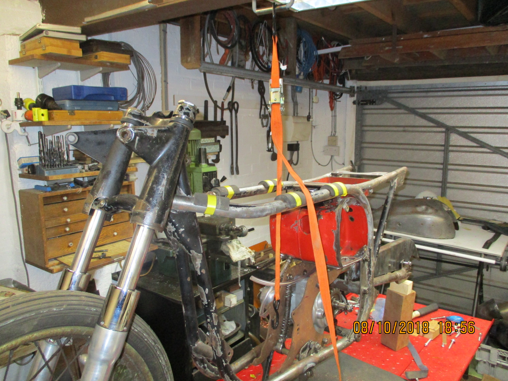

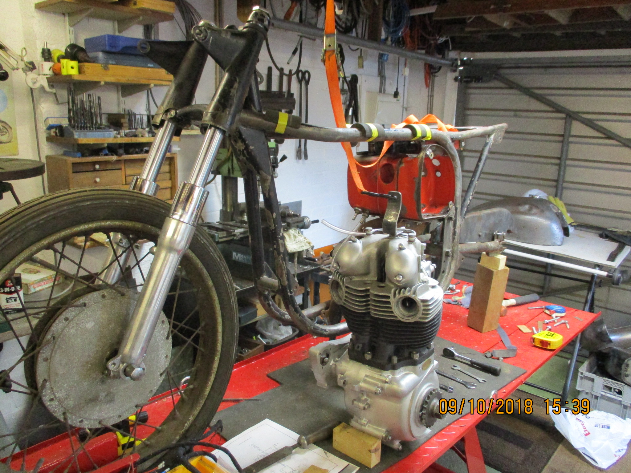

I have an RS Joist directly above it and when I put the engine in I just placed it on the lift alongside the bike then tied it to the joist with a ratchet strap through the featherbed. Then all I had to do was lower the lift away from the engine until it was at the right height to swing it into the frame then ease the lift back up and fit the bolts. Simples as they say
The photo's were just a trial assembly prior to the respray.
