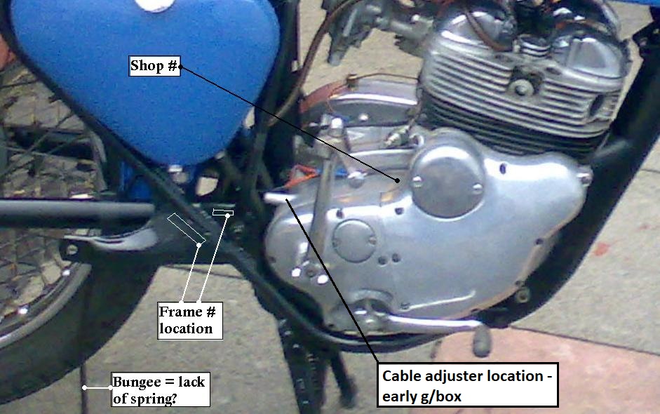

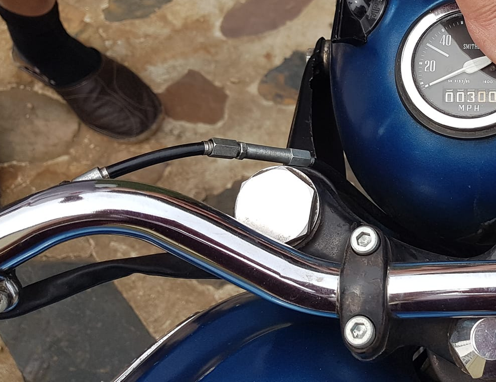

First 2 photos photos show the 106838-on (And all Electra) setup.
The 3rd photo shows the cable entry into the box on earlier Jubilees & Navigators. The cable is not present in the photo, but you can see how more awkward it is. Its lower down, points backwards and is obscured by the frame - hence they eventually moved its location up a bit, and pointed more upwards, whilst the adjustment was moved to the handlebar end.
