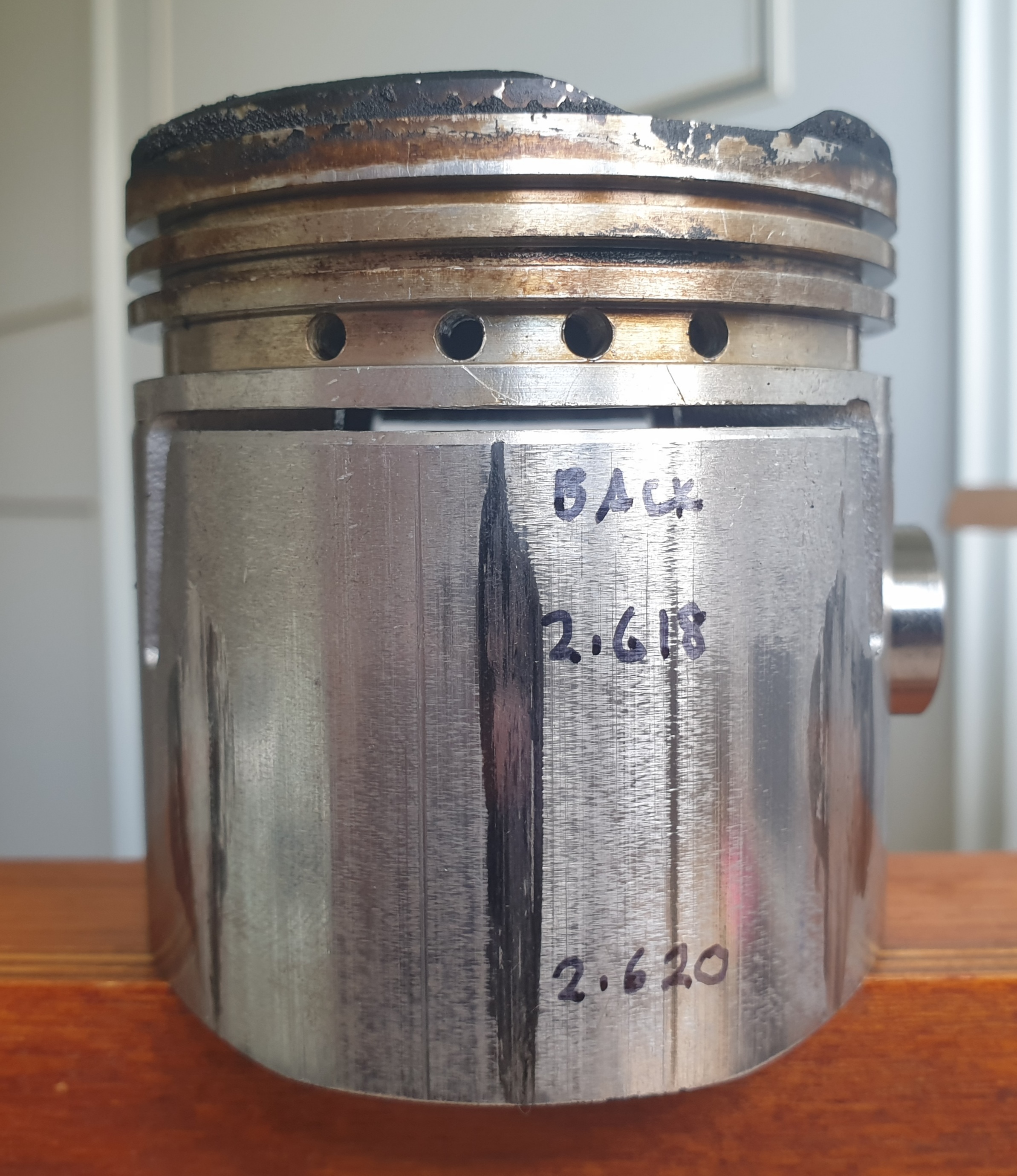

That is insufficient clearance, was the bore checked with the piston that will actually go in it. Also wise to look for the things you can't see, there is no sign of oil failure or overheating, so it can only be incorrect clearance.

My first 88 had been used all round Europe for 10 years by the previous owner with no issues .I used it every day for 3/4 years including runs to North Wales Rallies fully loaded and cruised it at an indicated 80 mph. It was fast and reliable and was regularly revved to 7000 rpm. Its downfall came when at the end of a long fast run accross England to the lakes and a flat out down to London it overheated (fairing/ hot day), 95 mph and seized the drive side piston . I have worked on a couple more that did the same thing . No way did it have insufficient clearance from the factory and after all those years hard use. Overheated, with too hot oil it found the weakest point ,a piston the farthest from the pump. Solve the overheating and improve the oiling (and the oil) and it wont happen again. I do agree with Ashley that its really difficult to get carburation right without leaded fuel,and that adding clearance will make seizure less likely,but it will also give you piston slap,although the 88 seems to tolerate more clearance that the 99.
It cannot be too big, unless…

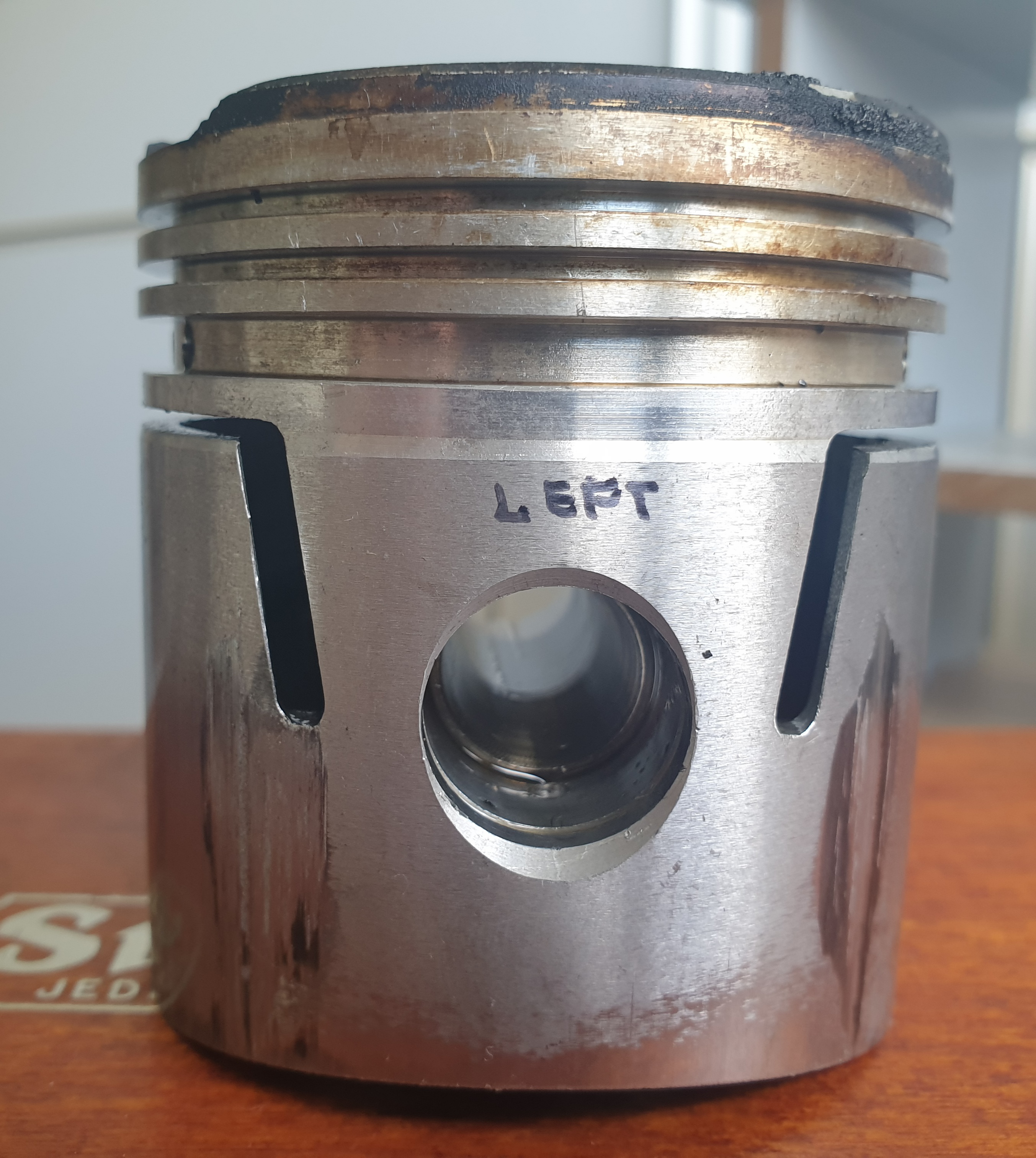

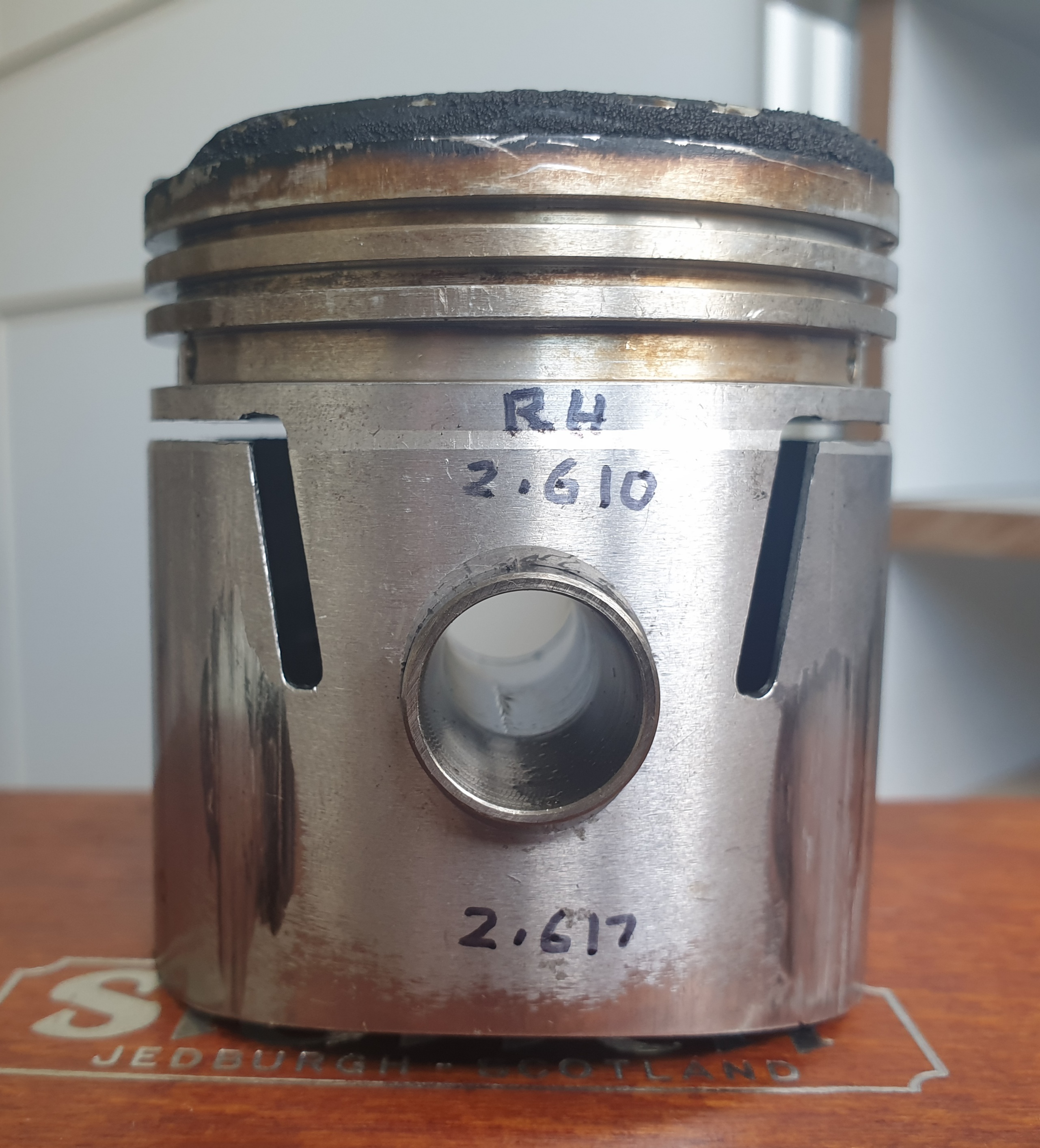

It cannot be too big, unless it has shrunk a lot. The lower skirt clearance at right angles to the pin has 0.009" clearance, and in line with the pin it is 0.004" less. The undamaged rhs piston has 0.006" clearance with the other dimension 0.009" less. The average diameter is close to the same for both, at 2.618". The bores are both 2.929". So the damaged piston is now more nearly circular.

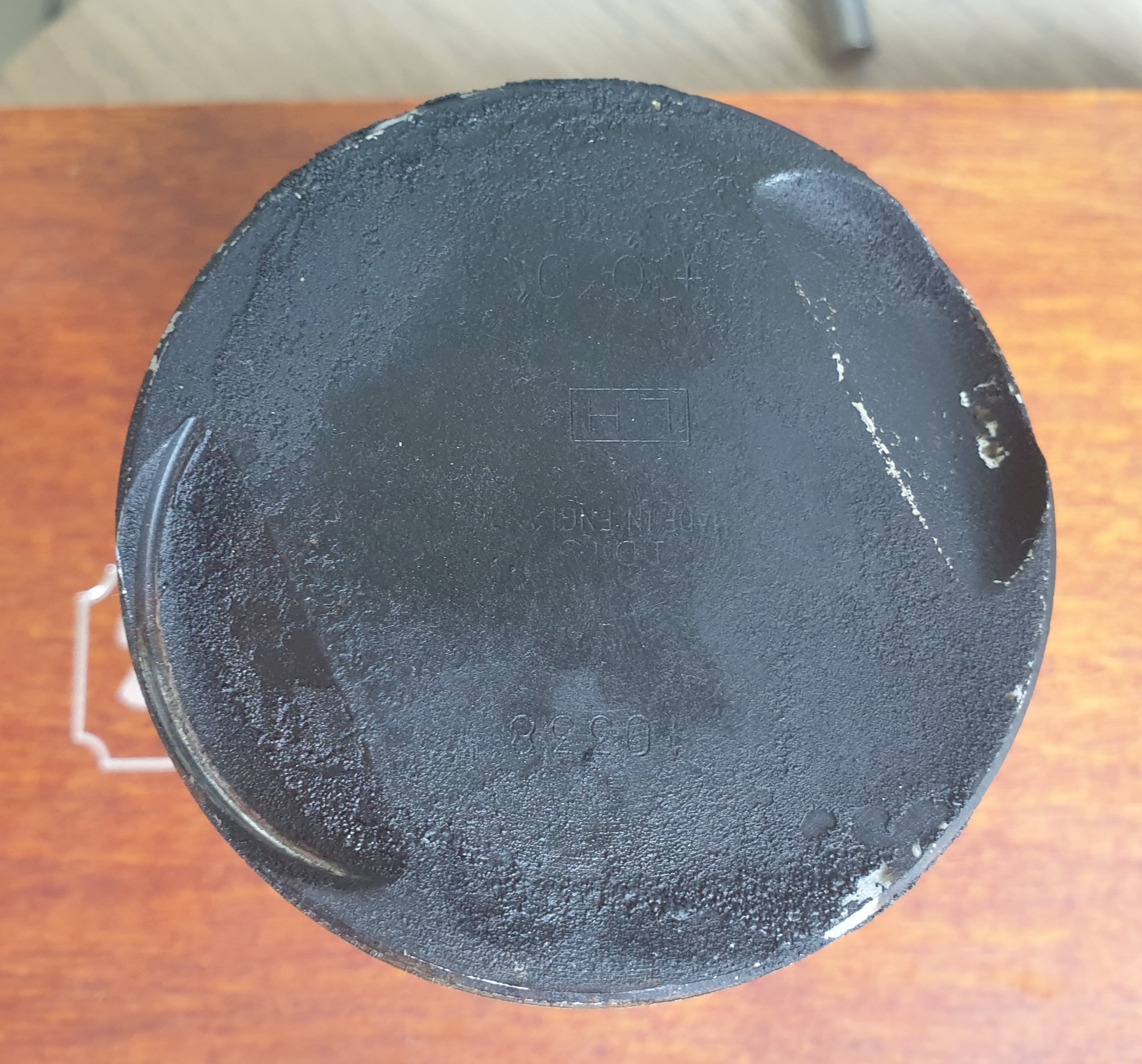

It would be good to see the piston from all sides including the inside including the pin, it has the some signs of a 4 corner seizure. When a piston with the right clearance warms up from pre detonation or weak mixture the parts of the piston with the greatest cross section of alloy expand the most and these area's seize. These areas are normally front and back of the gudgeon pin hence the term 4 corner seizure. The amount of smearing of alloy on that piston is more than you would expect from a slightly tight clearance.

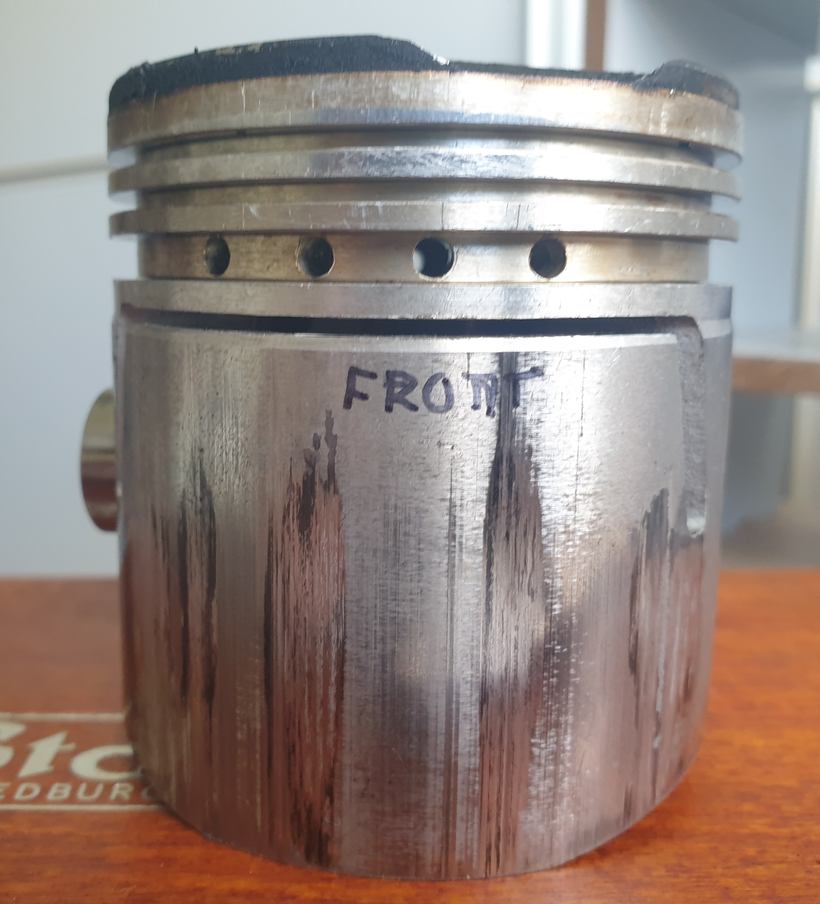

...and pic 5...
...and pic 5...this shows the back (thrust is it?). Skirt size 2.620 bore size 2.629.

Should have been plenty of clearance. Some build with 31/2 thou and get away with that . I would not build with less than 41/2 . That is assuming the piston is of the right alloy and correctly machined. I don't think they are correct. My suspicion is that they are pattern The finish is a bit crude. possibly the alloy is not low ex or the internal casting too heavy . Not good enough to really withstand the rigors of a Norton drive side. I would also check the fit of the pin. If very tight can cause problems for the piston. Should float when warm. Do you have twin carbs.? If all else correct the pistons should not sieze with your clearances although the motor would not be quiet. I have always preferred old stock or even SH orriginal pistons by a Brit manufacturer.If you decide to clean up and re-use I would set up with a slightly richer mixture on the drive side ,a slightly worn needle jet may provide that or one notch on the needle. Ever played Russian roulette !!

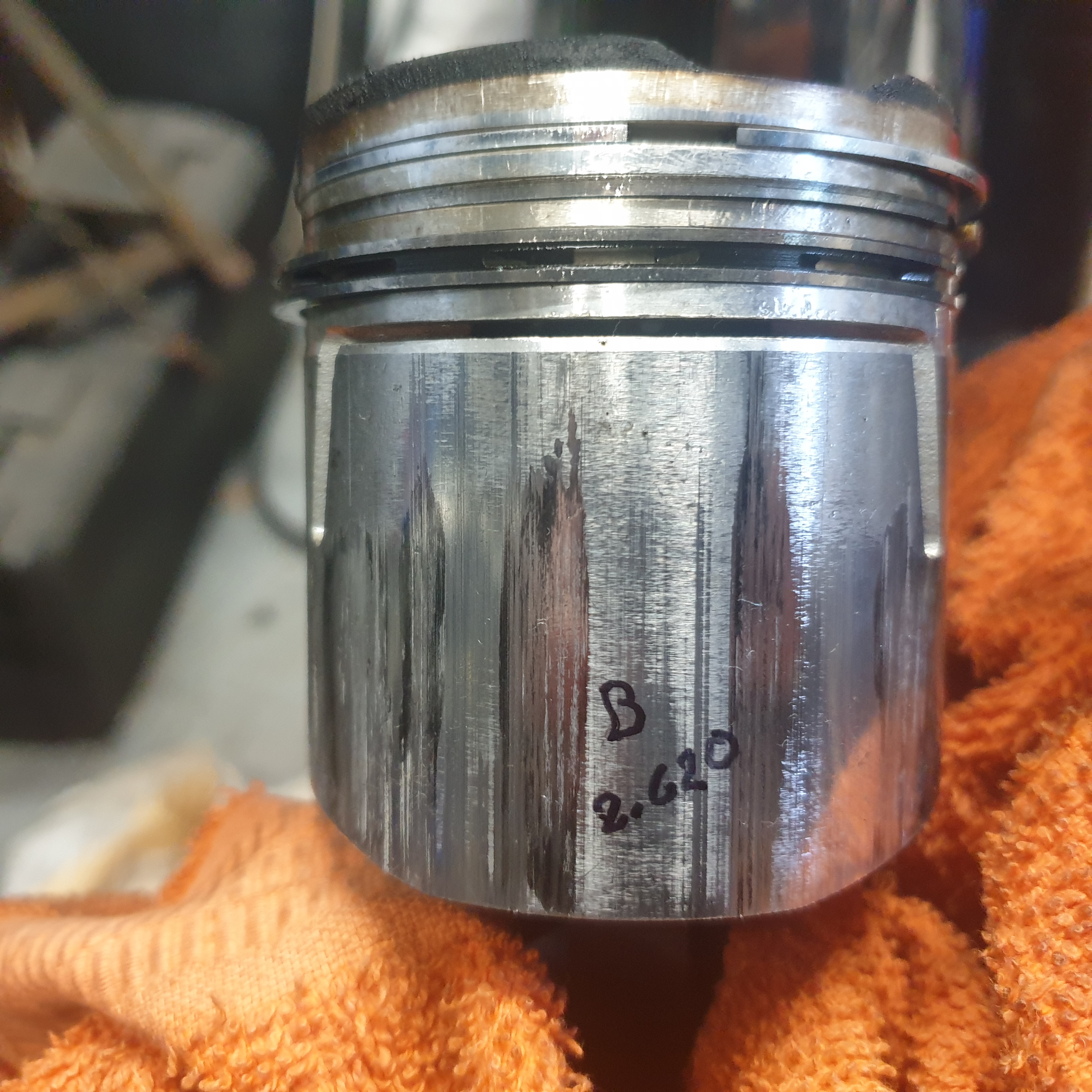

Thanks Bob. I shall reassemble. Just replaced the oil nipple and lip seal. I'm using a matching piston to the other simply because it has similar damage but fits better at 0.006 not 0.009. I'll use better oil. Checking mixture on main jet is then the issue. It could be too lean (too hot), or too rich (washing oil from the bore!). Maybe I'll try to measure cold oil pressure (although we all know that can fall to next to nothing when hot...)
If it goes wrong again, I'll have the engine out and drill the rod! And take at least 0.001 from the bore before fitting the nos Hepolite pistons I have. They are low compression but even so they should give 8:1 on the later 500 barrels.

The piston does not even look like it has overheated. If it was oil failure to the DS piston I would expect to see big end damage as well. Best bet is to measure the bore with 3 point mics throughout the bore, if it is good then junk the piston.

Thanks Ashley. I'm using a Mercer bore gauge. Looks spot on but of course it's room temperature. The piston is scrap...it was slapping before I stripped it down.
