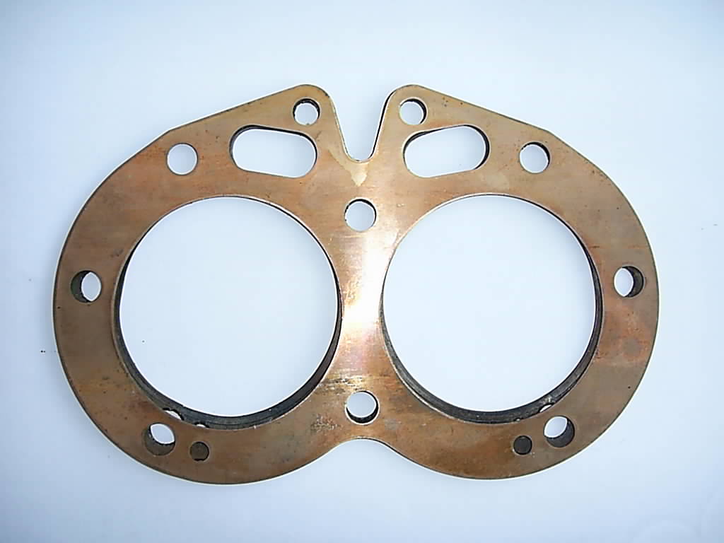

Attached somewhereis a photo showing a 750cylinder head gasket sitting on top of a 99 version. OK the 99 gasket is for a spiggotted barrel but as you can see, all the front holes are in alignment and the rear holes are not too far away from each other.

I don't think anyone who walks on two legs got the idea that a 750 Atlas top end will bolt onto the top of ANY 99 or 650 cases without major welding and re-machining being done to them.....but as usual AJD gave it a go......
