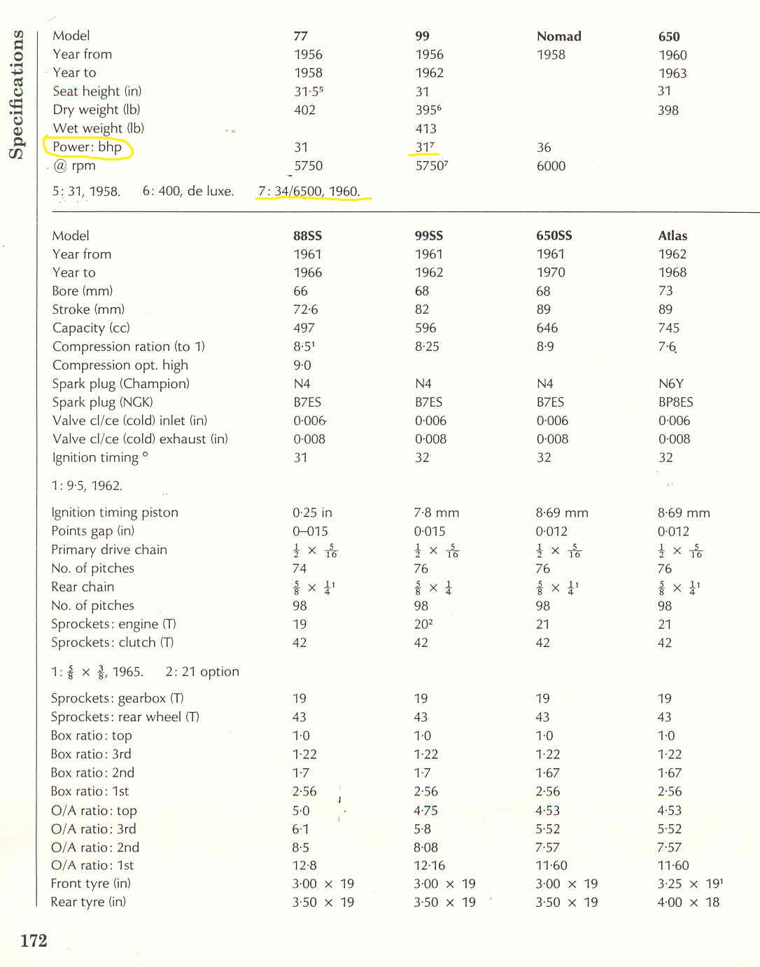

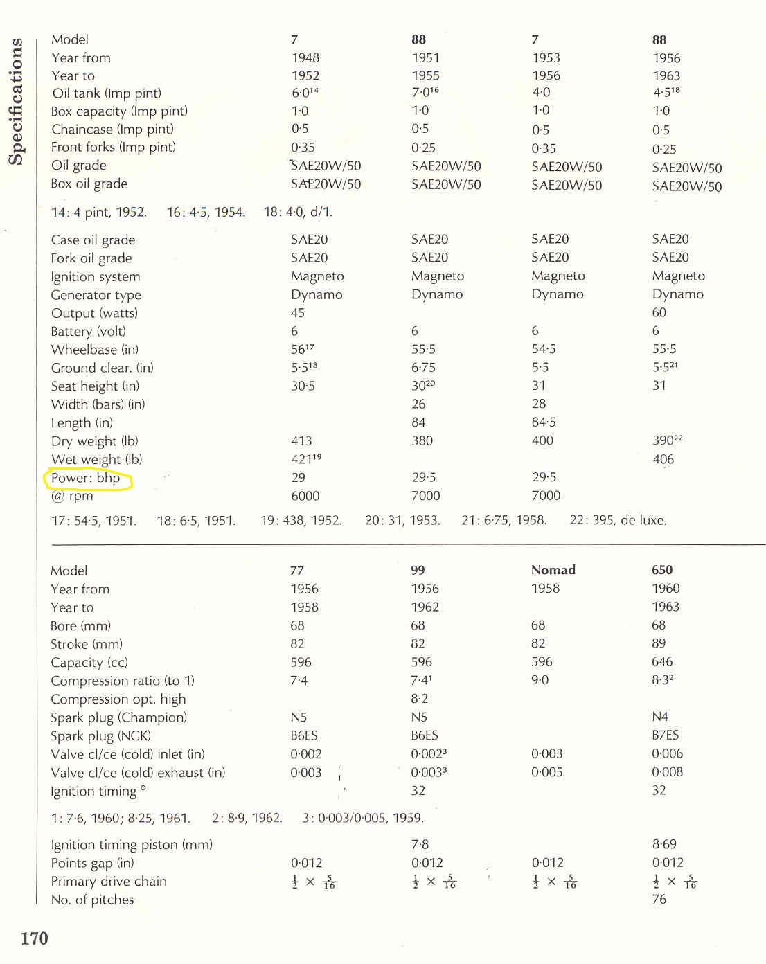

How powerfull of these models ? 88 = 29 hp and 99 =  32 hp ?
Depends which version, what revs you are prepared to give it.  And I doubt if standards of accuracy of 1950's dynamometers are the same as today's...if those are the book figures for an engine on the bench then those are the figures...
The SS versions were significantly higher - listed at 36 for the 88SS.  It would be interesting to know if anyone has risked testing one at full power at 7000 rpm on modern machinery.  I'm not lending you mine.
The 600 Nomads produced 36 BHP, but it all depends on what state of tune and components that you have in the engine.
My first Norton... looking forward to riding it!
The truth is that nobody can tell you for certain, the quoted figures look to be reasonable. Nowadays we tend to use a rolling chassis dyno and measure power at the back wheel which is less than that generated by the engine. Manufacturers were  prone to quoting best figures with ancillaries removed.
