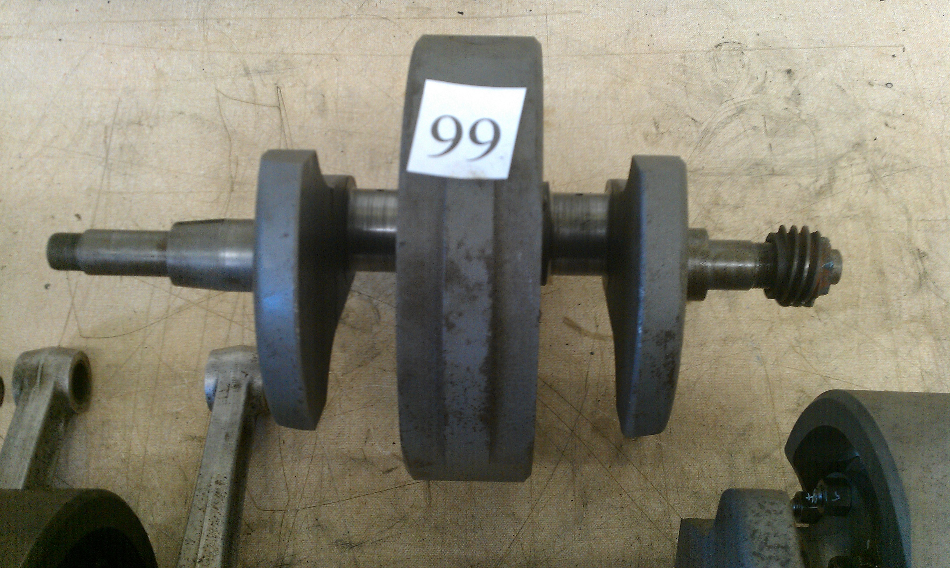

domi 99 crankshaft thread size
what is the thread size on a crank shaft on a dominator 99

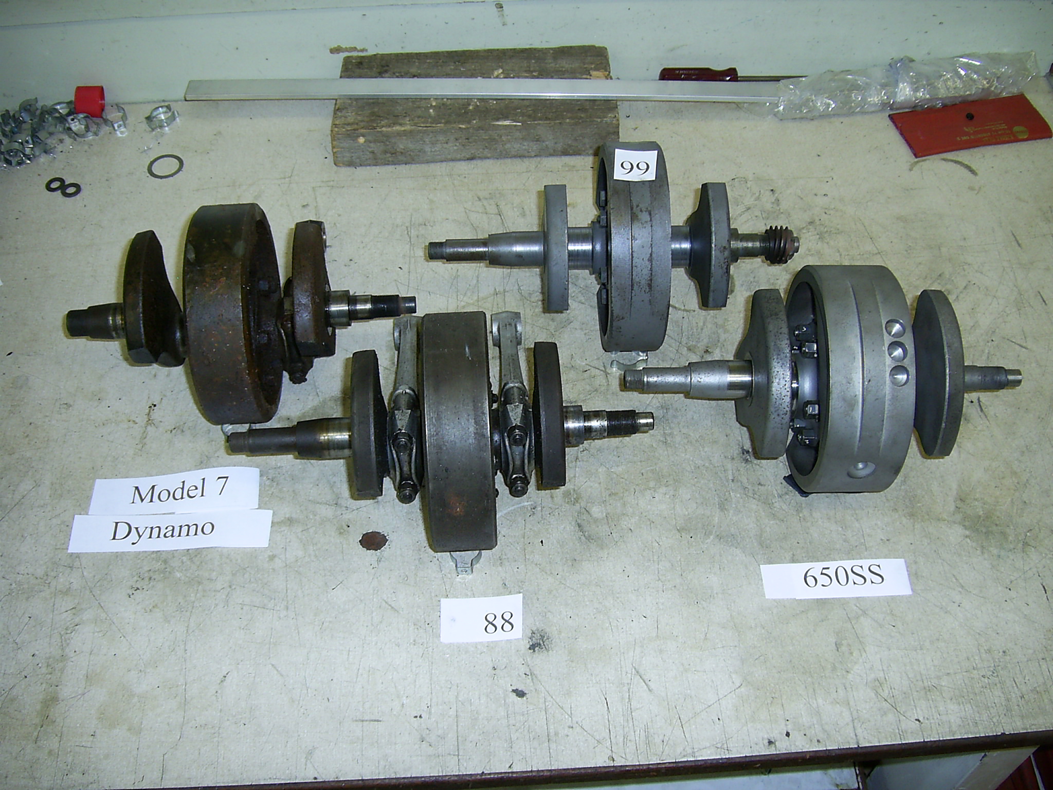

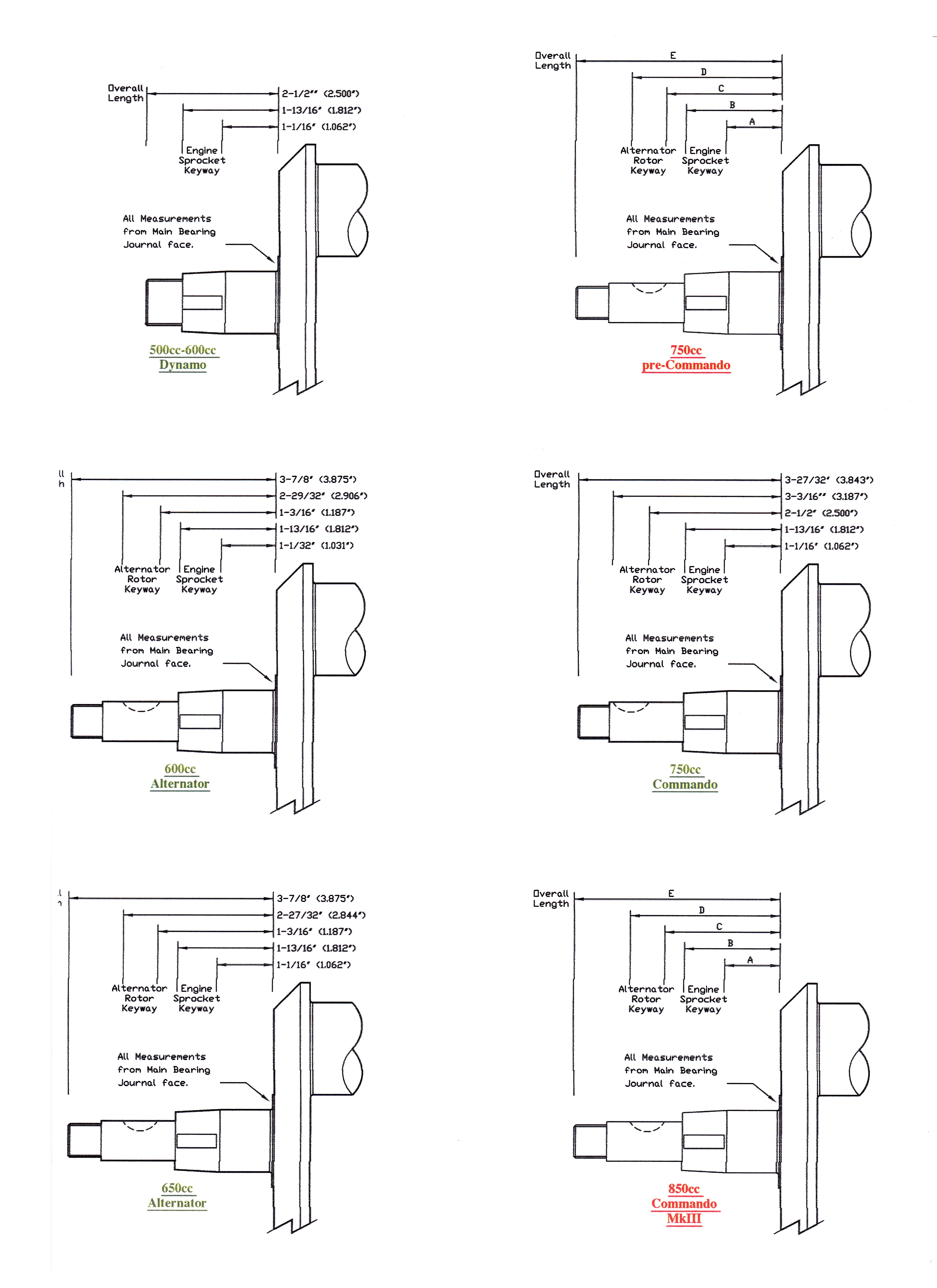

Dynamo or Alternator  crankshaft???
One is 7/8"and the other 5/8"......both 20tpi
In reply to by philip_hannam1
how do you tell ault or dynamo also is the thread unf cheers ed
As an addition to what Philip said - don't forget that the timing-side is a left-hand thread.  Good luck, Howard
I think that Dommies are 55 degree Whitworth form but Commandos are 60 degree UNF (form).
