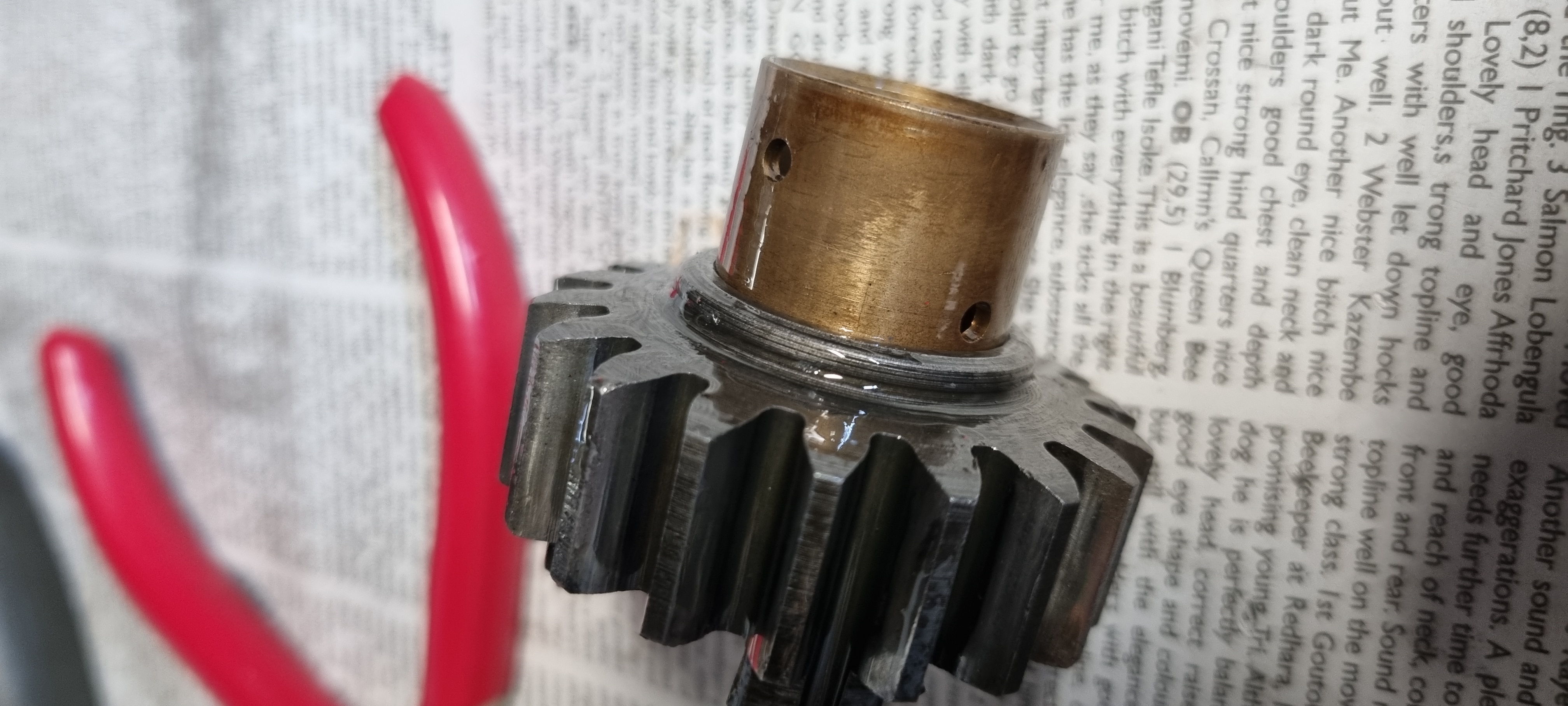

After Removing my Main shaft Free gear N8040  from my Dolls head, I noticed that theGear and Bush bush is an easy sliding fit in the gear pinion. Am I correct saying this should be a tight friction fit to the gear and sliding freely on the main shaft?
Garry
No it is a sliding fit, hence the oil holes.
