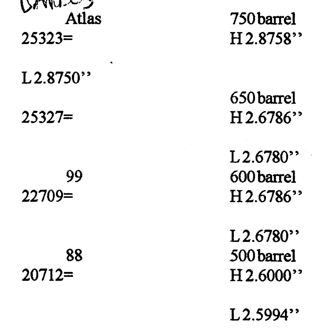

The attachment is from the original Dominator Service Notes and shows the respective deck heights in inches.
