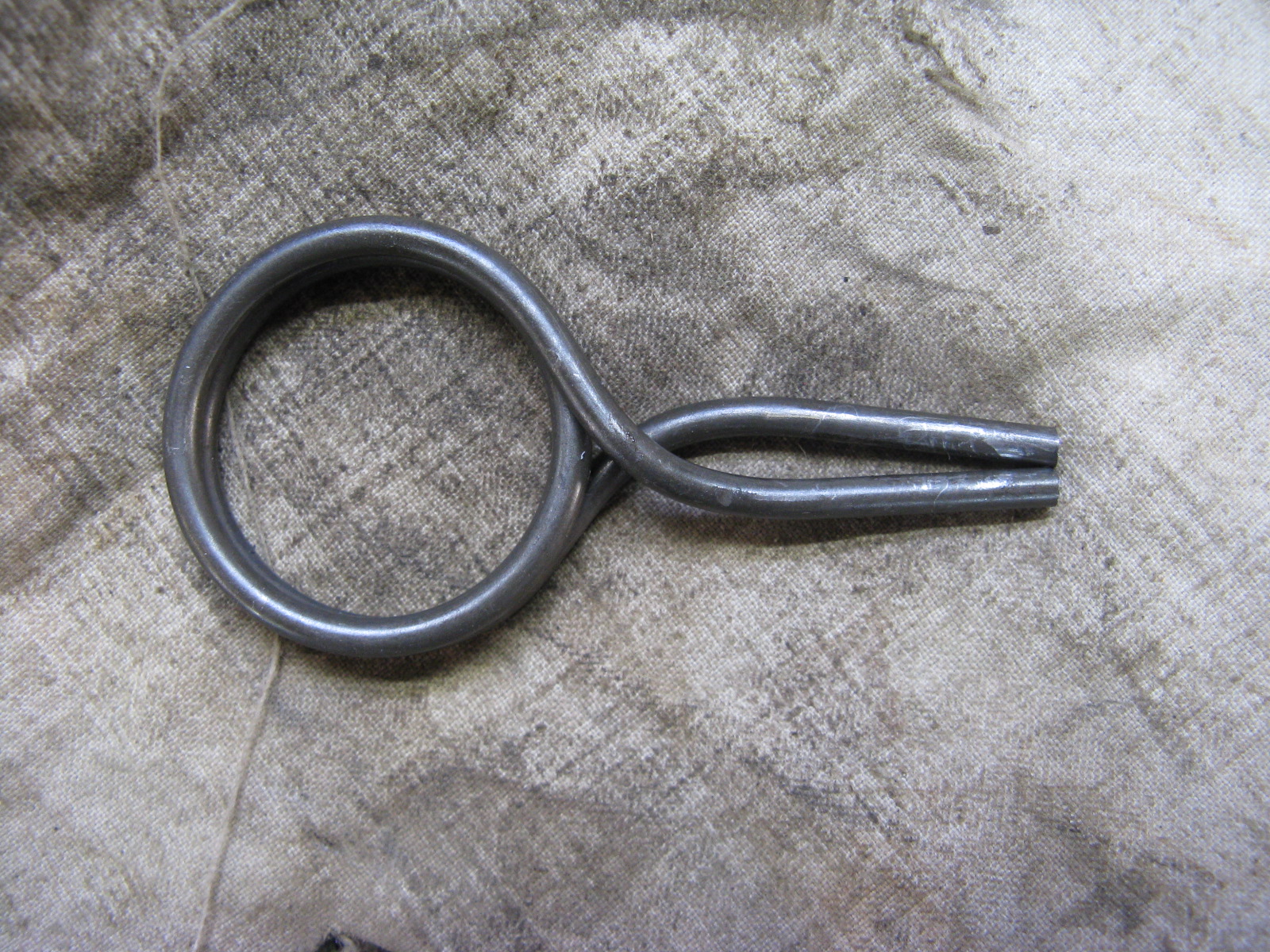

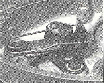

Naff gear selection, on these boxes, can be caused by poor assembly or broken selector springs.
The additional photograph files show the two spring to check for cracks or poor shape.

I would look at the Gearchange rachet spring tension. It is important that this is set up so there is a small movement of the gear selector pawl between the spring. You can look on utube to see how to set the tension.

Phils foto and script  could be used to determine that the internals ,cam plate ,selectors are working and pinpoint the issue ,probably the pawl or its neighbours in the outer cover.
