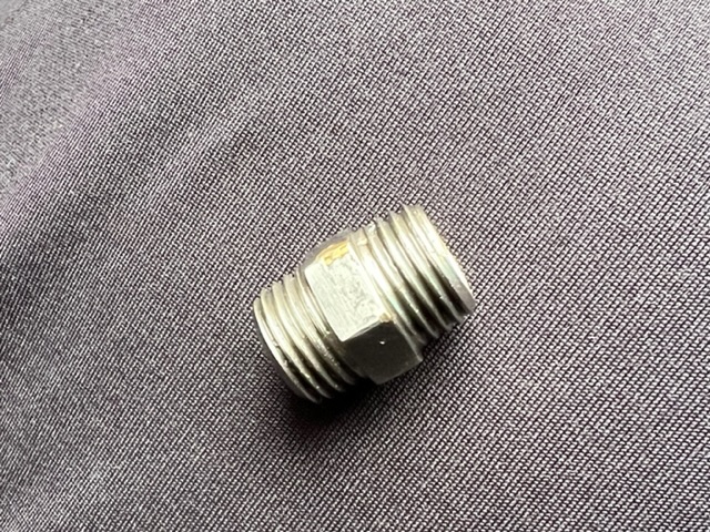

I am a new owner of a 1926 OHV 500 Norton. i want to check that the oil breather is correct as it has no ball or disc valve and simply vents via a pipe onto the primary chain. if anyone has a Model 18 or similar with the same breather I would love to know what it should be like.

Hi Folks, sorry have only just seen this . . . very rarely dial in here, but nice to talk to you all.
FYI - the One Way Valve talked about here looks similar to the 1/4 BSP breather as shown above . . . but was only fitted from (if memory serves me right, from about 33/34 onwards - and to my knowledge, always above the left main bearing housings.  Crankcases before this time did not have that type of one way valve - I have a set of early Inter crankcases (about 32) which do not have the one way valve . . . but has provision for a screw in plug in the side wall of the crankcase just above where the one way valve was later fitted.
I am not an expert on 1920's engines - but I know a clack valve type breather (valve?) was fitted on CS1's (and I think OHV engines) in the late 20's.  This was normally at the top of the crankcase behind the barrel (if memory serves me right), and had a small steel shim plate held against the hole of the breather, with a spring above it - then a chromed brass plug holding the spring down and securing a banjo.  Actually if you look at my RacingNorton catalog you will see I actually had the spring for that valve manufactured and is for sale, but as of now (May '24) have not got round to machining the actual brass parts of the valve (although I did do drawings if memory serves me correctly).
And yes - I do manufacture the later (main bearing) one-way valve, and two types of the original breather union (as well as SOHC and OHV engine oil pipe unions . . . all can be found on my online catalog: www.RacingNorton.co.uk.
