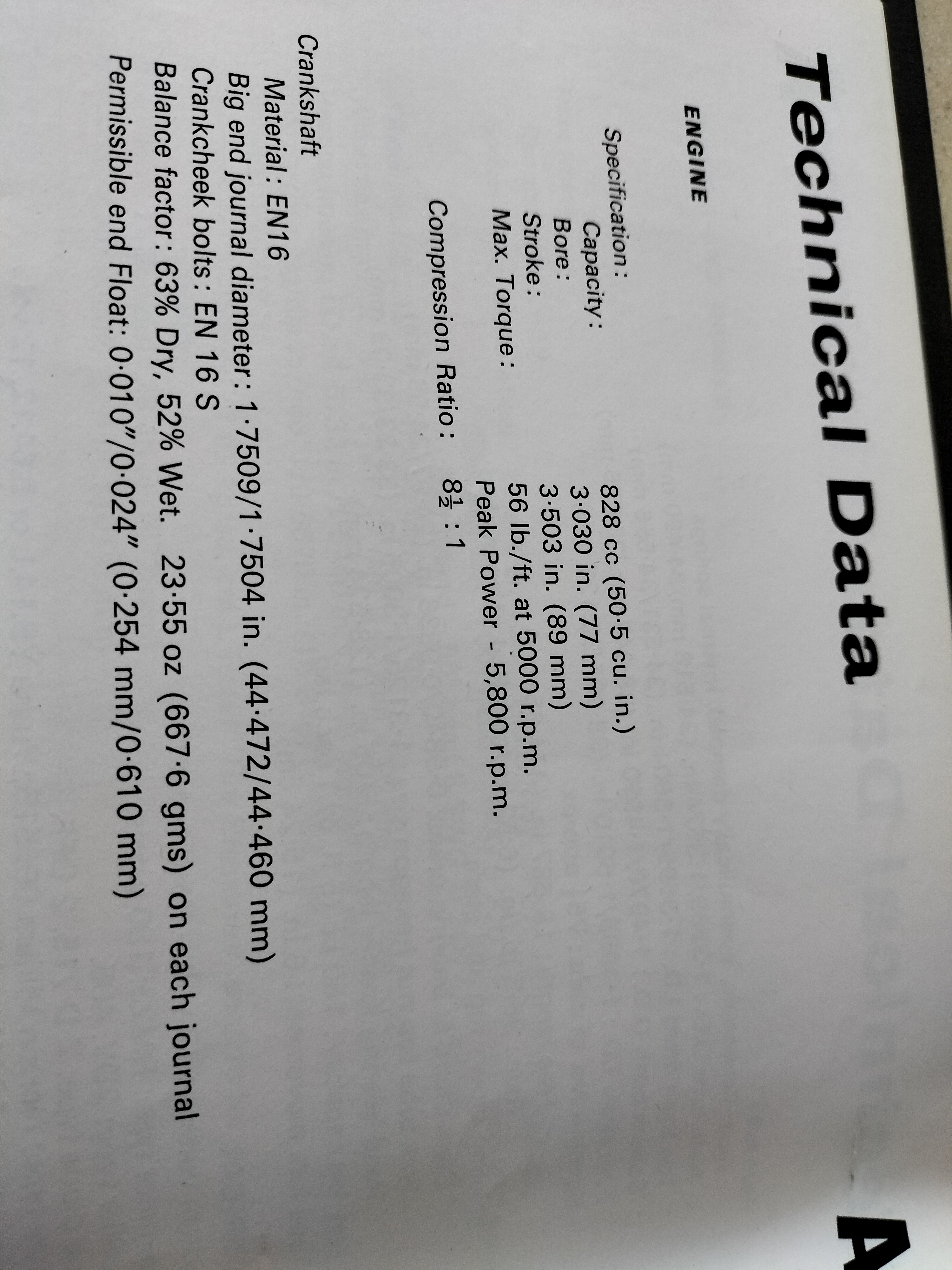

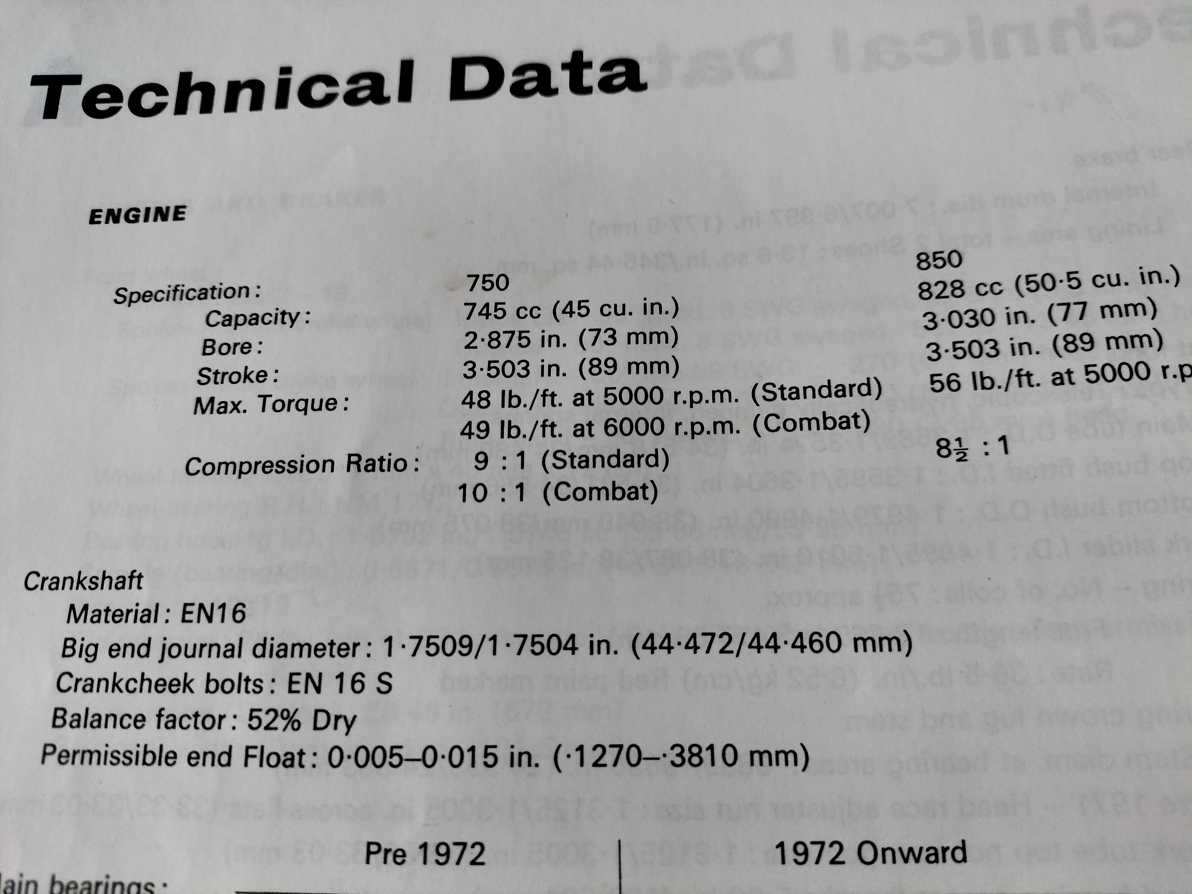

Just fitting an Alton starter to my 72 Combat only to discover that the crank has 30 thou end float. I have covered about 15000 miles since buying the bike with no problems. Should I stop and deal with this, I understand it should be no more than 12 thou.

As there hasn't been a response yet to your question, here's the information from the factory manuals.
Please note the different specification for the Mark 3 electric start model compared for the earlier 750/850's. Second photo is for the electric start models.
You can worry too much. I would just carry on riding it. It's clearly working just fine.
John Hudson reported that he often came across newly built Commando engines with up to 40 thou of end float in their crankshafts.
If the engine has twin roller mains fitted, the potential problem can be that the 6 start oil drive worm can push the crankshaft side-ways. This in turn can lead to premature wear of the crankpin corners if the big-end shells rub against them. Also  the engine can emit a clicking sound if the inner roller race strikes the rollers themselves. This sound is similar to a loose pushrod end or worn conrod small end.
My first Commando which was an original low mileage bike way back when, had around 40 thou end float but it never caused any issues. I fitted an Alton to my present Mk2 years ago and don’t remember even checking the end float. Looking through my Alton instructions I can’t see any mention of checking end float unless this is a recent update, therefore I wouldn’t think you have anything to worry about with your bike but why not check with Alton to be sure anyway.

Many thanks gentleman for your advice, I shall leave well alone. The thoughts of having to strip the engine just to put a shim in is the stuff of nightmares.
