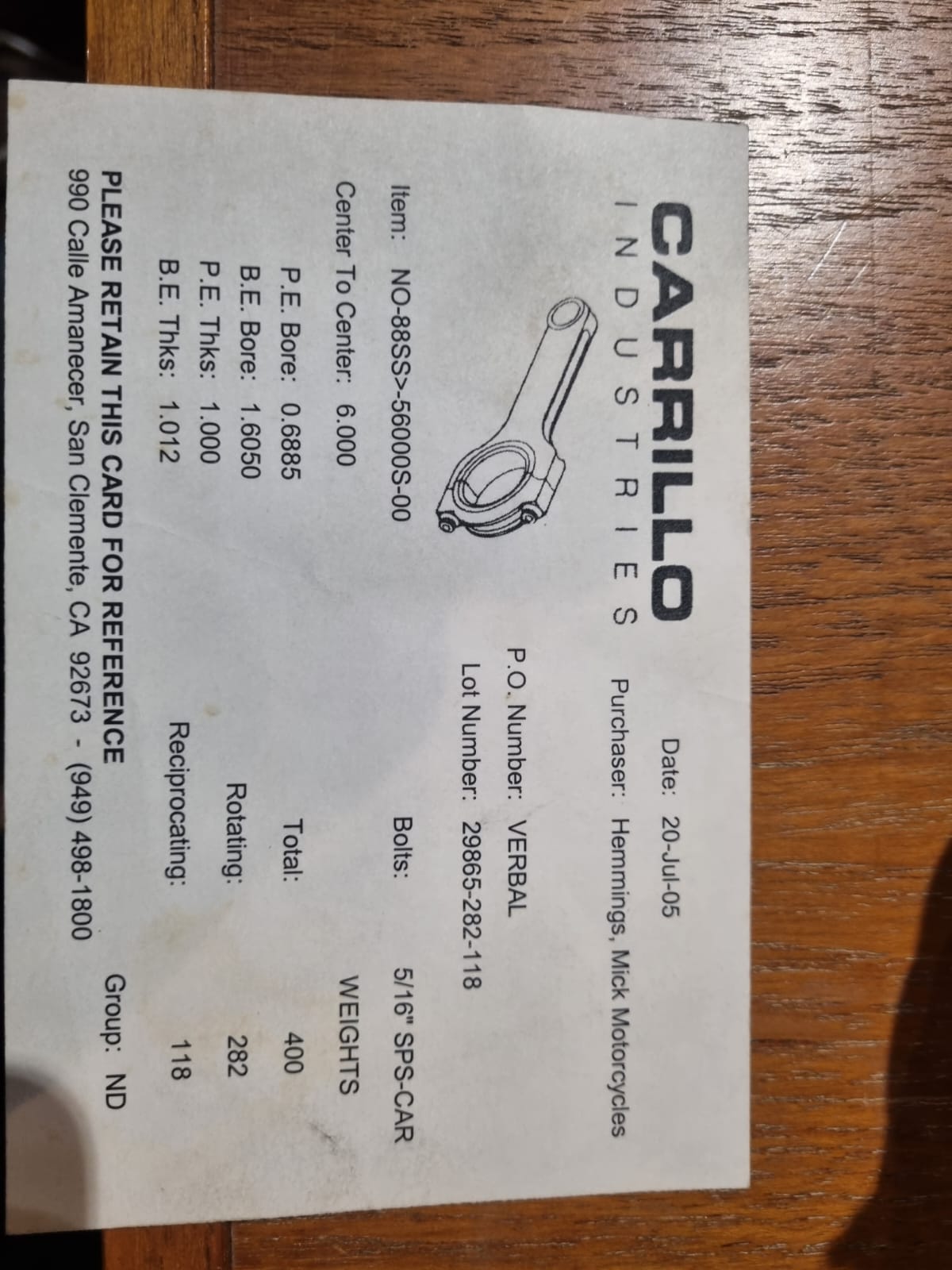

Looks like 153mm or perhaps…
Looks like 153mm or perhaps 6 inches would be likely , back in the days of "proper" measurements.
After much searching thro…
After much searching thro the records I think they came from Norvil It was a long time ago!

The 1.6050 measurement is…
The 1.6050 measurement is helpfull for checking used rods for ovality , I suspect these rods used std Norton type shells.
