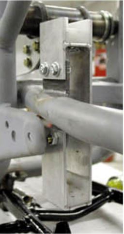

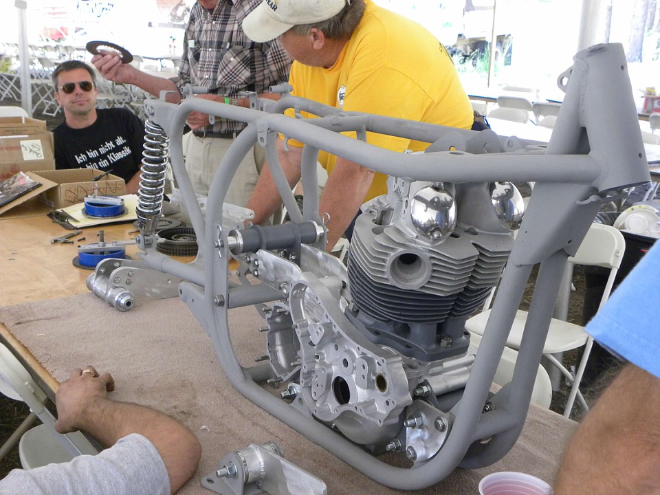

Interesting lash-up. I would cut and shut the Commando plates and use Silentblock car bushes from a car suspension. Landrover parts spring to mind. Done it once, use stiff bushes to stop the chain pulling too much. The pictures show a bad top mount which will shear those small bolts. You want to lift the plate up higher so that the mounting goes through it. The chain guide gives me the shudders. What is it for? When the chain breaks and wraps round it I reckon at seventy MPH you should get across the Grand Canyon. The first Norton in space, eat your heart out Elon!

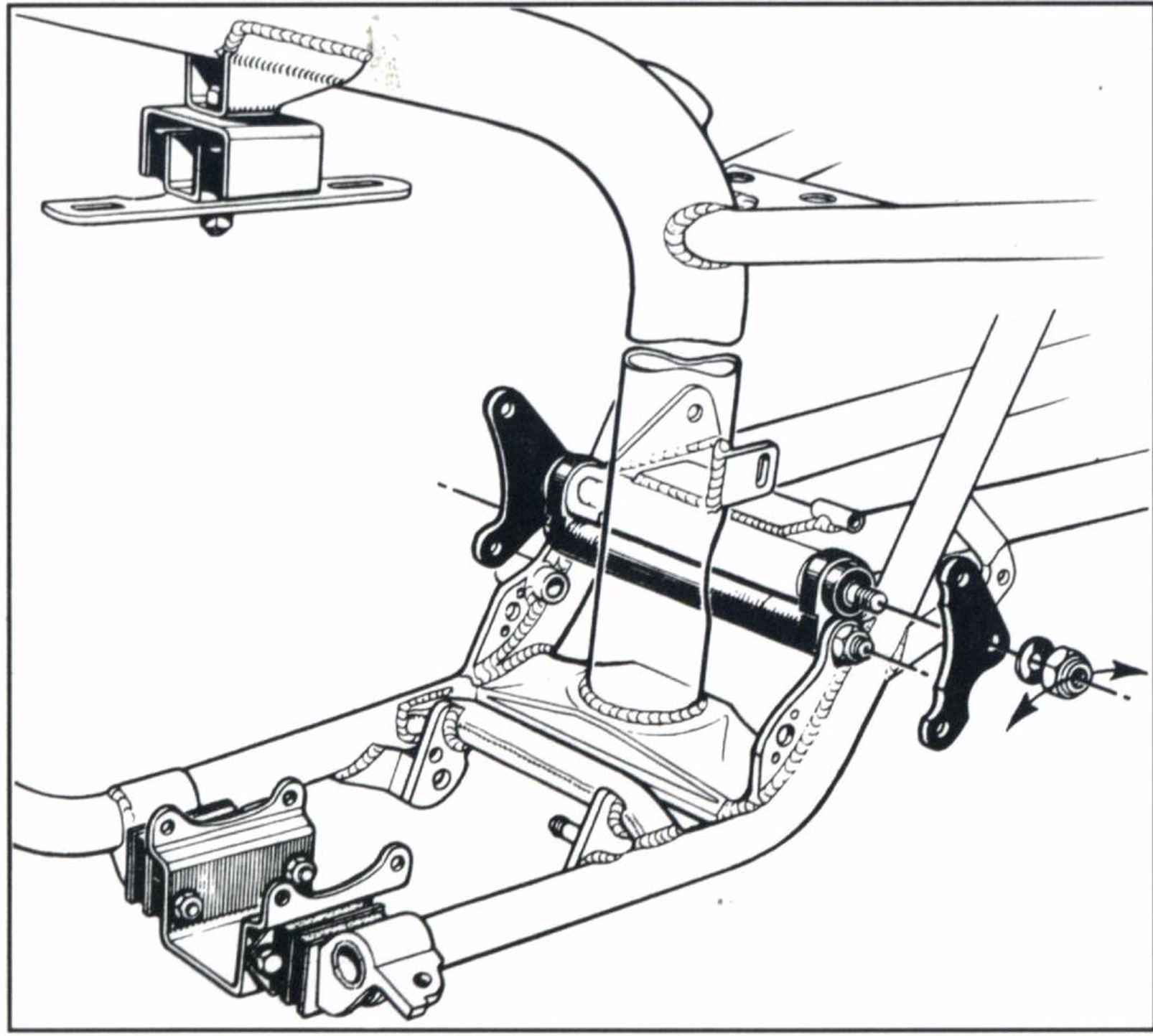

I’m pretty sure primary belt drive as currently used on bikes would not survive just engine rubber mounting. The late Triumph had whole engine and partial swing arm rubber mounted from the drawing shown.
