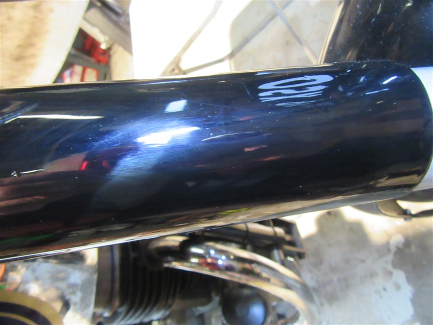

Fork shroud on my little BSA. What look like marks are in fact just reflections. Painted with a 2" brush from James Lister which cost a couple of quid.
painted shroud

50 years ago Radco may have been right, but modern synthetic Sabel brushes load almost as good as originals. Temperature and not over brushing are key to a good finish.  Nice job Ian!
