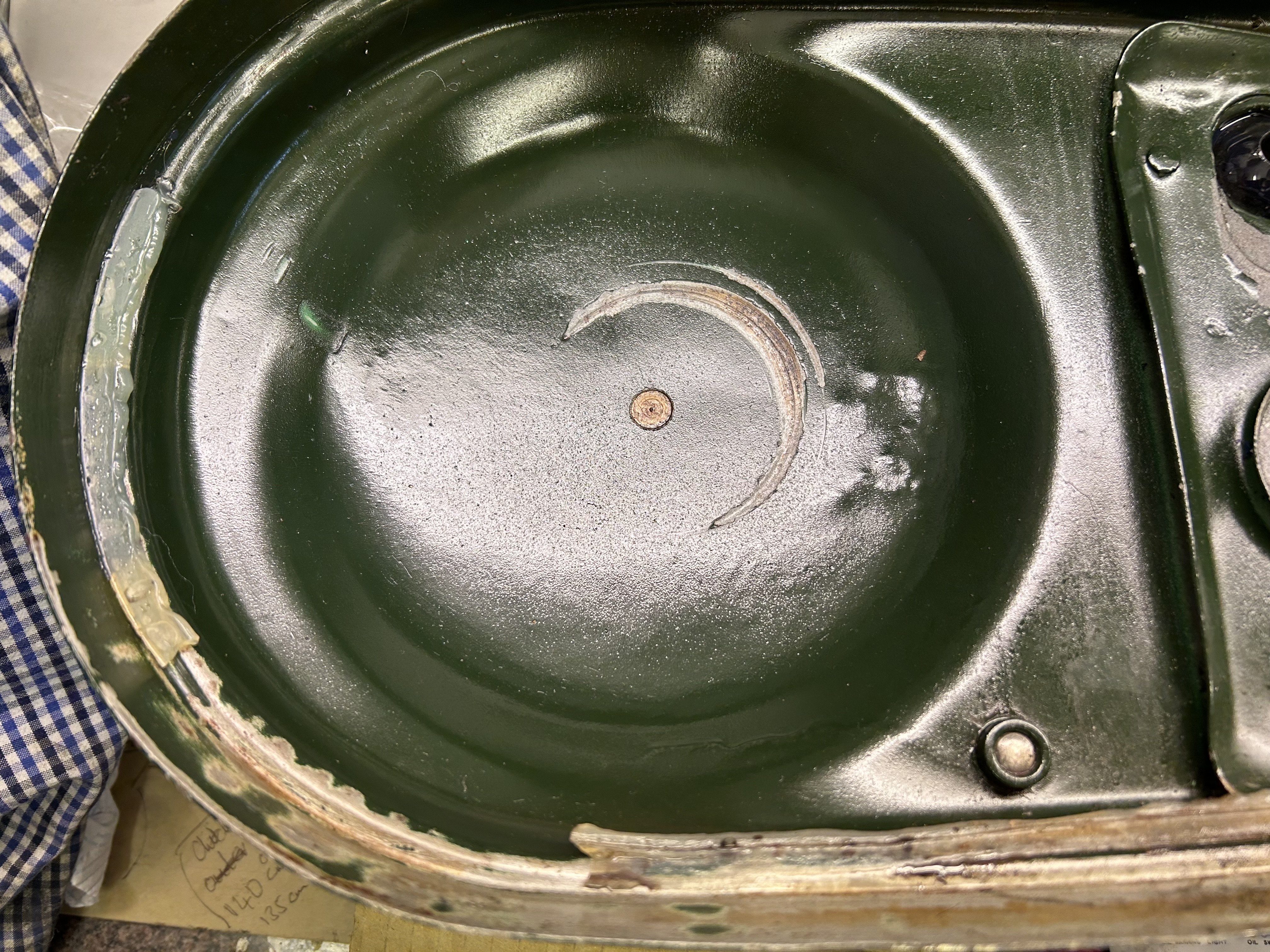

.. is that the new pushrod wasn't hardened and is rapidly wearing away. If the mainshaft nut has come loose you would be able to move the whole clutch assembly in and out.
Thanks Ian - the clutch hub…
Thanks Ian - the clutch hub assembly can be moved in and out by I suspect 1/8 inch or slightly more so I suspect Stephen's point about it being loose might be right. I'm going to strip out the the hub and have a look. Out of curiosity- should there be any in and out play at all? If not then will it always be a loose clutch nut at fault?
There shouldn't
be any play on the clutch centre but the outer may move slightly on the rollers that it spins on when the clutch is disengaged. Is your play with the clutch assembled and tightened down? If so, would suspect what Stephen suggested.

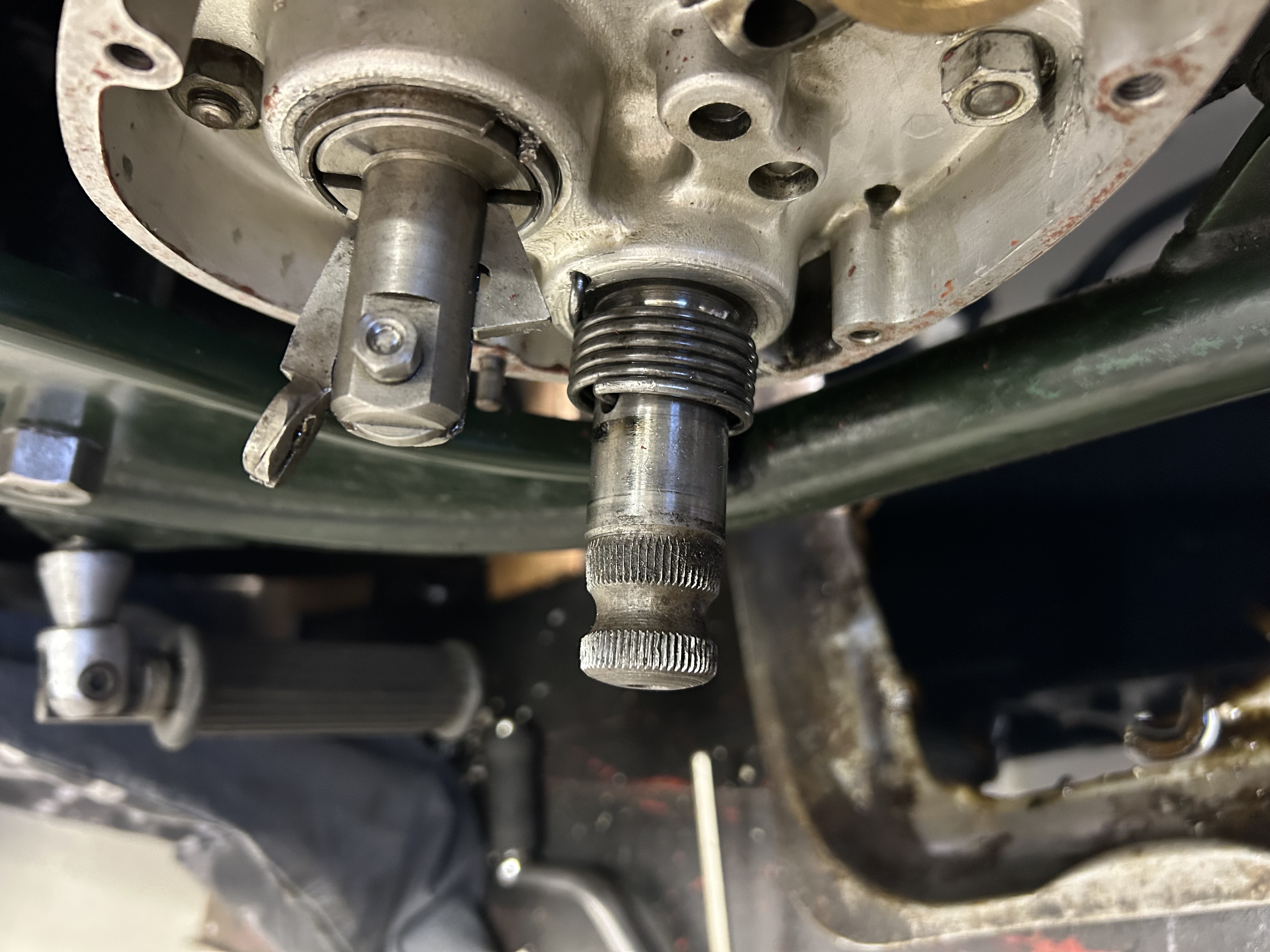

Thanks Jan, out of curiosity…
Thanks Jan, out of curiosity- how would I know it's the right length for my set up? At present it's 2mm proud of the inner drum
when the arm (the opposite end of the rod) makes contact. See picture

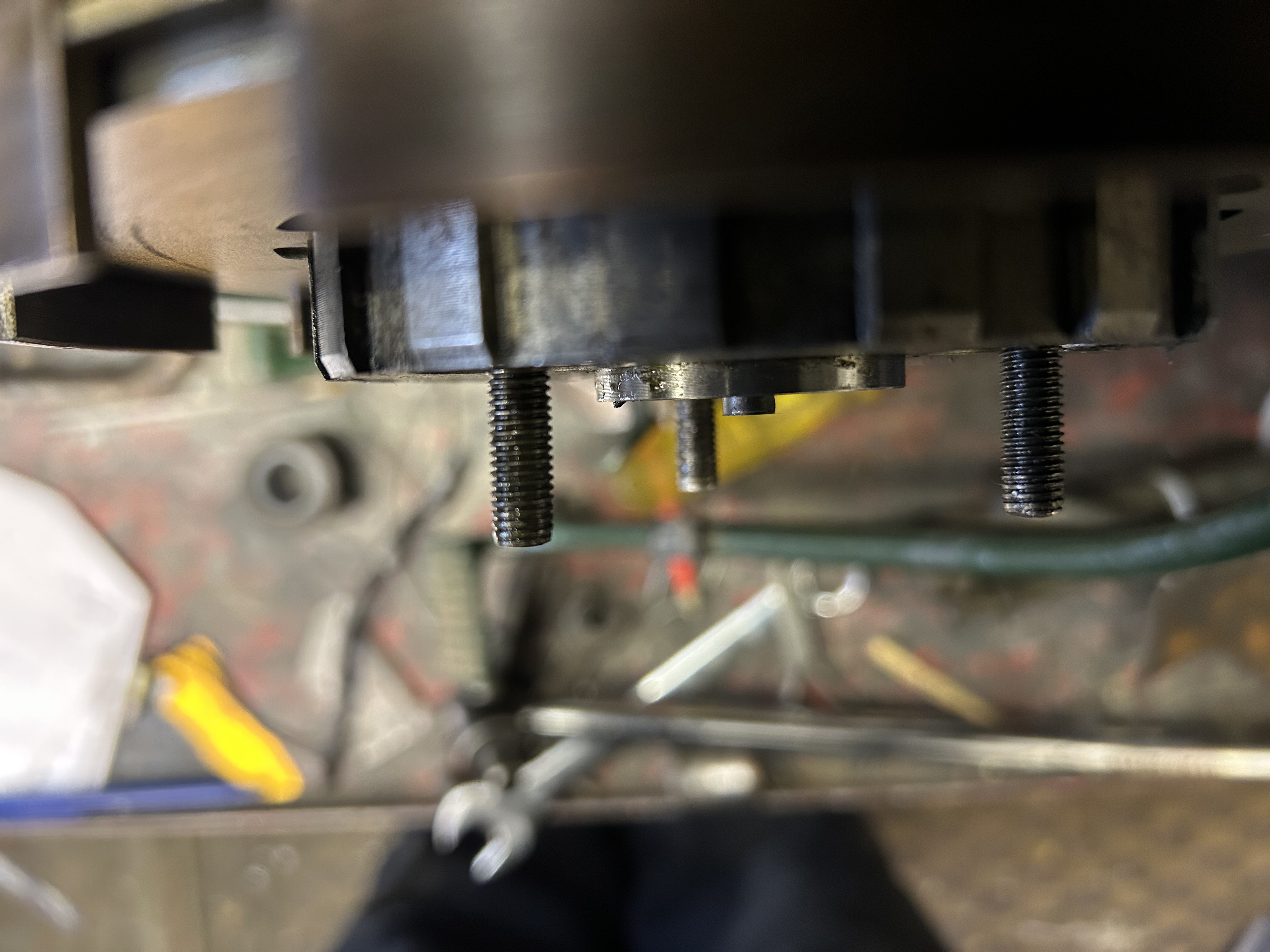

Tony,
My ES2 is a 1956 with a lay down gearbox and is very different from yours but,
I was under the impression that the change to the AMC gearbox had an adjuster on the clutch cover. The round plate that screws onto those 3 quarter inch studs in your photo. Could be this needs screwing in ?
Or and this is a big guess, the previous owner put a ball bearing in the adjuster and it has fallen out when you pulled it apart?

Thanks for your help Don - I think I'm getting there slowly. I've pulled the pushrod out and it's all there - no cut or ball bearing (yet)

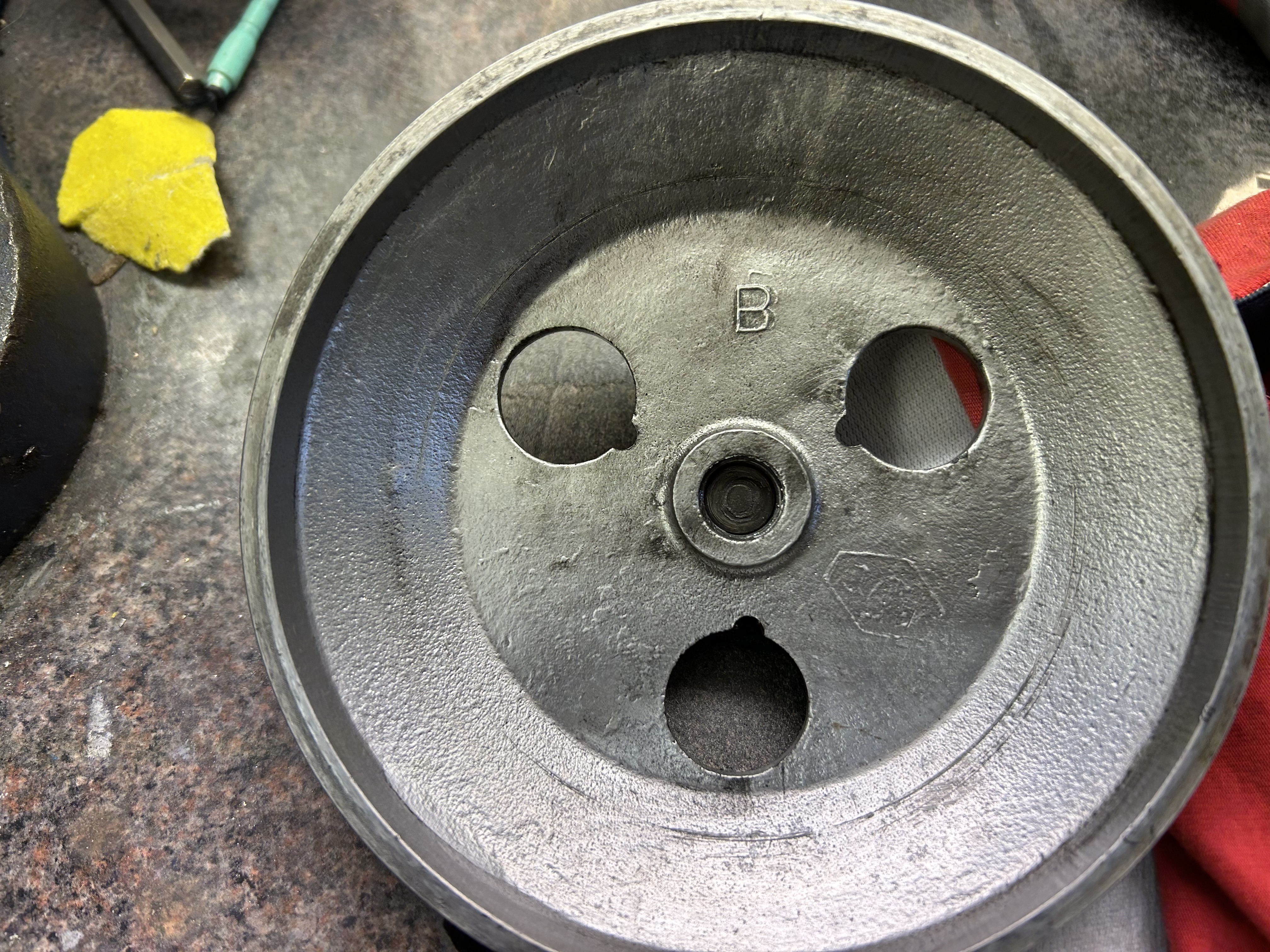

What I didn't include, in my initial post, is that the previous owner also purchased 2 sets of 6mm cork inserts Part no A2/395. I could see cork sections in the initial plate that also forms the toothed sprocket. Would those influence stack height etc?
My gut feeling is that you…
Assuming you have the right number of plates (If my memory serves me the M50 has a pair less than the ES2?) My gut feeling is that you need to work on the push rod length, new plates and cork inserts will alter the stack height. I assume your clutch has the aluminium pressure plate with adjuster screw and lock nut in the middle? Have you tried screwing it in as far as it will go - if necessary without the lock nut and see if you can get a working clutch - if you can you'll get an idea of how much short the rod is (As it happens RGM sell various length rods, they list the length and they are not expensive, if necessary buy one that's too long and cut it to size). If its just a few millimeters then a ball bearing may give you the length you need, but you'll need to cut the rod to be able to insert it, just remember that if you want to get it out again then you may have to lean the bike over so it rolls out! If your clutch has the steel pressure plate then that removes any option of adjustment so you'll need to get an aluminium one with the adjuster, they are easy enough to find - I might even have one somewhere! But note, I think there are different aluminium pressure plates to add to the mix! Andover Norton has (some?) of them listed

Hi Dan, I've screwed the…
Hi Dan, I've screwed the adjuster, right up, on the pressure plate and I've got a clutch action with a 1/4 of play. What I haven't got is any adjustment on the gearbox casing end as that's out to its limit. I ve had a look the rgm listings and the most are for slightly smaller or the same. My plan is to cut the existing rod in half and add a ball bearing (or two?) and then see if this gives me some adjustment back at the gearbox end. A couple of questions - my rod and those that are listed refer to them being case hardened. I've no way of doing that - will that be ok?
Also, my ball bearings are 1/4 inch (head race). Are 1/4 going to be ok as I'm mindful that they're slightly larger than 6mm?
I've added a picture of the type of pressure plate I have.

The one thing that springs to mind is the clutch nut may have come loose? This has happened on my 56 model 50 and others and the symptom is similar.
If it comes off altogether then the end result is potentially damaging as the clutch drum wears into the primary case or drops off altogether.
You'll have to check by removing the primary case cover.
