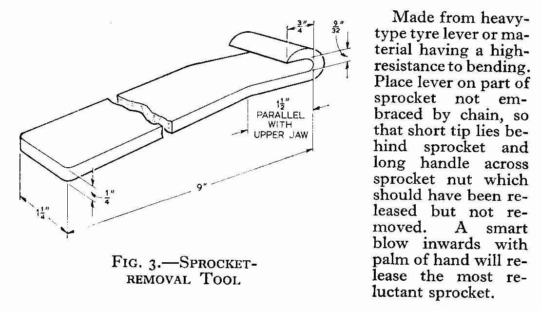

Can anyone advise me how to get the camwheel sprocketoff without causing me any more stress.
The magneto sprocket popped off nice and easy with my sprocket removal tool, but there is not enough clearance arounf the camwheel sprocket for me to use the tool again.

Rob THANKS for that. Tool…
Rob
THANKS for that.
Tool made.
Works a treat.
BRILLIANT, now I can get on with fixing the problem ... me thinks
Best wishes
Ian
