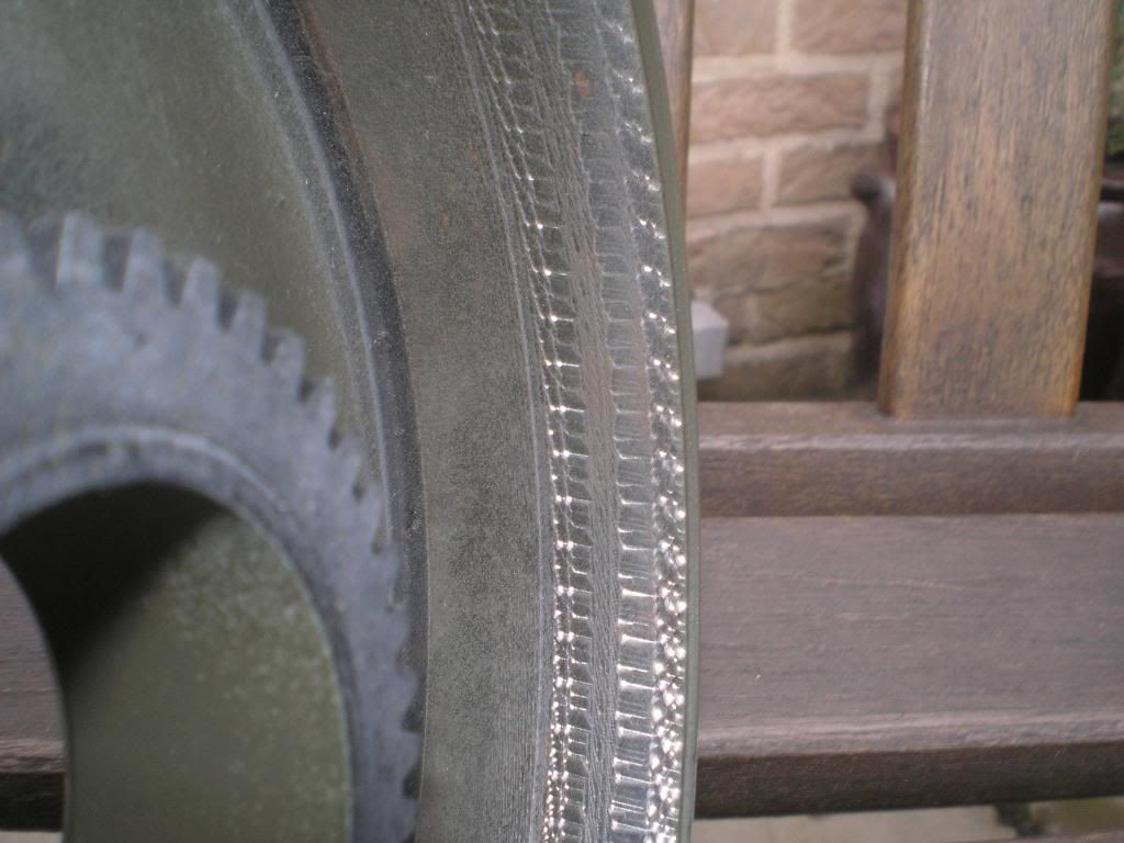

If you don't know what yo…
If you don't know what you're doing then don't try skimming a drum yourself. I thought that I had sufficient knowledgeable assistance, the proper tooling, and followed what seemed to be the correct procedure.
The tragedy is that it only had a bit of surface rust and some light scoring and I wanted the brake to be 100%. I should have left it alone.
The drum began to ring like a bell as soon as the tool touched it and dragged it straight into the surface. A lesson learned. Enthusiastic amateurs can't always do everything they put their mind to...

an old toolmaker told me if you get ringing like this you should tie rag around the outside soaked in water and it will stop it resonating! regards nick
That sounds like a good id…
That sounds like a good idea, Nicholas. I think that it was the resonance that did for it.
The drum was pressed onto a mandrel and well supported. I had thought that a detachable drum would be straightforward but it seems that a built up wheel might be less of a problem, assuming the lathe is big enough.
