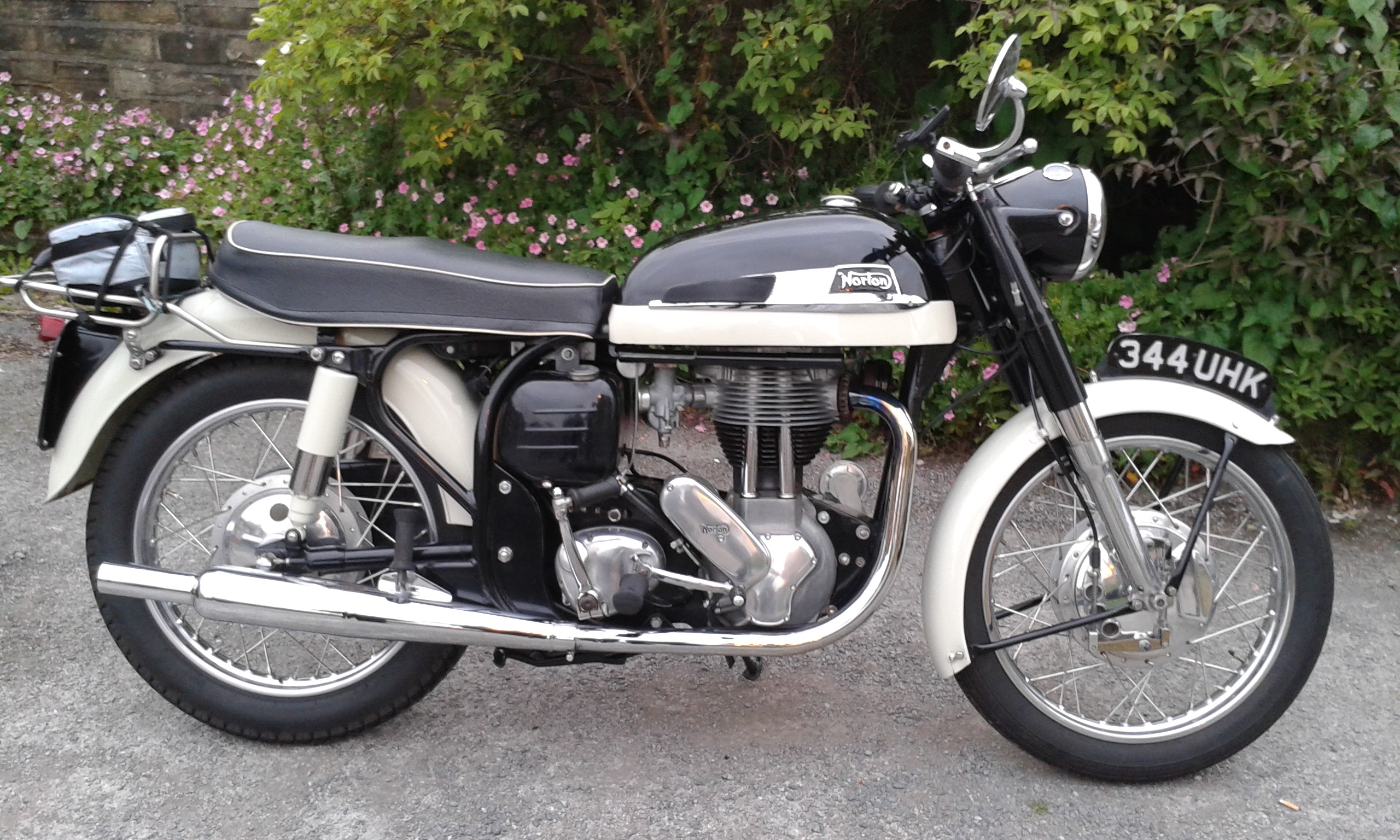

avon speedmaster mark2
I have one of these fitted to the front wheel of the es2 and a Dunlop gold seal k70 fitted to the back wheel...…… no coding is on either of the tyres although they both look in good condition and ride well
can anyone tell me when the avon speedmaster mark 2 went out of production as this will give me some idea as to the age of the tyres.
