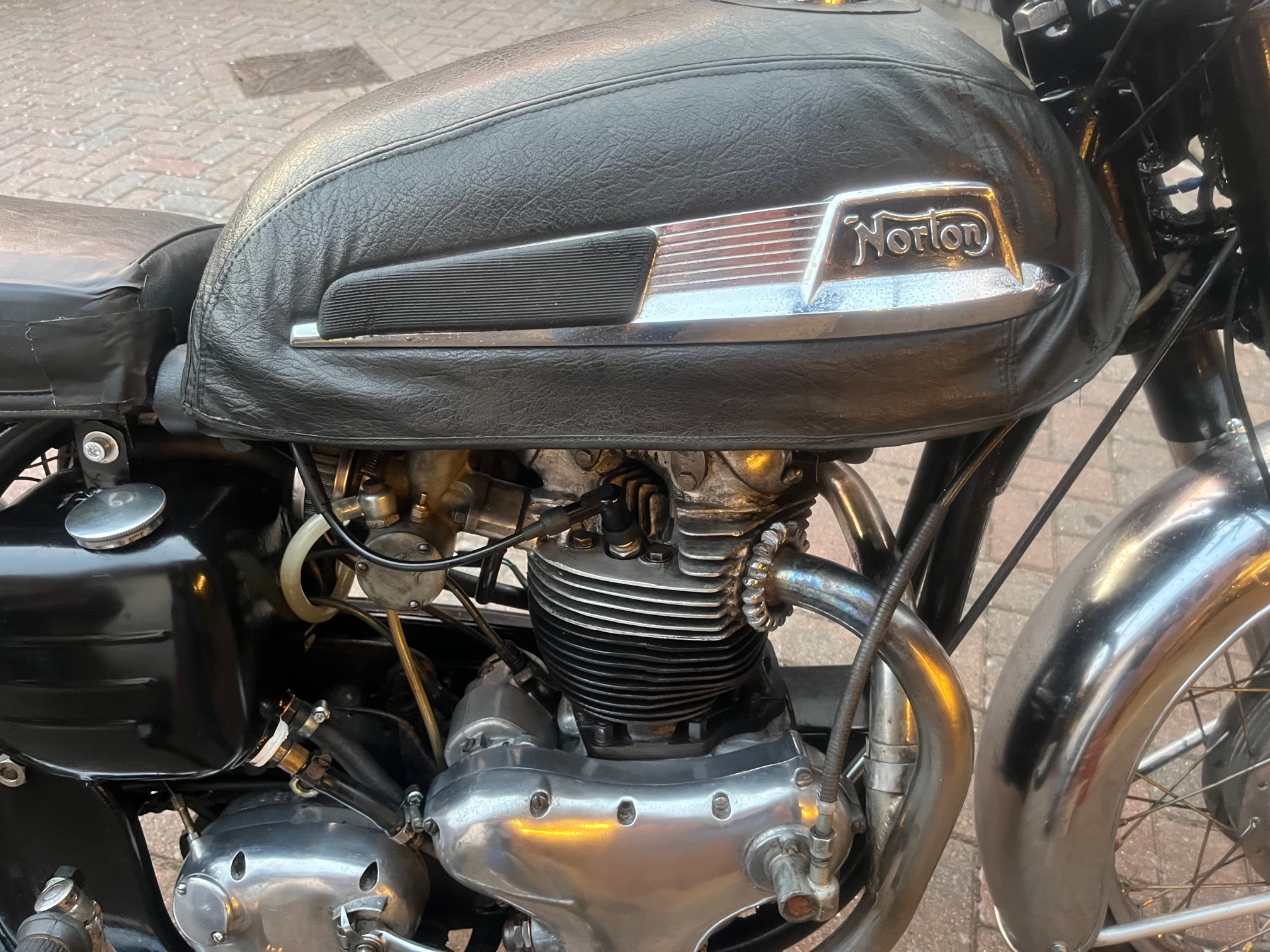

Thats called patina !, I think they are perfect. A bit of chrome polish then a good wax is all they need.  The pits are a problem and have to be sanded out which is likely to change the profile and they are brittle to handle or bend out of shape .Can be done but not worth the gamble to me. There has been some heavy brass reproductions made in the states. Bike looks good too.Love it as it is.

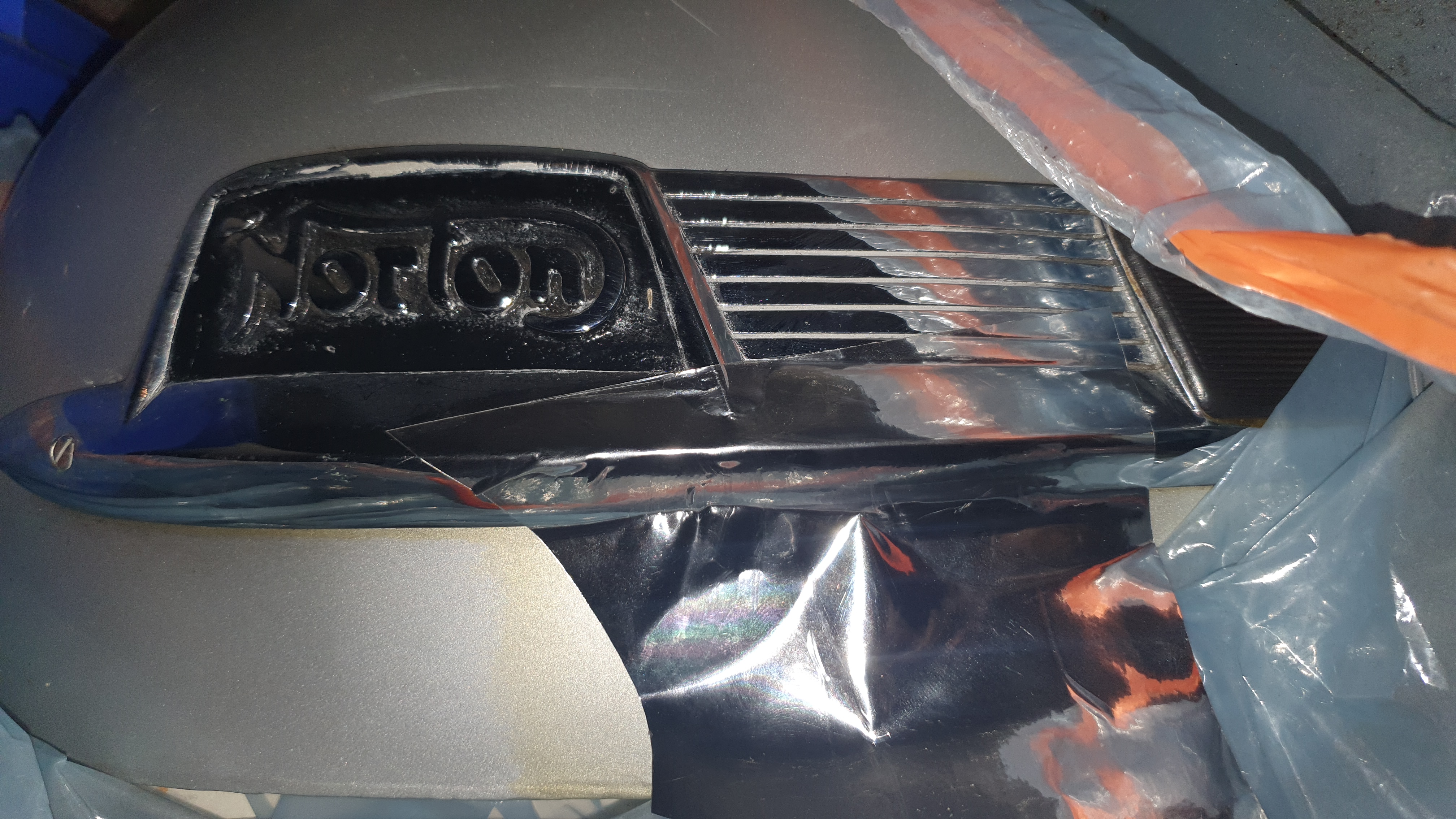

My 650 Tank badges were in poor condition and did not do my repainted tank any favours whatsoever. So as you can see from a little change in colours the end result was fine.

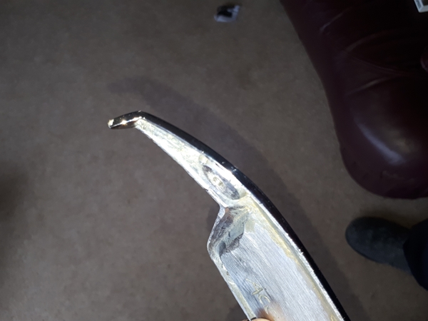

I bought a pair from Donald Pender back in April. The quality and fit (on my tank, anyway) was perfect. Unfortunately, when they arrived, one of them was damaged. The tip had taken a knock somehow and had cracked. I emailed Donald with a photo of the damage. A replacement arrived a week later, better packed and free of charge.
broken tip
