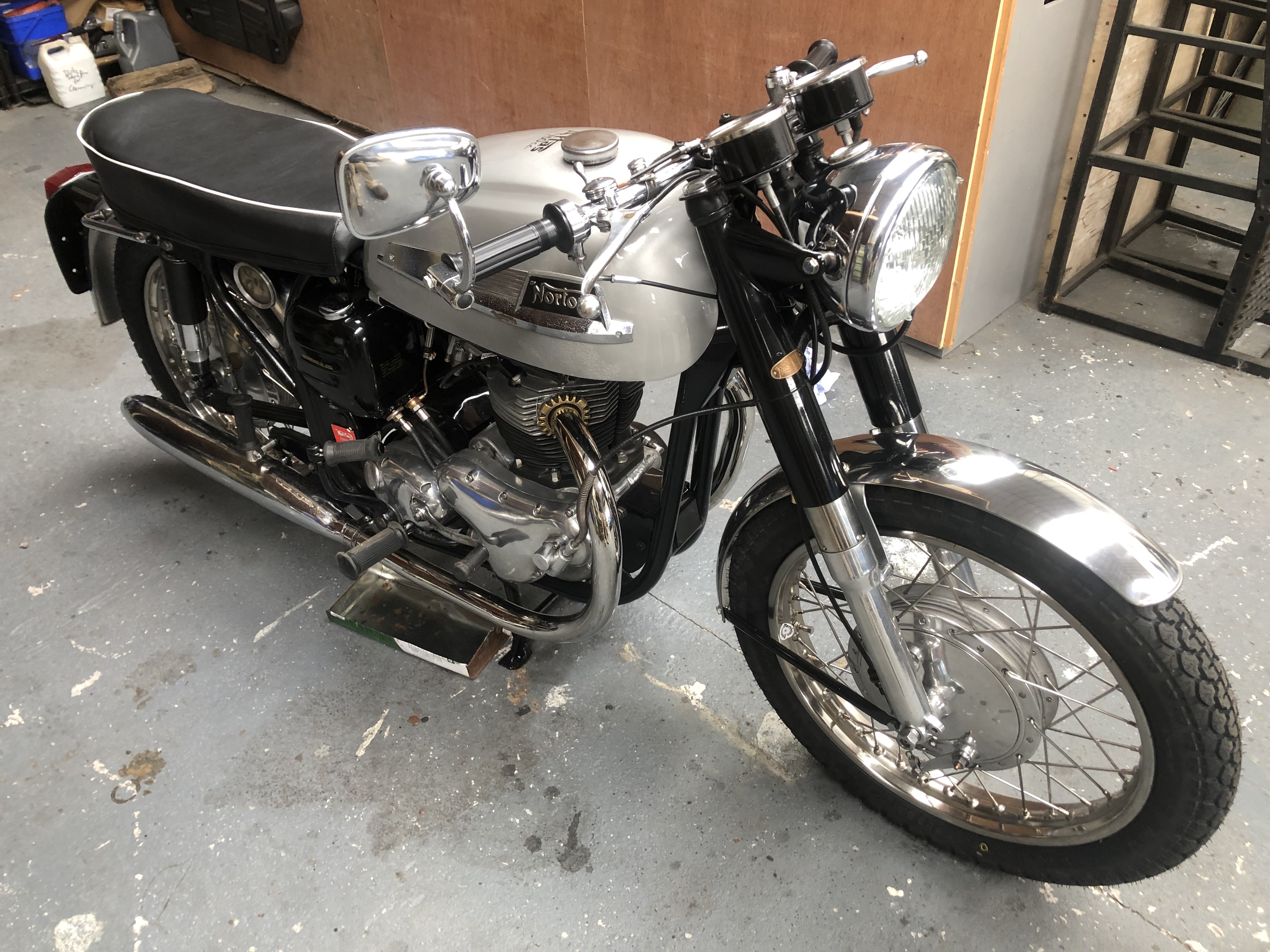

Hello everyone,
After 20 years in storage I decided to revive my trusty old 1963 Atlas as a last COVID project - it needed a lot of work to counteract the impact of the Atlantic sea air… She is now re-registered here in Ireland and nearly ready for the road, just the tank (respray to original silver, tank sealer and new old badges) and a few minor issues left, for some of which I would appreciate some technical advice.
Twenty years ago and less than 5,000mls since, the crank was submerge arcwelded and machined to std and the crank cases were welded and planed, all by Norvil together with new barrel liners and std pistons. I also fitted a six-start oil pump and an external oil filter at the time, although I am now considering to switch back to the original three-start one as I noticed that I still have the spiralled rocker spindles and the head oilways were not widened at that time.
My questions are: I don’t know if the conrods shells which were fitted are the later ‘holed’ ones and I don’t really want to take everything apart again. Is there a starvation risk using a three start pump if I have the holed shells? Or should I keep the six start pump and fit flat spindles? Having read various posts about pros and cons of the two types of pump, I am a bit confused…
My second issue is that the bike is hard to start when warm and I suspect that timing and carburation are the main culprits. The refurbished K2F magneto (used with N6C plugs) is set to 32° but I assume with flat rather than dished pistons (I assume Commando ones) I really need to set her to 28°? Twin Monoblocks are fitted with 250/1.06/20 jets and apart maybe from the size 3 slides these seem pretty correct to me. Pilot screw is 1.5 turns from tight, is there a rough guide for the throttle stop?
Any advice is much appreciated as I am keen to get back on the road after all these years!
Holger
