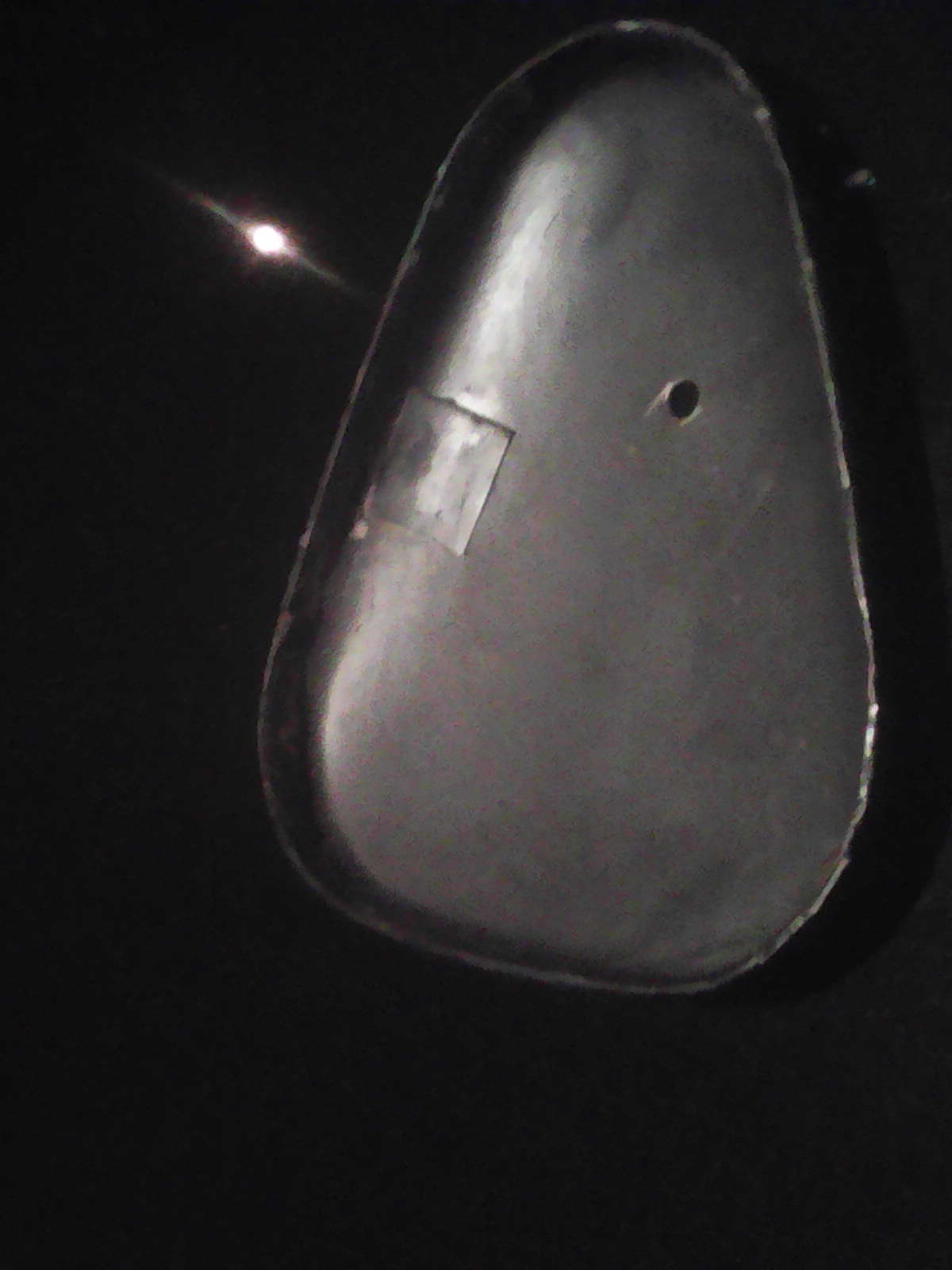

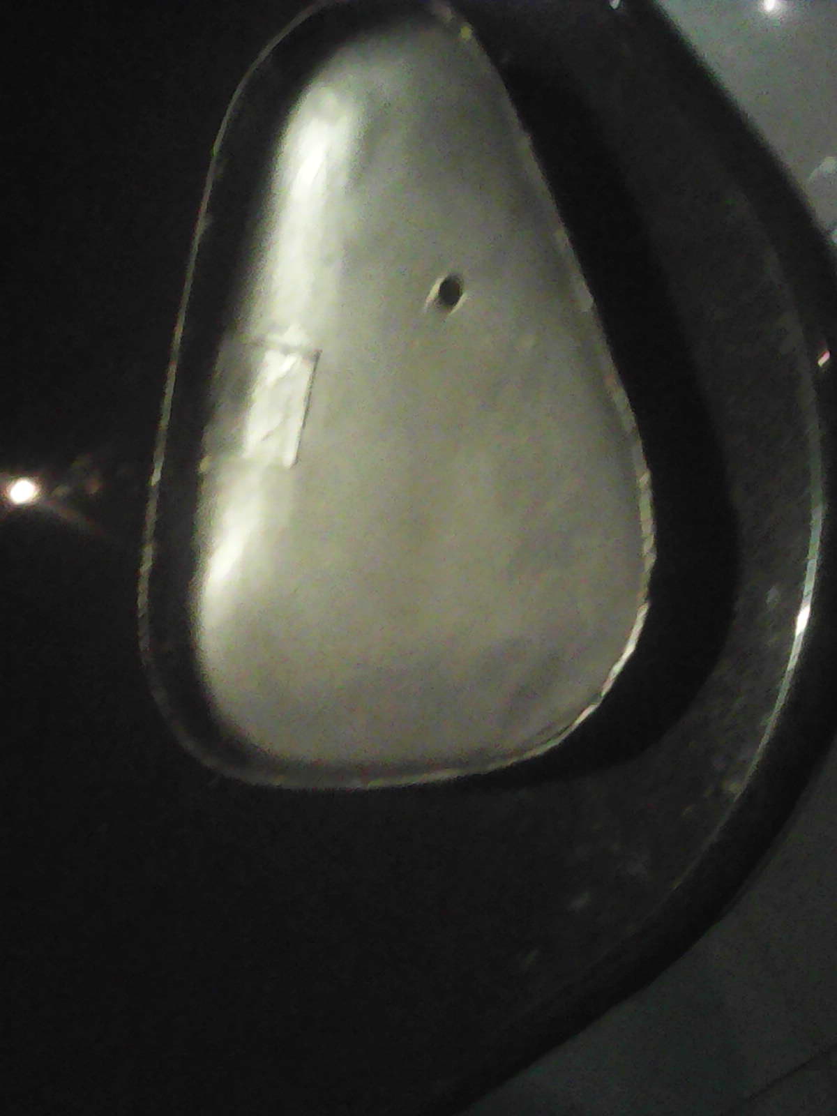

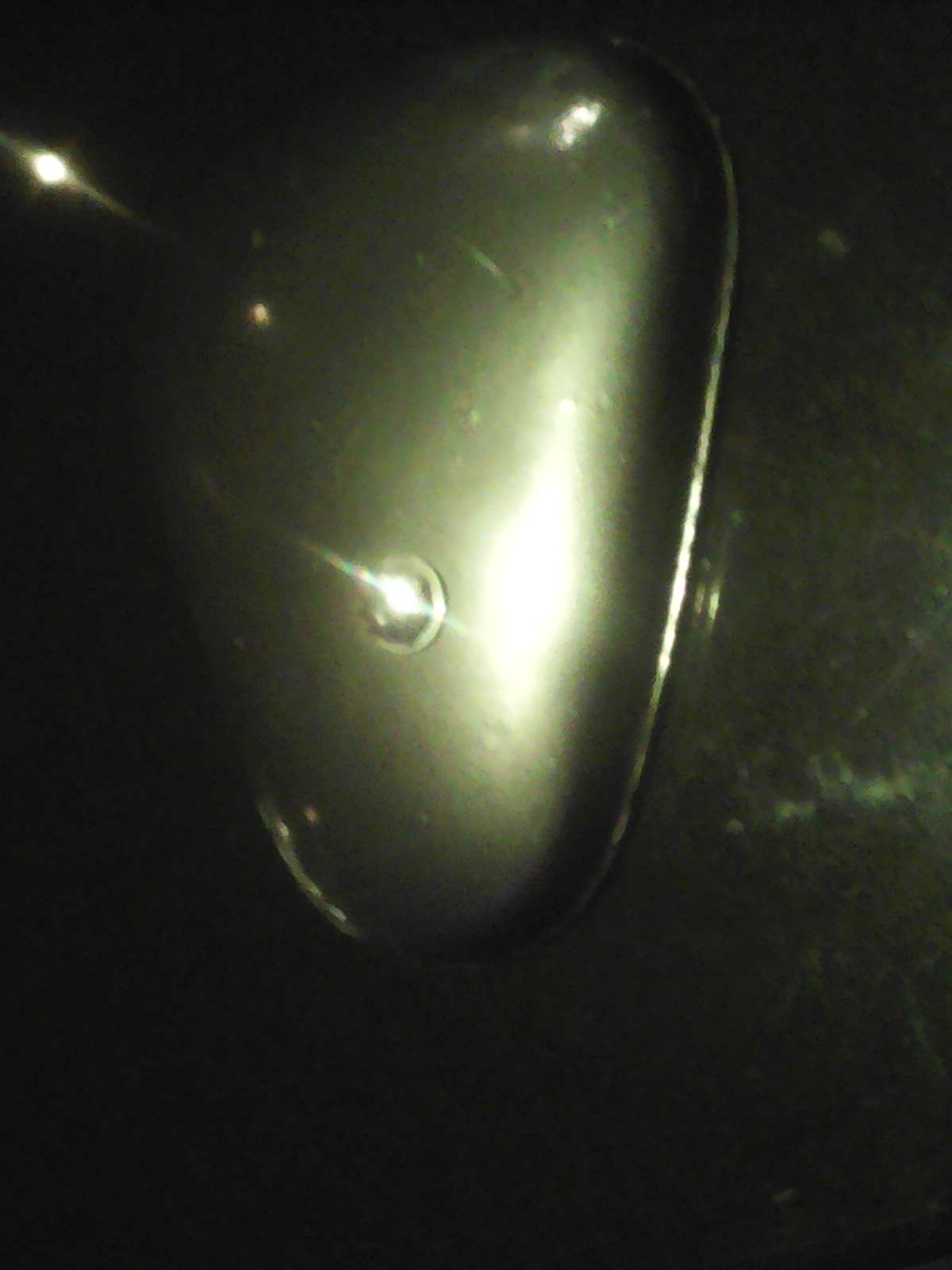

I lost a battery box cover…
I lost a battery box cover and did Exactly what Dan thought. I cut an oil tank in half ,patched it up , turned it upside down and it just fits. It is still there now. A lot of work, and waste of a good oil tank. But if your stuck.!?

For some reason there are…
For some reason there are more oil tanks than tool box covers! Pleased to see my idea would have worked!
