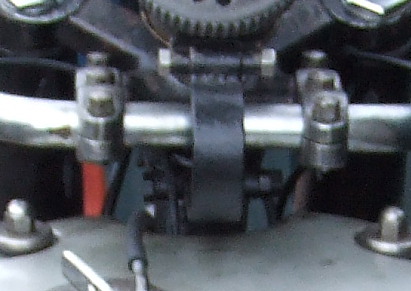

Hello Andy, On my 1949 Plu…
Hello Andy,
On my 1949 Plunger International there are two cylindrical mounts that are part of the headstock casting, the curved damper arm/bracket locates between the pair and is held in place with a through bolt,I would presume your girder/rigid Inter would have a similar casting? I have attached an image of my 49 Inter you can just make out the casting location.

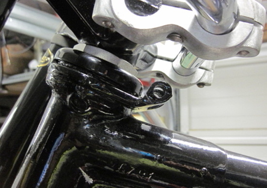

Hi. The plunger frame shou…
Hi.
The plunger frame should have mountings for the anchor strap just behind the top steering bearing.
Regards.
Ian.
Here's a piccy of those m…
Here's a piccy of those mountings for the anchor strap (if the bloody thing'll load!)
Regards.
Ian.
Thanks for that. We have m…
Thanks for that. We have made a bracket very similar to that to braise on. I think my bike should have the mounting on the tank (1934), but although we haven't stripped the tank yet, I would rather not have any more strain on it than needed so I will stick to the mountings under the headstock.
Does that mounting fit inside the cuttout in the tank? Or does the tank fit up underneath it? I need to make my tank mounting brackets, and have no seat at the moment, so am free to move things about and make them fit...

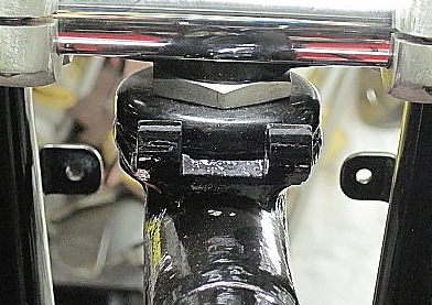

Hi. Here's another pic of…
Hi.
Here's another pic of that mounting. It's 2 inches wide with an inch gap for the strap - Stu Rogers does them. It takes a 5/16" bolt

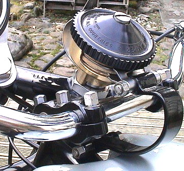

Here's a pic with the str…

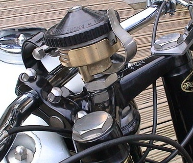

Hello Andy,
I purchaseda very good quality, reproductionAndre damper (suitable for 1930-50 Nortons) from Cornucopia enterprises based in Germany, here isa link to theirwebsite, the damper can be found on page 6 of their main catalogue:
http://www.cornucopia-enterprises.de/indey.html
I purchased mine in 2009 the price then was £145, I've attached a picture of the damper fitted to my 1949 Model 30 International.
