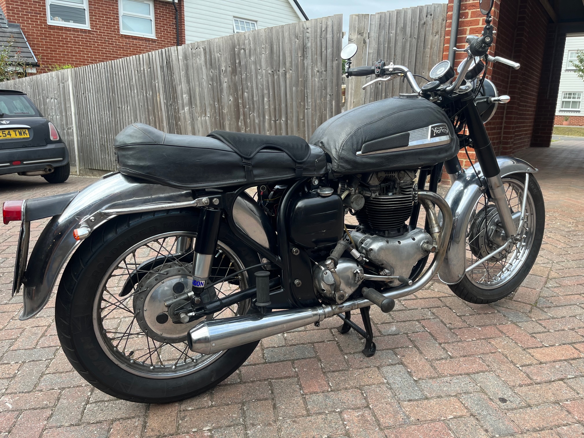

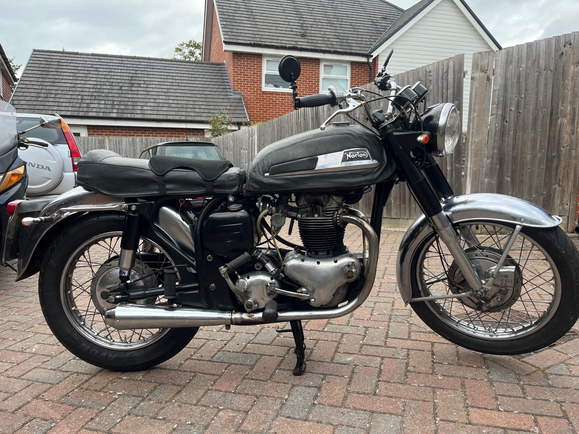

Hi Graham, Just so you dont get a mix up later ,the 19 tooth engine sprocket makes the gearing lower (not higher) than normal and coincidentally makes it slightly harder to kick over than the correct sprocket would . Takes a bit of mental juggling to accept !!. The cold clatter is fairly common on the Atlas and is piston slap that eases off as the motor warms up . Some did it from new. The HC pistons also are heavier than the orriginal dished ones and also can have extra thick strong gudgion pins that add weight . If you ever get it apart it would benefit from a re-balance that just might reduce the vibes . We geared our Atlas up with a 21 tooth sprocket, only just enough room and it has helped . (but its still a booger to kick over ).

This bike is a doddle to kick over. Starts first kick from cold or hot.And I constantly get mixed up with "higher - lower" gearing jargon.
The Ametech has definitely done something though. I could feel the engine and gearbox were smoother on a runout yesterday

A bike thats easy to kick over is usually well loosened up and often performs well. Sometimes its the last hurrah ! before a rebuild become due. The Atlas will rumble on for years if not abused . Oil burning is the driver that will provke a rebore/re-ring and valve job , then its back to a stiff lump to kick over till it settles down .I think the additive is reducing the piston slap and hence the vibration. There is also the brainwash effect too !.
It's definitely smoother at…
It's definitely smoother at cruising speed. I can just feel it. The engine does use a bit of oil which I keep topped up. Let's face it, I haven't even had the engine apart other than to set the tappets. No telling how much wear there is in there. And who cares! It starts easily, runs really well and hasn't blown up yet. And everytime I take it out I have a grin so wide you could slip a double decker bus through it. What's not to like.
The RGM anti wet sump valve works but not 100%. If I leave the bike for a few weeks the oil level in the tank does drop a bit. Soon levels itself out though once it's done a few miles.
Overall, it's a really good bike for a Sunday blast of no more than 50 miles or so, which is all I've used it for to date. If I was serious about doing long mileages on it (like riding to Germany to see my daughter who lives there) I'd definitely recondition or renew the oil pump beforehand. I'd also change the small engine sprocket so I could do some higher speed cruising. But for now it works for me and so far its been a total hoot!

Not much point in having a rev counter on the Atlas, a blanking plate on the cover and reduce the weight by putting the clock and bracket in the cupboard.

PS: should the mudguard stays be black, not chrome? That will surely affect airflow?…. :~)

Took it out last weekend for another thrash (and believe me, I don't spare the horses on this ol' beastie) and it just feels better than it did. I've gotten a feel for this bike since I started riding it and I can tell there's an improvement. Can't say any more than that really. Smoother at cruising speed, more responsive on the throttle and the leaks that were there on the box aren't leaking any more.
Oh, and it didn't blow up. Result!

This is interesting stuff. Ametech Engine Restorer. Not cheap. £24 for 400ml but it appears to work pretty well. I actually bought it to put into a '78 Honda CB400N I'm restoring for my son but I only needed 250ml to do that so I used the leftovers in the Atlas
The AMC gearbox had a leak on the kickstart and gearchange spindles. Not much but a bit annoying. I poured a small amount (about 50ml) into the box. The main engine has never been apart since I've owned it. Doesn't give much trouble but it has a few weeps here and there and is a bit clattery when cold. It also vibrates, but I have no other Atlas's to compare it with so can't say if that's unusual. It's got a 19 tooth engine sprocket so gearing is higher than normal. I poured 100ml into the oil tank.
After 100 miles or so the gearbox stopped leaking and felt quite a bit smoother with slicker gearchanges than before.
The engine has always been pretty much a first kicker, probably due to the Thorspark Electronic ignition unit I fitted and it's always felt pretty lively, albeit with vibration at higher revs. Since having the Engine restorer in it's noticably smoothed out, has less vibration and better pickup when opening her up. Particularly at cruising speeds, which is between 50 & 60mph on this high geared machine, it's much smoother.
I did my due diligence before using it and spoke to the suppliers at length. It's difficult to say what it's done but I'd definitely say that all round it's a better more enjoyable ride.
