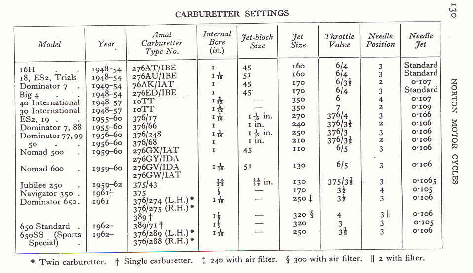

I have just checked the needle groove position on the carburettor as I was suspicious that the bike  was running too lean. ( 1956 Dominator 99 ) due to the very light colour of the plugs and difficulty re starting from hot. The needle should be in the third groove from the top but was in fact in the first groove !
The needle is letter 'C'. What is the standard letter code for the needle for the Monobloc ? I have not checked the pilot and main jet numbers. Nor as yet checked the fuel level.
