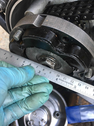

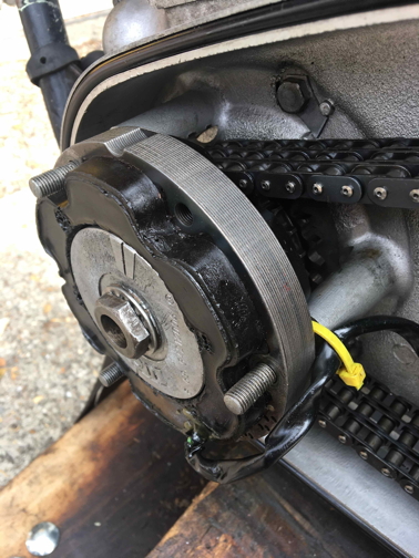

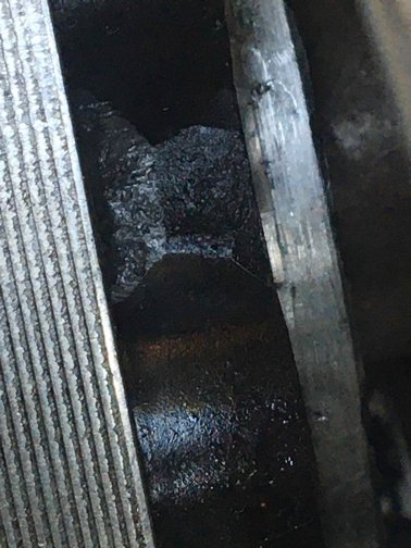

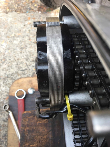

Although it doesn't appear to have caused any obvious problem over several thousand miles, I've become concerned about the axial displacement of my alternator stator and rotor.
I'm aware that the precise relationship is not critical, but I find it hard to believe that the displacement shown in the following pictures is a good idea.
A straight edge across the outer face of the stator just contacts the face of the rotor nut.

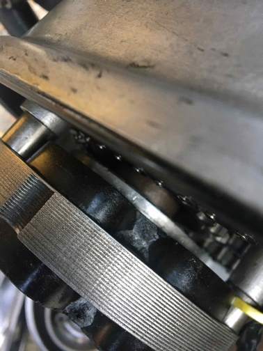

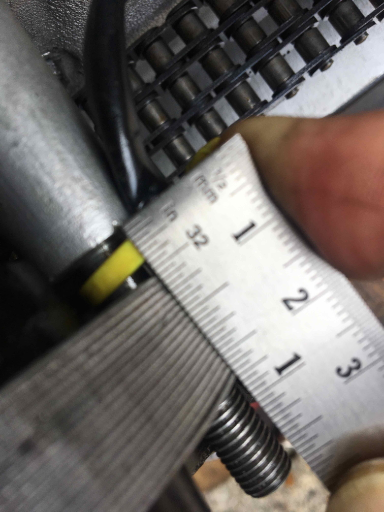

Here we see measurement of the outer face of the rotor relative to the stator.

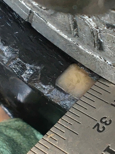

This shows the rotor relative to the inner edge of the stator.
Finally, a close-up version of the previous view.

- If I let the rotor's magnetism set its location on the shaft it settles symmetrically with the stator. I suppose this is not surprising in itself, but in that position it fouls the timing indicator in the outer chaincase. The consequent need to set the rotor asymmetrically in the stator I do find surprising. There seems to be more than enough clearance between the rear of the stator and the primary chain to permit the use of less deep spacers on the mounting studs. Mine are 1/2" deep; I haven't checked this with AN, but their proportions appear the same as the one illustrated on the AN website.

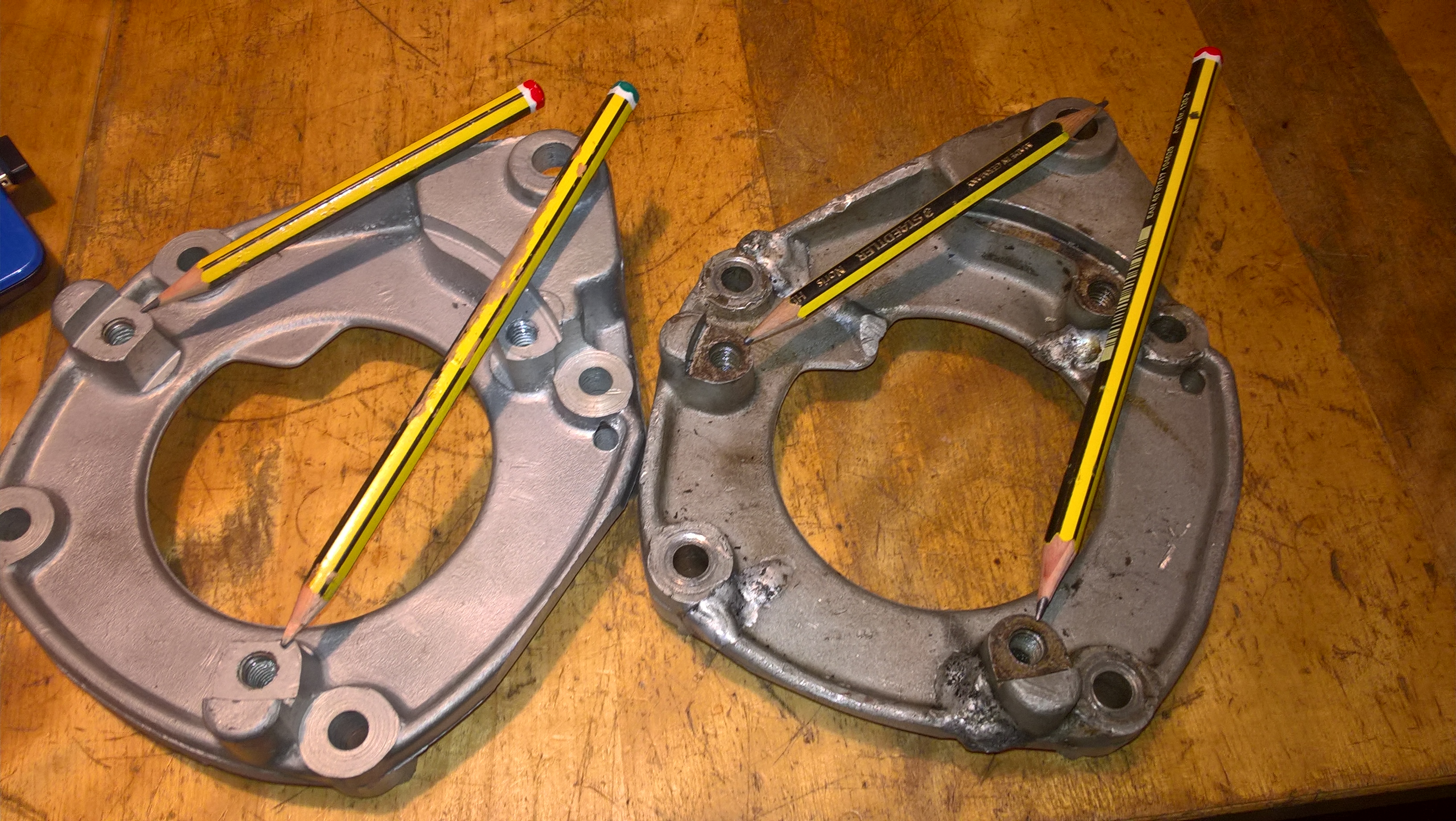

In your photo 3 you can see…
In your photo 3 you can see the encapsulation of the stator is just clear of the alloy stator mounting posts. The difference between the various stators potting compound and its shapes probably was the reason for mounting the stator further out, so there was no chance of an interference with what ever stator was used. If the potting compound will allow it (clear of the alloy posts) you can fit shorter spacers to bring it level. Make sure there is enough chain clearance, Its better to shorten the mounting spacers than to space the rotor outwards.
The new 3 phase stators available have the potting compound very close to the mounting bolt holes, In my Mk3 I had to machine the stator mounting plate (around the bolt bosses) so the stator could fit it. (photos attached)

Perfectly normal for the…
Perfectly normal for the rotor to be recessed, although your looks a little extreme.
There are spacers 06.0377 that stand the stator off from the inner primary case
You can reduce the length of these a little to bring the stator in board a little - just keep an eye on the primary chain clearance.
In addition, there is a spacer 06.0402 and shims 06.0664 and 06.0665 that sit behind the rotor to stand it out.
Aftermarket stators tend to be a bit thicker with the resin encapsulate which always makes the problem look worse.
Also, the higher output stators are thicker too.
I've done a few of these and only see a negligible drop in charging performance based on the axial alignment of the rotor to the stator.

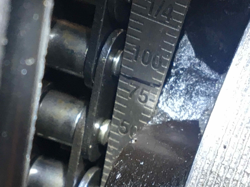

An update
I adopted the reverse of my earlier tactic by removing the spacers and allowing the stator to align itself to the rotor.
As the pictures show, this proved to be pretty much the equivalent of using 1/4" spacers. There was some evidence that the stator was very slightly impeded by contact between the potting and the aluminium pillars of the inner chaincase, but this should be easily dealt with by minor easing.
It was quite difficult to get a clear measurement of the clearance between the alternator potting and the chain (I resorted to a bore gauge), but it appears to be more than adequate.
