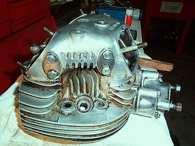

Hopefully attached is a photo of the 1959 to 1963 cylinder head usedon the99SS engines. Both the road and off-road Nomad version had this motor but with carb, ignition and other small differences.

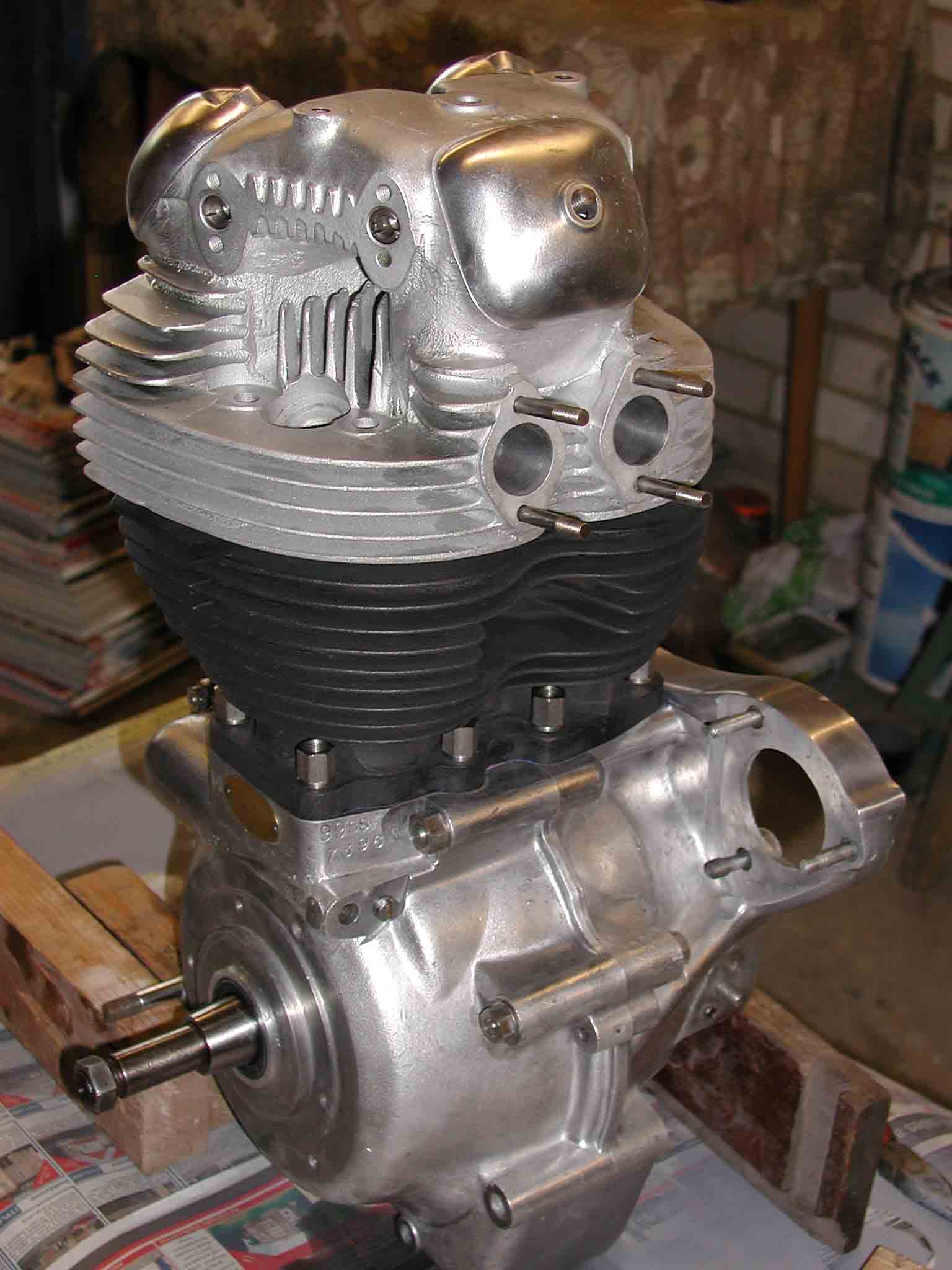

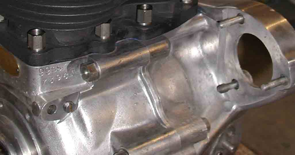

Hi Adrian, As this thread is still ongoing. The attached pic of my engine block may help.
I have rebuilt this engine from sump plug to head steady and at the time tried to pin down details of the spec. There seems to be quite a bit of âmisinformationâ to put it politely, around.
The 99ss 600cc had coil ignition, as far as I can see externally, the basic 600ss engine will look the same as standard of that year. You need to get inside to check things out, the camshaft was the main difference. Valve timing can be checked but unless you are up on 50/74/82/42 and things its not easy.

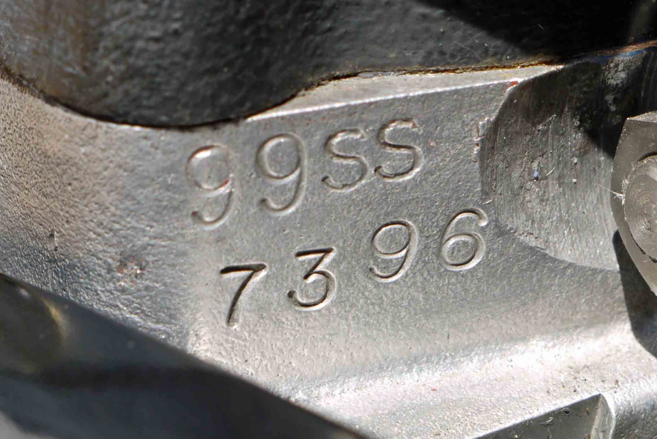

The number that is shown with the 99SS is not what is generally given as the engine No I would like to know what it is, in my case its not the works build No.
The number needed for the VOSA Doc will be the number on the drive side. You should be able to trace more details of the original bike from this.

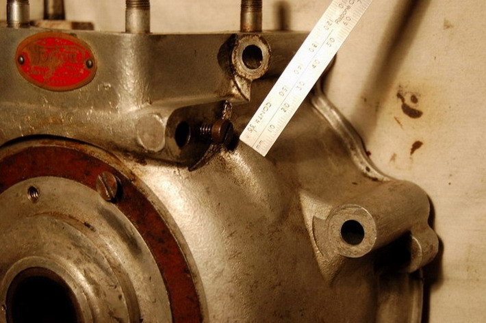

Adrian, If you are able to turn the engine, you could confirm the stroke with a 6" length of welding rod. Another pair of hands would be helpful.
Rest the rod on top of the piston, turn the engine until the rod stops descending. Mark the rod with a fine felt tip pen, level with the top of the plug thread. Turn the engine again until the rod stops rising and make another mark in the same way.
You'll most likely have 82mm!
With the 650's (also 750's & 850's) having 7mm more stroke, also larger big end journals, the crankcases had to be enlarged to clear the big ends. I'm attaching a picture of the area of the drive side crank case where the difference is obvious, when compared with 600cc crankcases.
The steel rule is resting on the enlarged area of the 650 case.

Before we put Adrian into a flat spin, is the crankcase bulge more subtle than it looks, or is it just machined inside for 650cc. or are we learning something here. See pic.

. I attach a pic of my inlet manifold but I canât guarantee itâs a genuine Norton part, no part No. Unfortunately there are two sizes.
hope that manifold is notresting on the wifes best table cloth ???, ha ha....thanks very much i will inspect mine in great detail tomorrow to compare.

Evening Gents,
You seem to be working it out.
Ron
my head is off... not the one on my shoulders of course, so if i go to B.D.C and measure to the top of cylinder barrel, then turn engine to T.D.C and measure the protrusion of piston crown, deduct that measurement from the first measurement that will be the stroke ? like i said my mathematics.... not so good

Just to add to the confusion!! No-one has mentioned a year date for Adrian's engine yet but, from the 2 engine numbers mentioned in this thread, both must be later than 1960 as they don't have a year letter. The lastletter usedwas "R" for 1960.
Phil, I wasn't aware that an SS head like your photo was available from 1959 - it's not in my Parts List book for that year or 1960, 1961/62, but I haven't got any SS Parts Lists.The 1959 listonly has the optional equipment of a head with larger inlet valves - subsequently made standard from 1960-on. Mine is a standard looking head without the machined-off side fins but with large inlets; Part No.21325A. The same head was also available for the 88 and was normally fitted with twin carbs and high comp pistons. This would have made a "pseudo-SS"! Did the one in your photo have wider-splayed exhaust ports? It doesn't look like it.
As the parts from this era can be pretty much "mix-&-match" it migh be difficult to estimate the actual capacity of an engine without measuring the bore size! Even then it's not clear cut as a 500cc 88 may have been bored out to 67mm and the standard bore size of a 99 is 68mm - accurate measurement will be essential.

my engine is stamped 14 an…
my engine is stamped 14 and its number is 98123, front left hand side, the 99ss 7473 being stamped to the rear just inboad of the crankcase breather outlet. never got around to any measuring this weekend , maybe one night this week, thanks for ALLyou wonderful people's input
Previously wrote: my engin…
Hello adrian Now This Machine was built at the end of May 1961 ,The 7473 number is the Norton workshop Number And You (99SS) As A bore of 68mm and a Stroke of 82mm 600cc

The photo that I attached is basically a standard 99 cylinder head which would have been fitted to most 88 and 99 engines from around late 1959 on.On theseheads there would have been a 2 into 1 carb manifold stuck on the back. They wouldalso have had the vertical carb manifold mounting studs slightly further apart. Up from 1.50" to 1.65". The heads also featured slightly larger inlet valves compared to pre 1959 engines..
At the bottom end, the standard engines would mostly have been equiped with coil ignition and the back of the crankcase stamped 99C to show this. However, you could have a Magneto fitted by the factory as an option. In which case there would only be 99 or nothing stamped.
Now the 99SS engine also used this old style of cylinder head but had a special adapter bolted onto it so that twin carbs could be fitted. These engines were fitted with the 650 barrels with wider pushrod tunnels to accomodate the fatter 650 style pushrods which were needed to cope with the stronger valve springs. I agree with Anna about the 650 engine having longer barrel sleeves and also believe these were used in the 99SS engines.
The 650 cylinder head wasalso available in 1961 but not fittedto the 99SS.(there were some exceptions) The two heads are quite different in the manner that carbs and exhausts were fitted.

Genuine factory built 99SS engines were stamped at the back with 99SS. The other four digit number in this area is the batch number.eg 3575 would mean this was the 3575th engine made, probablyin a run of around 10,000 units, which might have included other models.
At the front of the crankcase, top left there should be the5(but possibly6) figure engine number. The NOC Bike Database shows 99SS numbers beginningat 96000 up to around 98200 but there are likely to be others either side.Possibly in the same area will be the number 14 to denote an engine for the 99model.

Hi, I am very hesitant to add anything further to this thread but as Phil has asked a specific question.
I have posted, in this thread, a picture of my engine Web-Pic-1, from the factory records, NOC; the 99SS machine was despatched to the dealer on the 7th June 1961. An early 99SS engine?
If the bulge in the crankcase is a true indicator, this point again is in this tread, my engine has a 650cc crankcase, the head type can also be easily identified, this point also in this tread, I have a very full photographic record of the rebuild.
The camshaft is as 650cc, timing confirmed 50/74/82/42, cam followers are flat faced and pushrods are barrel shape and correct length as 650cc.
This is first hand knowledge not hearsay or conjecture.

I looked at all the cylinders I have for these bikes, about a dozen of them. I measured the thickness of the cylinder flange which holds the cylinder to the crankcase and it was the same on all cylinders around 12.5mm. The length of the cylinder sleeve down into the case from the cylinder base was the same on all of them, the model 99 cylinder does not have the notches cut into the sleeves for connecting rod clearance. The 650 cylinders have casting #22710 on the back of the base flange, the 88 and 99 cylinders do not.
From the bottom surface of the base flange to the top deck of the cylinders the 99 and 650 were the same. I measured nine different 68mm bore cylinders dating from the alternator model 99 with no rod-notches through Norton Manxman and mid-sixties 650ss cylinders and they all fell between 4.540"-4.75" in height. This was with a vernier caliper and I tried not to get old gasket and sealer material in the way. I used to work as a machinist and I am sure that a few thousandths of the difference in my measurements was due to the handling of the tool and dirt and debris, but I am sure that the factory fully intended all these cylinders to have the same "deck height".
I am thinking the different cylinder part numbers between early 650 and late model 99 machines was to insure that old factory and dealer stocks of model 99 cylinders were not put on the new 650, which would result in the rods hitting the non-notched cylinder bottoms and resulting in a catastrophic engine failure very quickly!

The factory built 99SS models, that were catalogued and available to Joe Public for a little under two years,were all stamped with 99SS on the back of thecrankcases. As opposed to just 99 or 99C on the other 600cc engines.
As part of the deal, you got an SS camshaft from the 650 engine as well as 650 barrels, 650pushrods, twin Monobloc 376 carbs plus the option of a siamesed or standard exhaust. The most notable diffference between the 650SS and 99SS was the cylinder head. The 650 had the new splayed exhaust and twin carb job with horizontal carb mounting studs. The 99SS was sold with the old standard 1960 style 99 head with the old exhaust ports and mounting studs for the 2 into 1 car manifold. Although, mounted in this area was now a special adapter which fitted between the head and allowed the use of twin carbs. Strangely, in this head you had the bigger inlet valves of the 650 and some earlier 88 &99 heads plus the shorter but stiffer 650 type of valve springs. Coil ignition was used for these engines.
Of interest, the 1962 sales brochure shows the 88SS wearing the 650 type of SS cylinder head but mentions that the 99SS has the standard head. John Hudson once told me that the last couple of dozen 99SS bikes produced by the factory were actually fitted with the SS head but were never released to dealers as it was quickly realised that any of the previous 99SS bikes, stillavailable,would then never sell. Which begs the question of what happened to these proper 99SS specials? Where the bikes re-engined with650SS motors and sold as such or just dismantled for spares?
Hello Phil, the 650 barrels are 7mm longer than the 99 and the 99ss have ak2FCmagneto. I owned one back in the 70s and raced it too- I thrashed the nuts off it, but it just came back for more - what a bike! I wish I had NOT SOLD ITwhat aFOOL I was! Yours Anna J dixon

hello do you meen 99c ,I have not heard of a 99s ,but have heard off the 99ss built from april1961 to sep1963 this engine shares the camshaft and pushrods and followers from the Norton Manxman 650
Hi, sorry to disagree with you but the 88-99 SS was first sold on the 1st of January 1958, it was bought by a consortium, I know as I have it and at present am restoring it back to its original condition,

Hello Patrica Well You have to disagree with Norton Factory records, The first 600cc 99sports special was built in March 1961 colour's where Norton grey and dove grey the machine you are referring to where know as the Clubman fitted with twin Carburetters Colours where, post office red or metalescent blue
