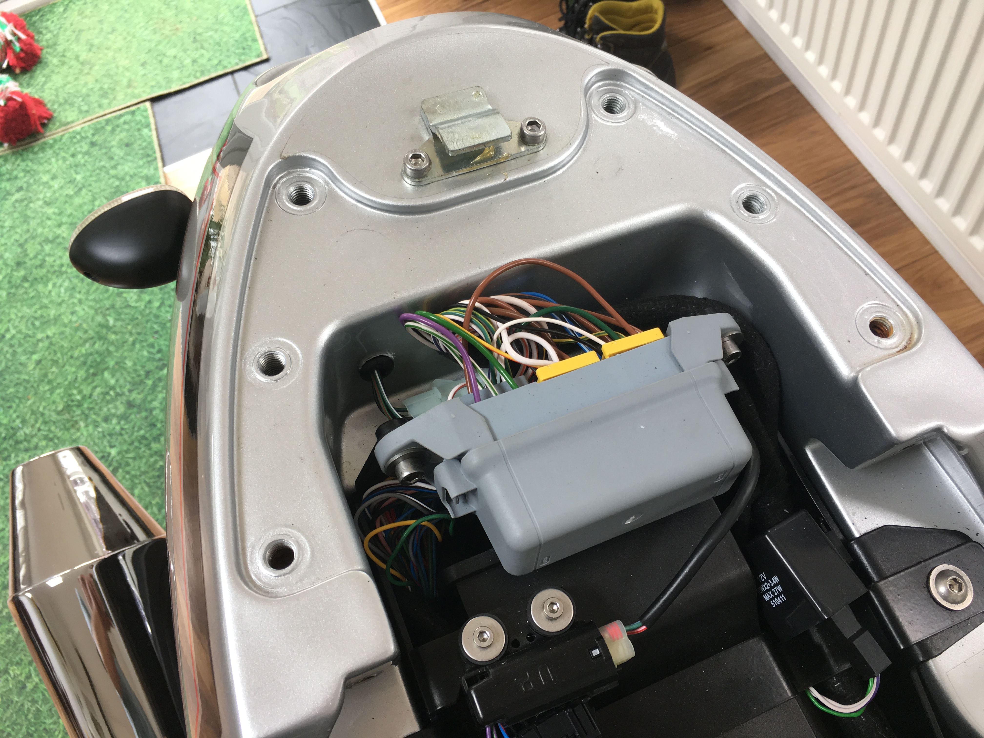

Can anyone point me to where I can get a rack to fit 961 SF? The bike has the split seat which has what looks like substantial mounting points (see photo) on the base but I can’t find any suppliers. I’d also like to fit de-cat & straight through pea shooters but the Norton ones are hideously expensive. Any help greatly appreciated.

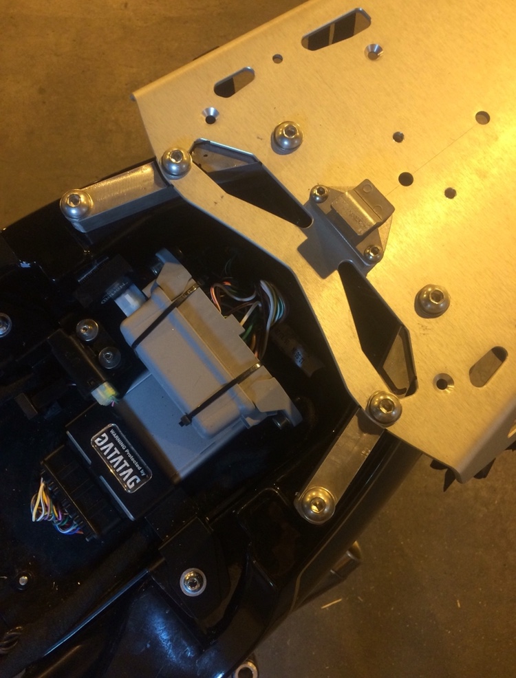

Altrider rack meant for a Ducati multistrada
With a bit of an adaption this is what I did

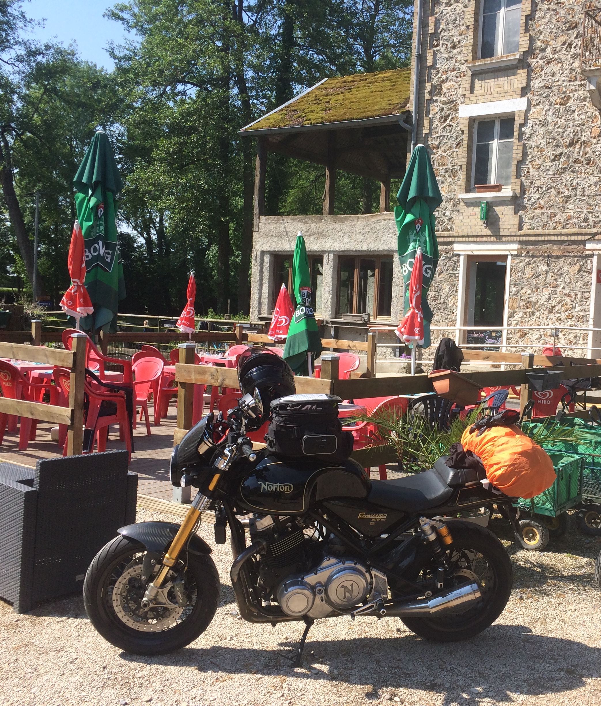

Bike rack fully loaded

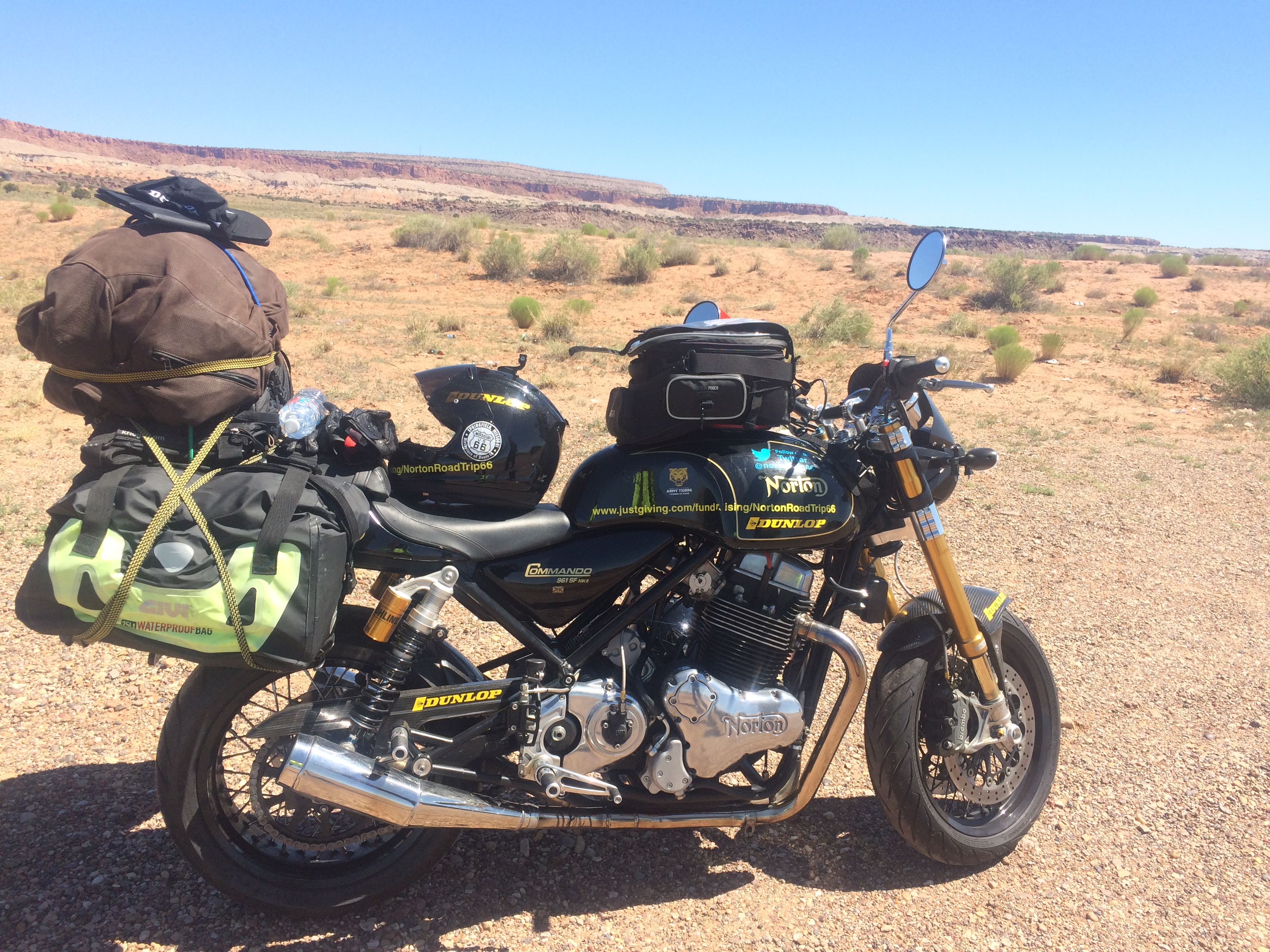

This is with a 40litre roll bag, tank bag is a 20litre quick release job, a Triumph 1050 sprint adaptor plate is needed for going on the fuelcap with a few washers to make absolutely level for bag no snap on & off
& really fully loaded
Throw over panniers again by givi meant for a motocross bike

Altrider rack
Richard, that looks just the ticket. I’m guessing you had to machine the struts to fit the rack to, or are these available anywhere to buy?

Make the rack fit
I had a friendly fabricator guy knock up the fixings ,there is a 961 guy in west country that’s had a rack made for £550 & looks like it’s a quality item.u need to take a browse on this https://www.accessnorton.com/NortonCommando/pictures-of-your-norton-961.21269/ few guys have made effective panniers mounts for very little money , from a Triumph I believe
