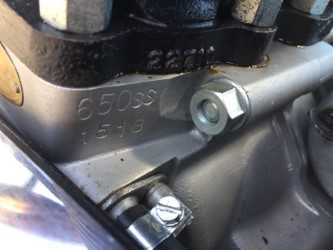

Another picture.
This shows the correct front left position on crankcase with engine number 18 102607
I was expecting to see SS stamped with the engine number 18 102607.
Something like 18SS 102607.
Or is 650SS on rear left of crankcase correct?
It is beginning to look ok to me.
Looks like a genuine one to…
Looks like a genuine one to me. Unusual to see the big bore exhaust pipes on a 650 - does it accelerate ok ? Good luck, Howard

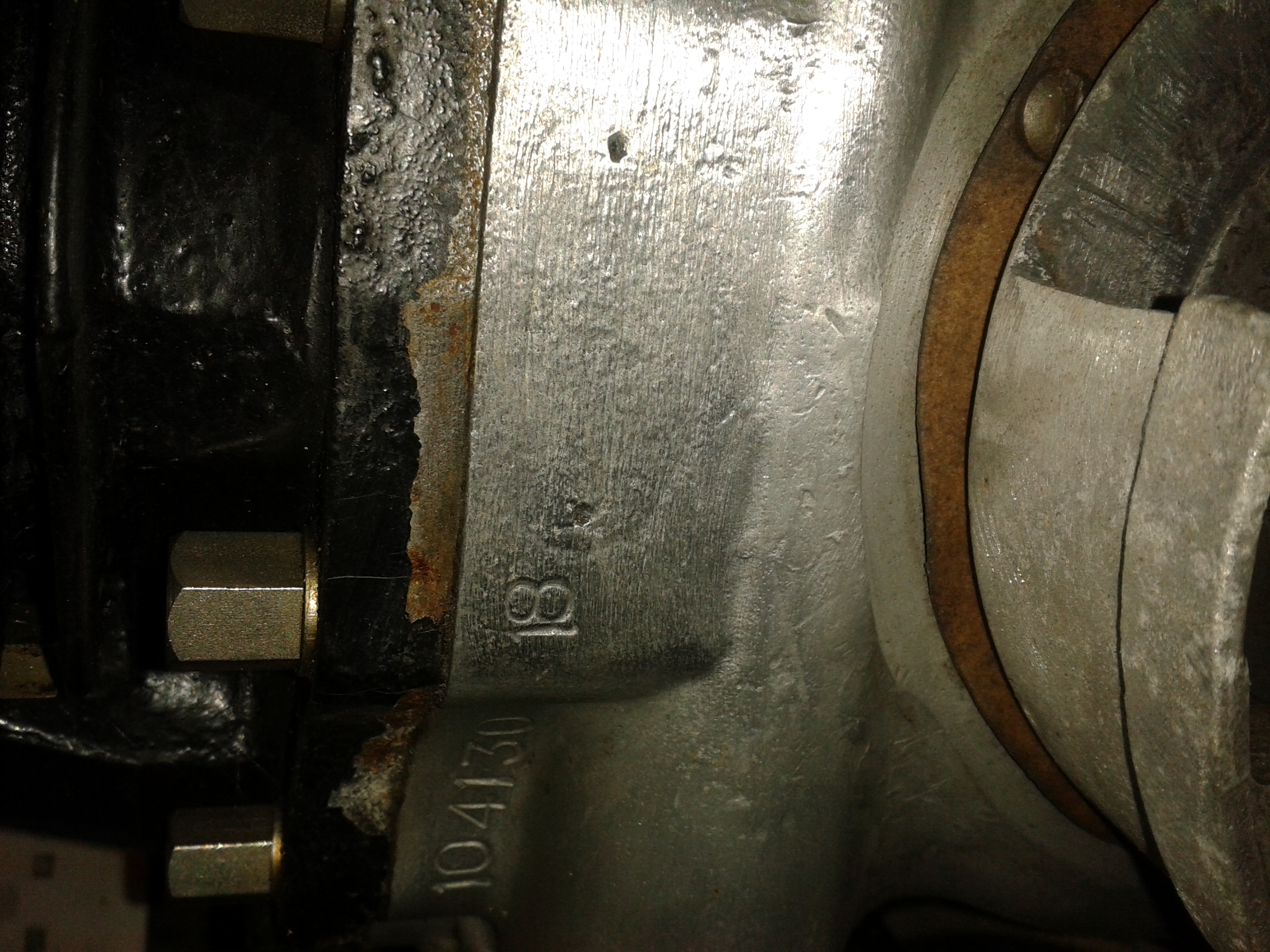

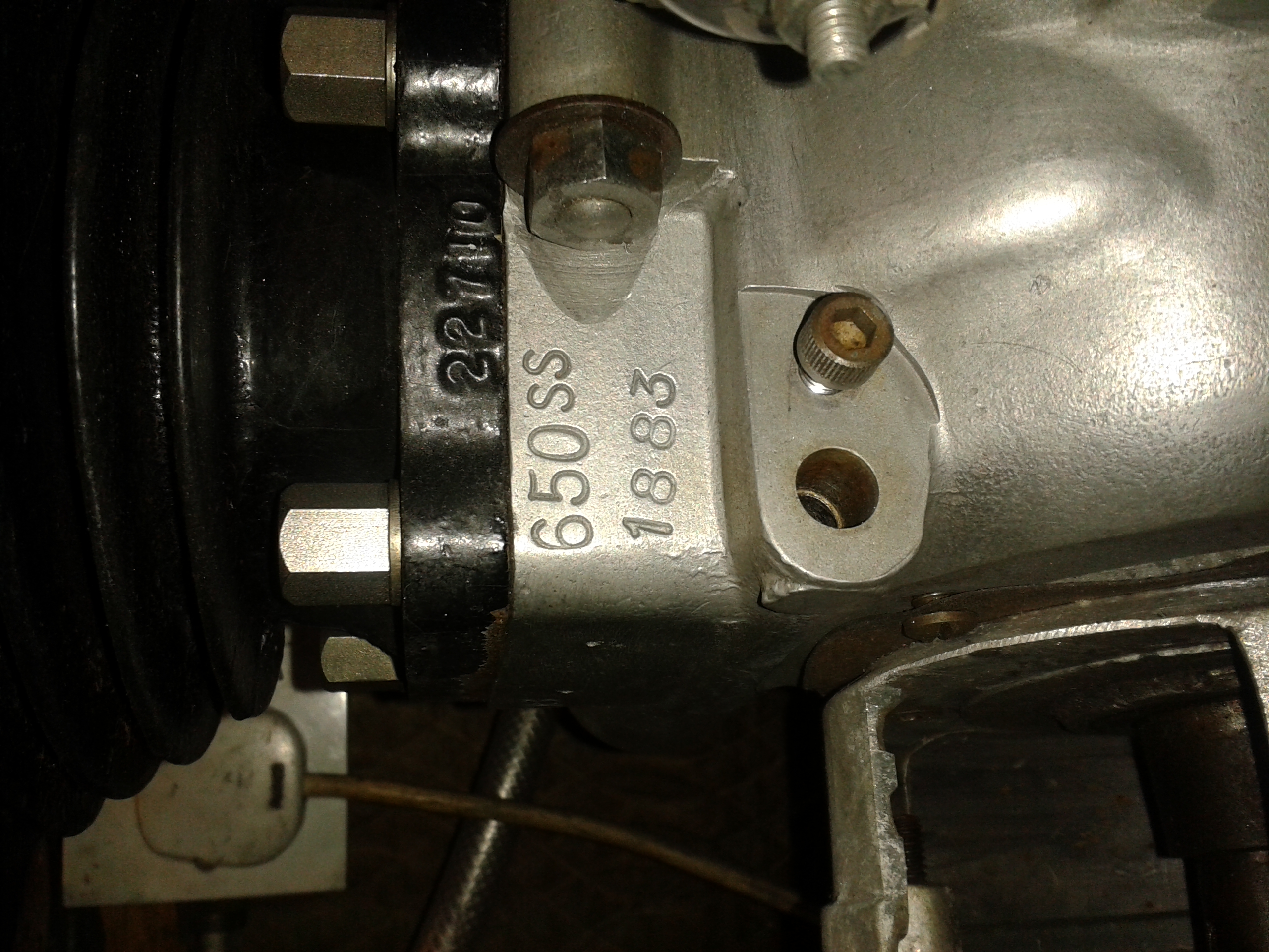

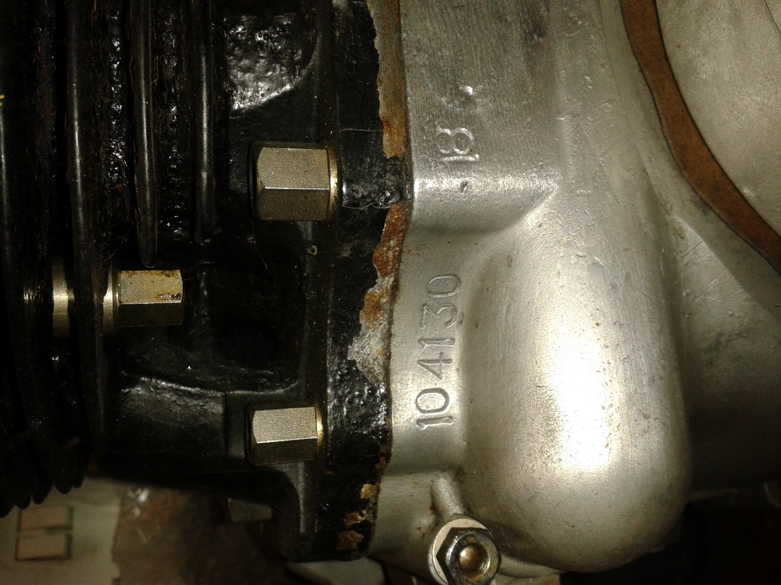

650ss Engine numbers
The numbers on my 650ss engine are 104130 , model 18ss,
shop registration number ( 650 ss) 1883.
According to factory records supplied to Kings (Oxford ) Luton on 4/9/1962 .
Hope this is of some help.
The early 650 had on the back of the engine above the breather a stamped "65" there were also "65C" then around 63, the shop number had "650C" or "650SS".
I don't recall any having SS as part of the engine number... only code 18
