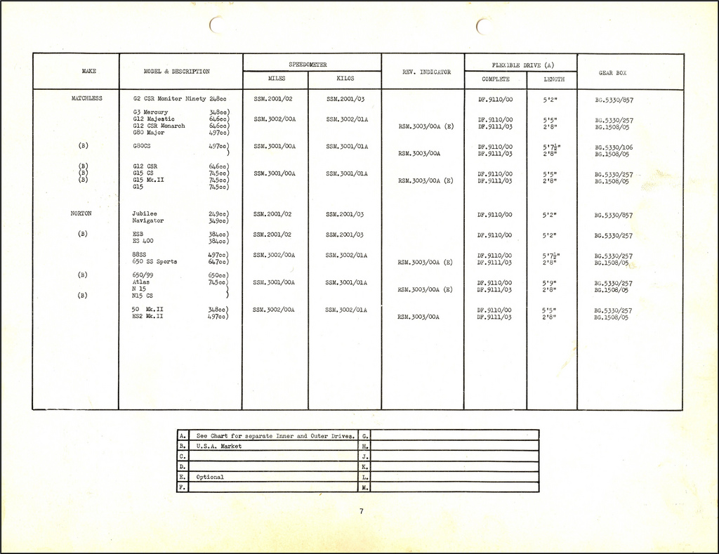

Attachment should be of some help.
All the UK Norton 650 Twins used a 2:1 drive box on the rear wheel.  Look out  for a genuine BG5330/257. Having said that I used an Indian replica version with nylon cogs in it for 6 years and never had a problem. I think the 15/12 box is for Commando or other models.
The 1968/69 Mercury's used a Smiths SSM.3001/00A for mph, and a Smiths SSM.3001/0A for Kilos. The rev-counter was a Smiths, RSM.3003/00A. The speedo cable was 5ft 5inches and the rev-counter cable was  2ft 5inches. The speedo drive was as Phil said, BG.5330/257. The rev-counter drive was BG.1508/05
