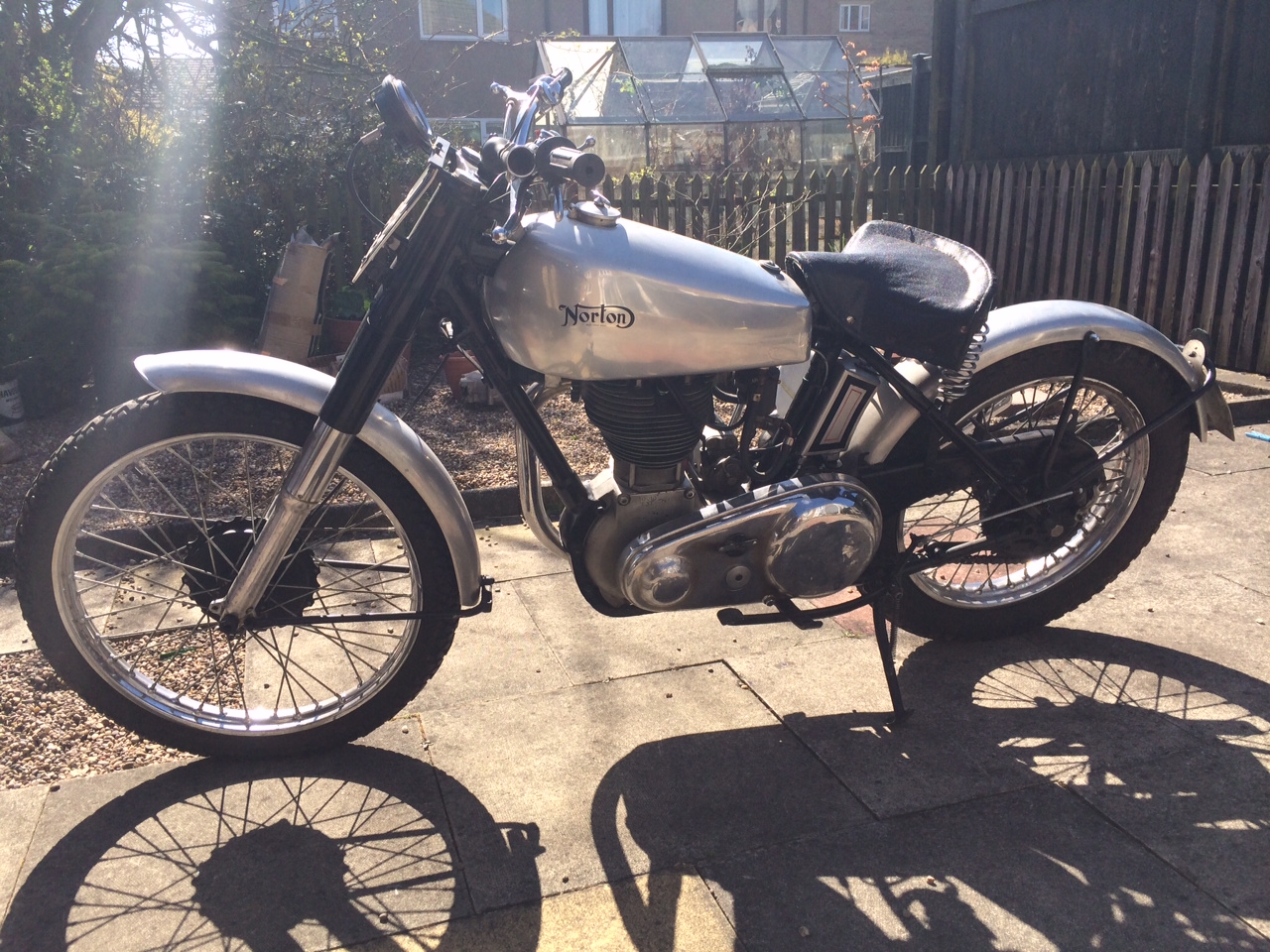

Is there any chance of a closer shot of the stay where it goes around the back of the guard, and is it 1/2" or 9/16" diameter tube. Many thanks, Colin.
Photo to follow
Hi Colin,
sorry I haven't managed to post a photo yet. I tried to get one this weekend but the place I keep it was all locked up. I'll try and get one this week.

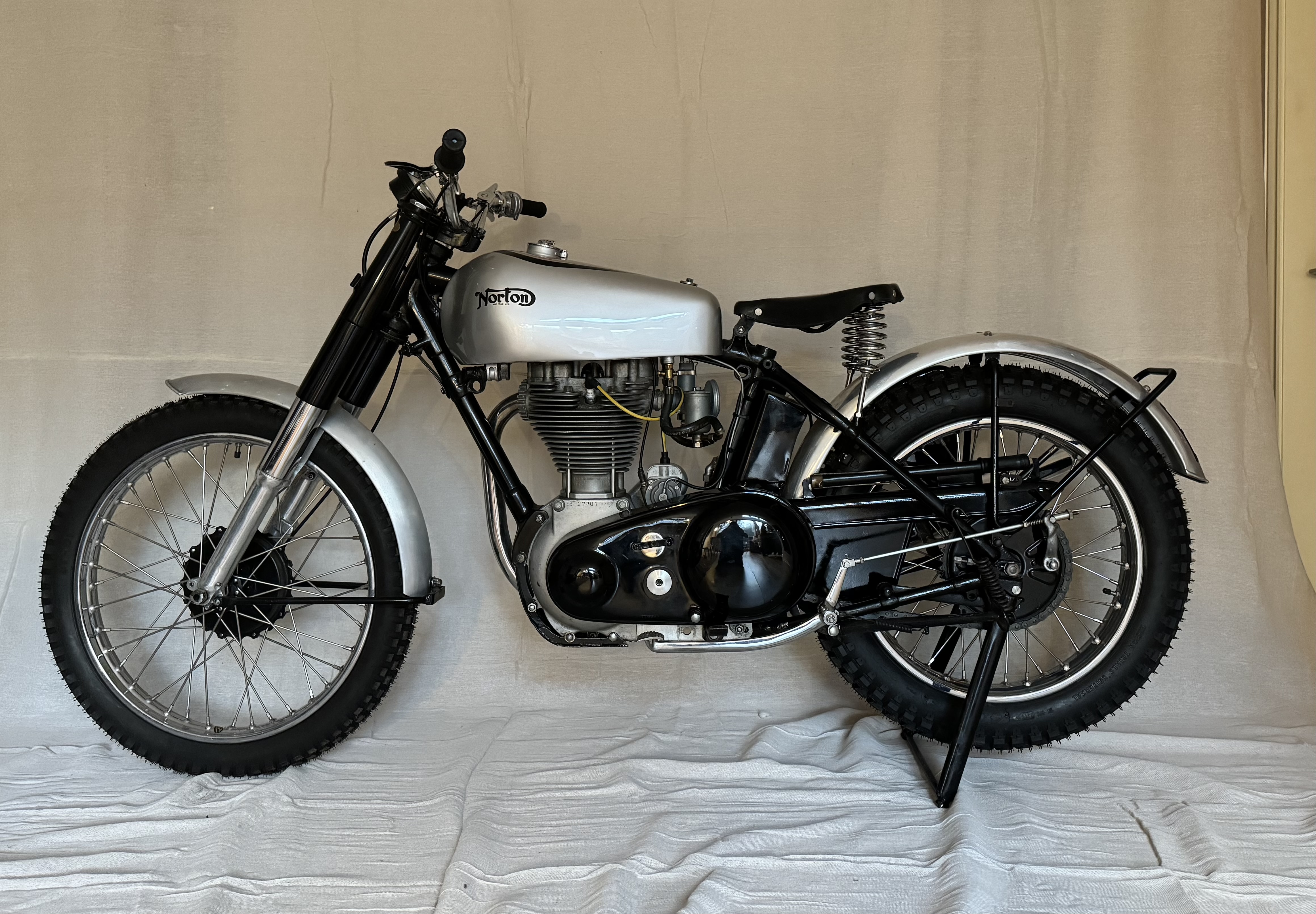

Hi Colin,
it’s different to all others I’m afraid. (21” wheel.) I have posted a photo of the correct one below. Lots of other things wrong with the bike (pre restoration) but it is the correct stay.
The front mounting flats are inverted to keep it as narrow as possible and the rear loop is plated to act as a stand, with a slotted lug for the retaining bolt.
Hope this helps.
regards,
Alan
