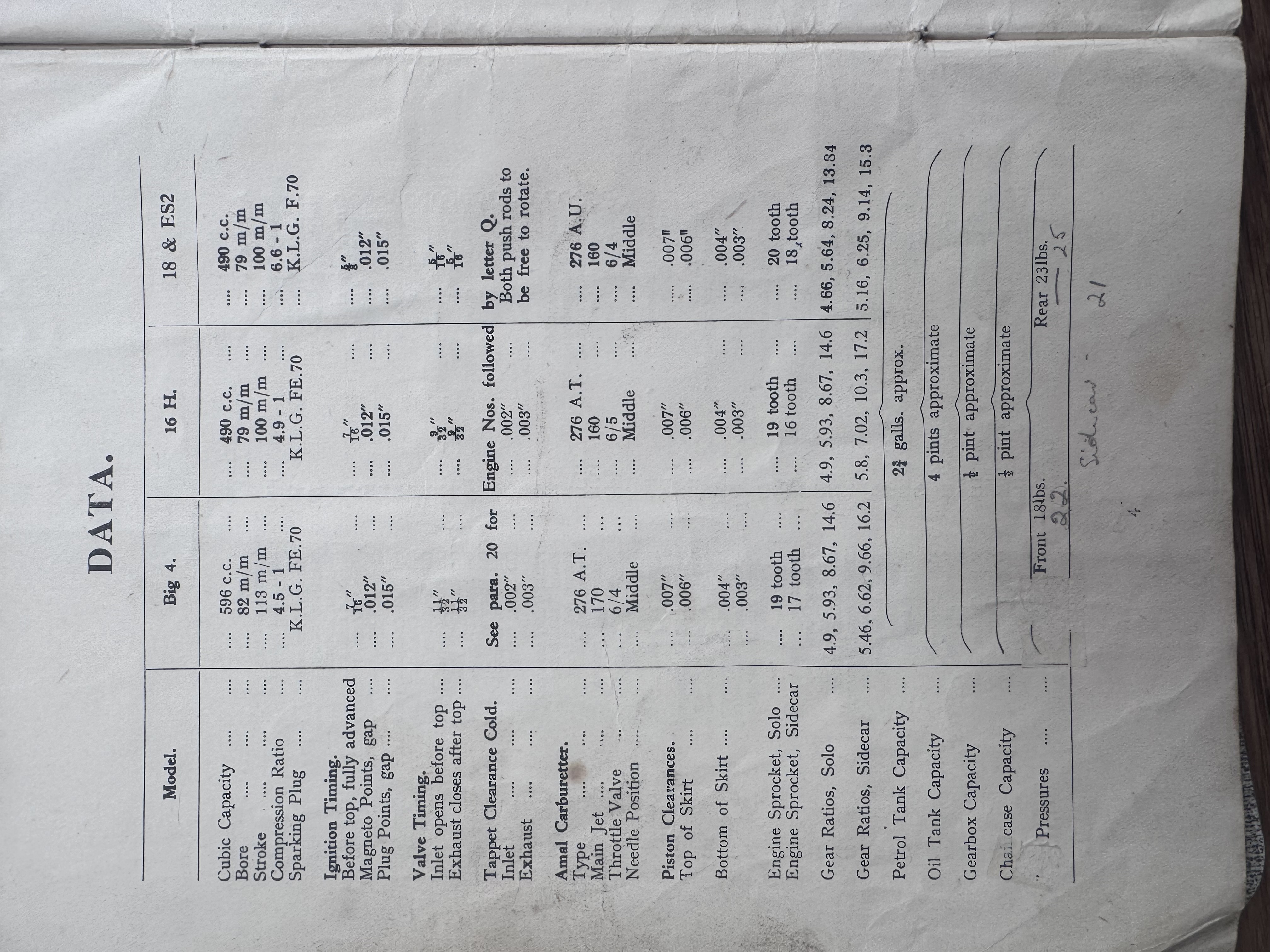

Hi Gary,
The 500T engine is an ES2 with aluminium barrel and head. All settings are identical to model18/ES2. I have attached a photo of the data page from an original instruction manual.
Hope this helps.

I forgot to say, points gap is .0012" for BTH TT mag or 0012"- 0015" for Lucas

Thanks for the book recommendation and the valve clearance info Anthony. I'll keep my eye out for a copy.
Alan, really appreciate the data sheet, I'll print that off and put it with my 'stuff', really useful.

   The valve timing for 500T, ES2 and Model 18 are all the same and are..... exhaust opens 70 degrees before bottom dead centre ( BBDC ) closes 30 after top dead centre ( ATDC ). Inlet opens 30 BTDC, closes 70 ABDC. This gives a good all-round performance but if you want an engine that is more tractable at low revs you can reduce the over-lap from 60 degrees to 50 by changing the timing to 75/25 25/75 although this will reduce power at the top end. To get these figures you will probably need the earlier 3 slot half time pinion, and they will not be exactly spot-on.
   The ignition timing listed at 5/8" BTDC equates to 45 degrees fully advanced, but this may need a slight adjustment to suit modern E10 petrol. Don't over-tighten the head bolts as the aluminium barrel will expand more than the cast iron one does, so 40 ft/lbs should be enough.
